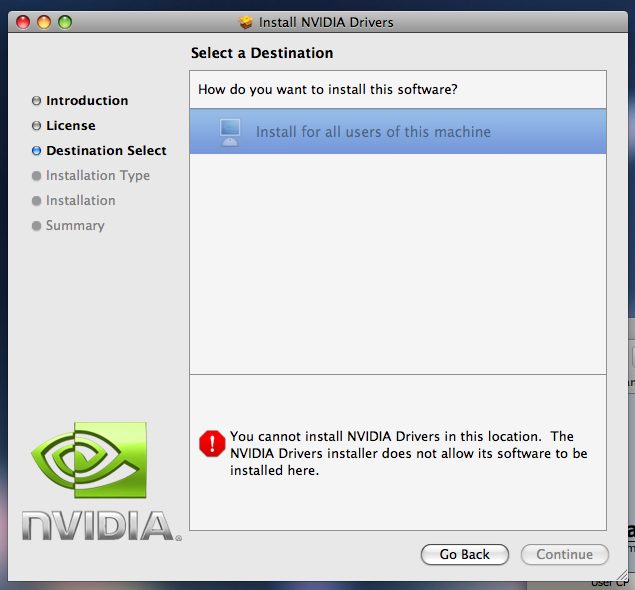

Trying to install the NVIDIA drivers from the 285 (downloaded from EVGA) and I'm getting the following:
[EDIT: Found the problem, can't install straight off a disc, have to drag DMG to desktop before mounting]

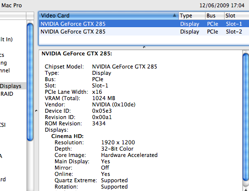

So have had a few hours to play with Mac side, get over initial concerns and compare with the PC card in same machine. Seems that Mac and PC 285 are performing very similarly, provided you get the Mac version running at full speed within a 3D app. Mac seems to have slight edge, but goes into low power mode a bit too readily with current software, and this seems to skew some perf benchmarks. My 08 Pro has not blown up despite running both 285s for 5 hours. Only sys difference is link speed of 2.5 for PC card. So both are up, and netkas' injector for the PC 285 is cooperating with the Mac 285 EFI boot. Just to prove you can have two in a Pro:

How do you power them??Its the only question I have because I want to keep my 8800GT or another gtx285 to drive more than 2 monitors...

Power - to sum up for those several questions.
1. The Mac Pro has indeed got two connectors on board for PCI power. Each 285 needs 2, and I can confirm the Mac version ships with two of the needed cables..
2. To get four in total, right now I am sourcing the second two from an external ATX PSU that is sitting on my case.
3. Prior to yesterday I had an 8800+PC285, and the third supply was being routed from the optical bay. I have not yet tried to see if I can get the extra two from optical, though I think an older post by Cindori said it could be done.
4. I believe you can put a small extra PSU in optical as well, though I did not try that.
