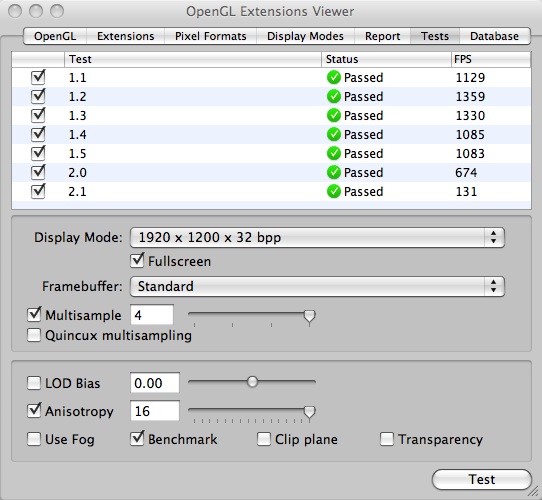

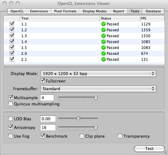

First Mac Vid card with 2Gb of VRAM working !!!
At least I think it is.

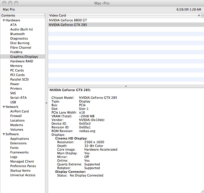

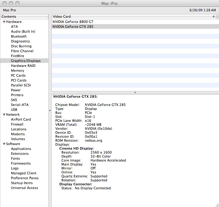

I got ahold of a 2Gig EVGA GTX285. Using the Injector and the card boots right up !!!
The OGL Extension Viewer correctly reports RAM at 2048.........so I tried to fix the amount from Info.plist, per Netkas' instructions.
The card showed up with same amount of VRAM as before !!! I changed 00000020 to 00000008 and rebooted to see 512 Megs still. Even if I got the Endian value messed up, the amount should have changed, yes?
So maybe the VRAM value is coming from somewhere else.

i think the vram value reported by sys info is purely cosmetic and irrelevant, have 2g palit card and sysinfo reports 512k. Cuda finds whole 2G no problem.

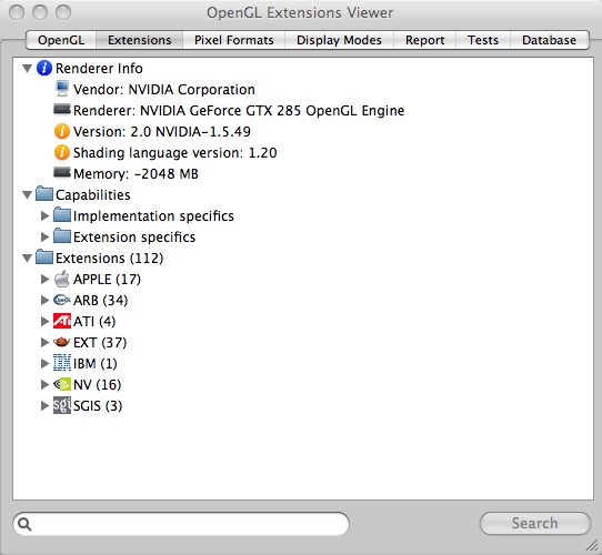

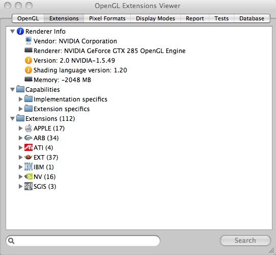

I did finally figure out how to mod Netkas' ATY_INIT to get the 2 gigs to show up.
Interesting that it is actually reporting -2048 (MINUS). Xdarwin, who wrote CoreVidia (new nvdarwin) had same issue with 2G cards. I use his injector under Snow and putting in the 2G setting produced -2G!
That same "-" symbol was already present in the OpenGl Extensions Page.
I too am intrigued what it signifies.
Especially so since one is "cosmetic" and comes from a HEX value in a kext.
And the other is "correct" or read from the card.
Has to be something about how the number itself appears.
looks like apple used int32 type for vram size (signed 32-bit integer range from -2gb to 2gb) and looks like you see type overload
decrease valu by 1 and should works better :)
Apple need to fix it to be unsigned int
