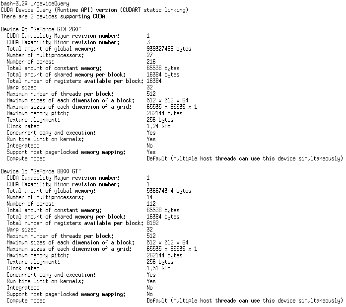

Cuda now working on GTX 260
Seems my earlier problems (Cuda not working despite QE/CI OK and good OpenGL) were a problem Nvidia side. There seem to be two sets of Nvidia Cuda 2.2 drivers around. One is on web (did not work) and other is on Quadro disk. The latter works fine.
So netkas injector has got Cuda alive on twin GPU, as per shot attached. Sorry for suggesting might be something missing in his (her?) injector - the problem was elsewhere.

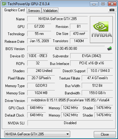

I have attached the GPU-Z output from my GTX285, also shows Vista64 running on my "Unsupported" first Gen.
From my tests, I would say that both Peska and Nasabaer needed some form of Nvidia card in and they may have had success.
