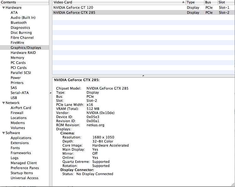

Been lurking and just wanted to let everyone know I was able to get my PC EVGA GTX 285 1 gig card working in my 2009 2x2.26 Mac Pro, using the OEM Mac GT 120 as the "EFI capable" card.
The EVGA card I have is the one that mirrors the stats for the Mac GTX 285.
It is shown here: EVGA 01G-P3-1180-AR GeForce GTX 285
I used Netkas' method and injector. Was getting kernel panics at first, but remembered Netkas mentioning in a previous post that the location of the cards might be important. Switched my cards so the GT120 was in Slot 1, and the GTX 285 in slot 2. Booted up fine after that.
Benchmarks in Xbench and timedemos for L4D under Vista32 show expected improvements. Card is quieter than the XFX ATI 4870 it replaced.
Only issue I noticed is - under OS X the VRAM is being reported as 512MB and not 1024MB in System Profiler. Any idea why this is and how I can fix it?
Run opengl extensions viewer and see real vram size on Extensions tab there
this glitch is purely cosmetic, tho you can fix it by changing VRAM,Totalsize value in nvidia section in Info.plist of ATY_Init.kext (little endian value)

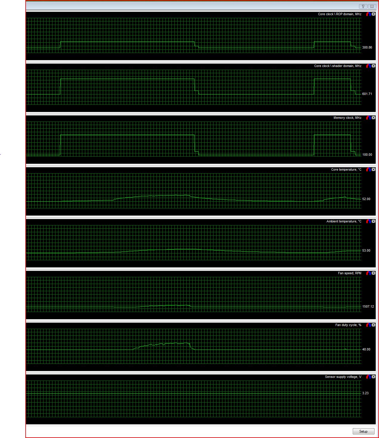

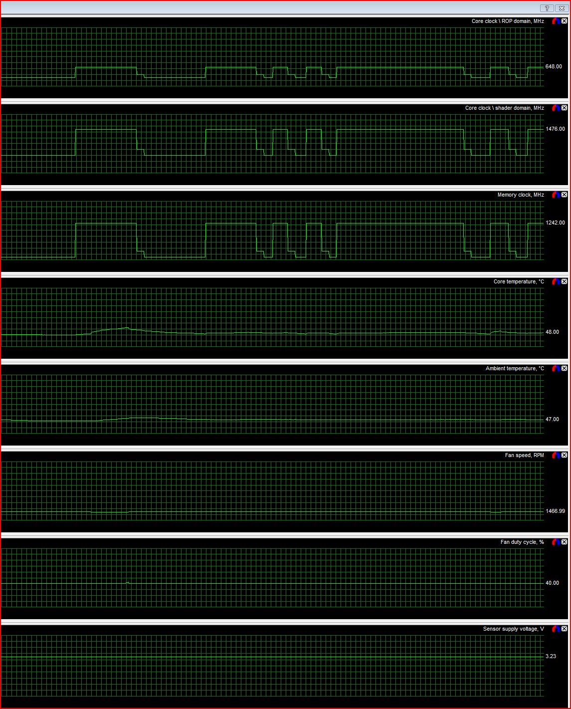

Throttling
Here it is illustrated...but as I pointed out it is nearly invisible in Windows.

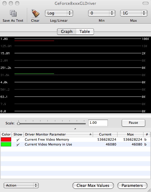

Or another way, to make sure All your VRam is seen and Usable( I say usable, in that when we where working on the Radeon 9100 PCI PPC FCode Rom By JoeVT, it was a 64MB card, at that time, all PCI Radeon cards for the Mac were 32MB, we had trouble using the last 32MB. System would KP if more than 32MB was accessed, all 64MB showed in ASP and such, but you could not use it.)
Anyway, if you have the latest /Developer/Applications/Graphics Tools/OpenGL Driver Monitor.app:
Open it->Monitors Menu->Driver Monitors->Select the Card
When the window opens Click Parameters Radio Button->Current Free Video Memory and Current Video Memory in use.
Now open Safari and Command+N about 100 times as fast as you can, watch OpenGL Driver Monitor.app( Helps to put it on another Screen ).

Instead of clarifying things, this acually makes them more muddy.
In place where I would choose which card, I see 2 @ GeForce8XXXgldriver
Nothing changes when I select one or the other, it seems that using the 8800GT to initialize GTX285 makes them appear as one to certain portions of OS.
Both cards use the /System/Library/Extensions/GeForce8xxxGLDriver.bundle
They did not make a new GeForceGTxxxGLDriver.bundle, they just put the code in the 8xxx one( for the GT120/GT130/GT260 ect.)
0 is one card, 1 is the other, use the steps I outlined above to find out.
I does not matter, at this point, as I do not think that VRam is not working correct, but when someone tries a 2GB card, it maybe useful for them to know< and it is the Correct App to use, that's why APPLE MADE IT.
