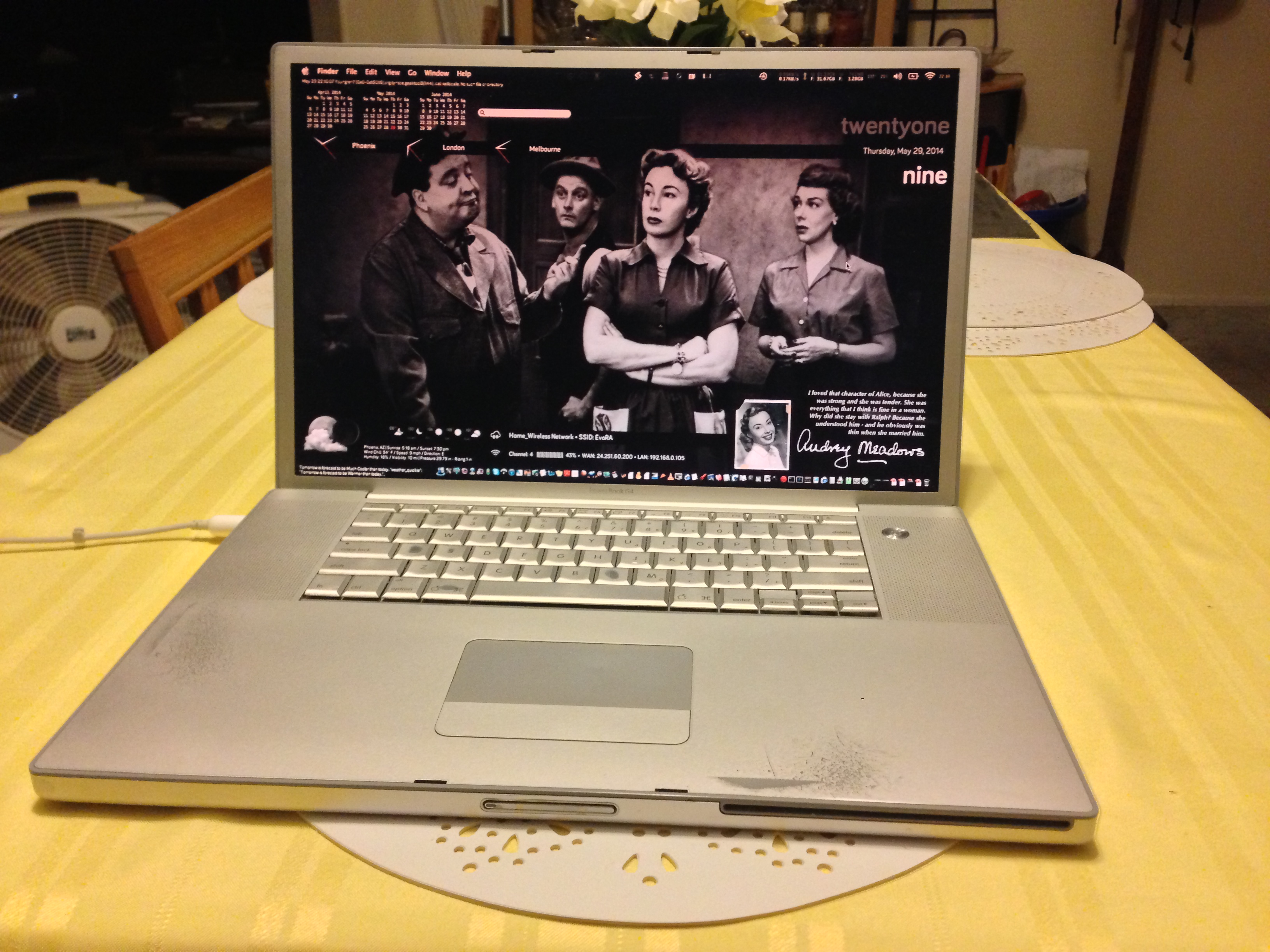

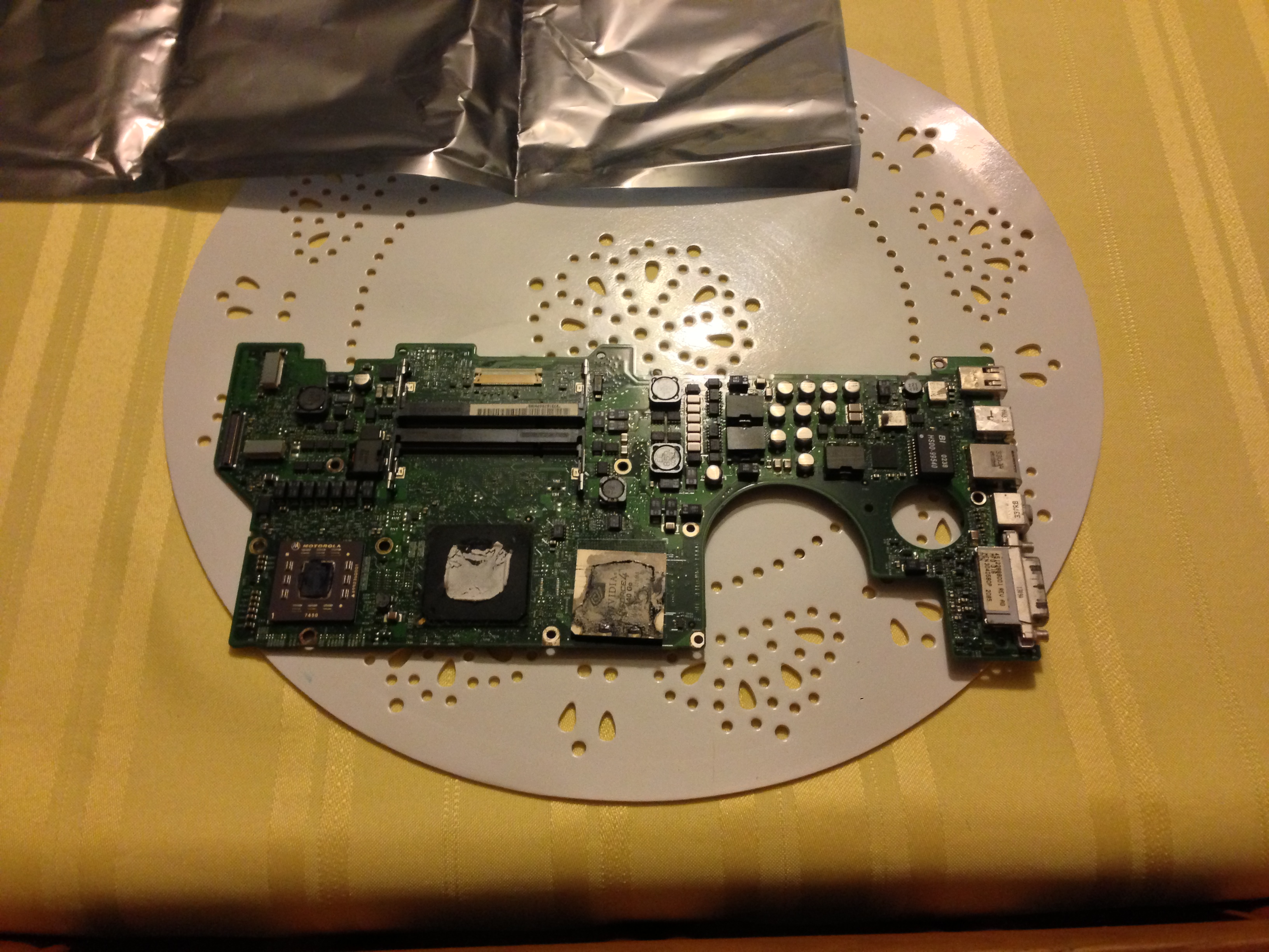

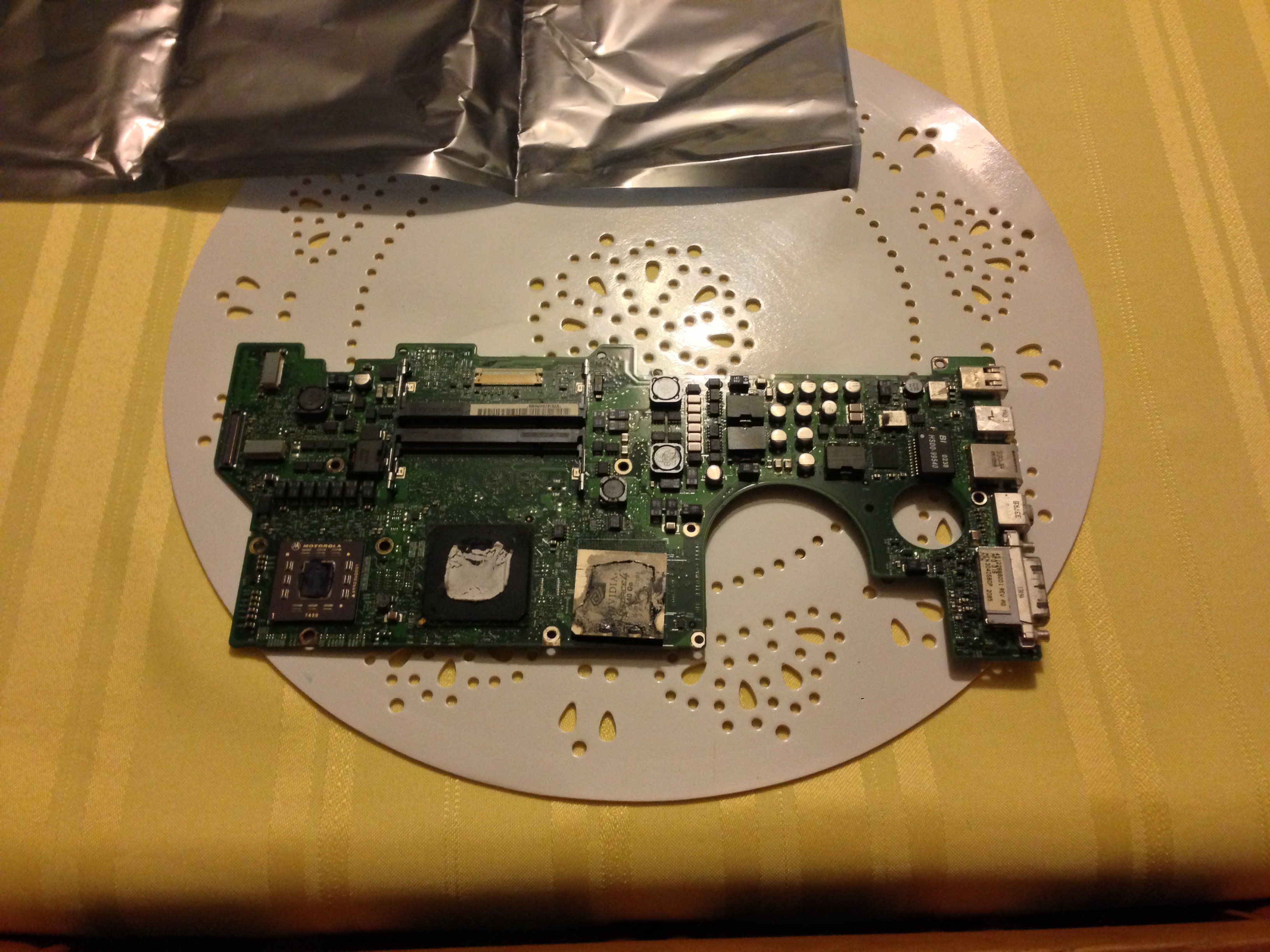

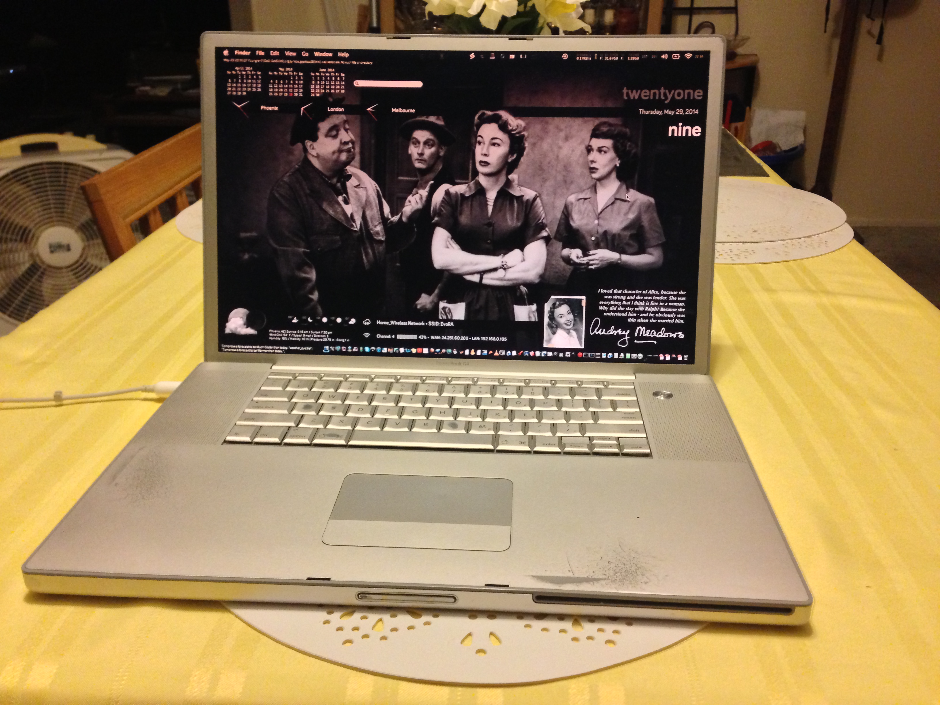

OK, so my 17" 1.0Ghz PowerBook G4 (A1013) is alive! I am typing this on it.
Swap out of the logicboard took about 30 minutes and was even easier than I thought. My only hitch was getting the old logicboard out. Ended up ripping the graphic chip right out of the socket.
Here's the old (dead) logicboard and a pic of the Mac in operation.
Nice to have my old customized Mac back. Now I just need to relearn everything!
Glad to hear you got it running!
Pretty crazy how modified your OS X is running, is it not quicker running stock? Unless in the process of changing it all you strip out the animations and everything else that is a RAM hog.
Love it, really want to get a 17'' Powerbook for my studio i'm building in a month or two, they make great ProTools rigs.
Me too!
I was sure I had put everything back together right, but you never know if that's true until you press the power button. That chime is the best thing to hear.
Well, it's just a combination of things really. AquaDock's ML theme, plus an icon pack, plus BlackMac OS X (a CandyBar theme) and a dock I picked up from deviant art.
On my desktop I use a combination of GeekTool and Yahoo Widgets (which still work).
The OS itself has just had the standard customization. Animations disbled, Spotlight disabled, etc. Most of that stuff was because my Mac had a failed external cache with the old logicboard. In any case, I suppose you are right. But I've been working with this Mac since late 2009, always trying to improve it. It does run faster than stock, but only because of the tweaks I've made here and there. Again, all standard stuff.
Technically, you could say it's not the original Mac. Except for a few parts and the case, about 75% of it is not the parts I got in 2009.
But, just like Altemose took offense at iBook G3s being referred to as useless, I took offense at the seller's statement in 2009 that this Mac was on it's last legs. Personal crusade to keep it running I guess. By now, I've paid more than double in replacement parts than it cost me to get it originally! 😀

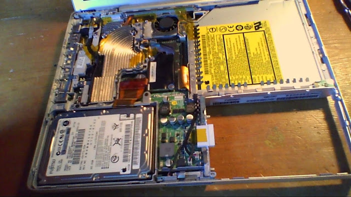

When I ripped the graphic chip off the logicboard it was stuck to the heatsink. So, this is where a hair dryer came in handy!
Fortunately, I had a good amount of Arctic Silver and cleaning compound left from when I redid the QS CPUs. The 17" was surprising. The CPU, video card and one other chip are actually upside down and flat against this hollow metal bar. There are three squares where the chips meet the bar and the bar has holes in it that allow the hot air to escape.
Quite a different design then the heatsink I dealt with on my wife's 12" PB. I've never been inside a 15" Albook, so I don't know if it's like the 12 or 17". In any case, a neat design and very simple on the 17.
It was fun learning, I can say that.

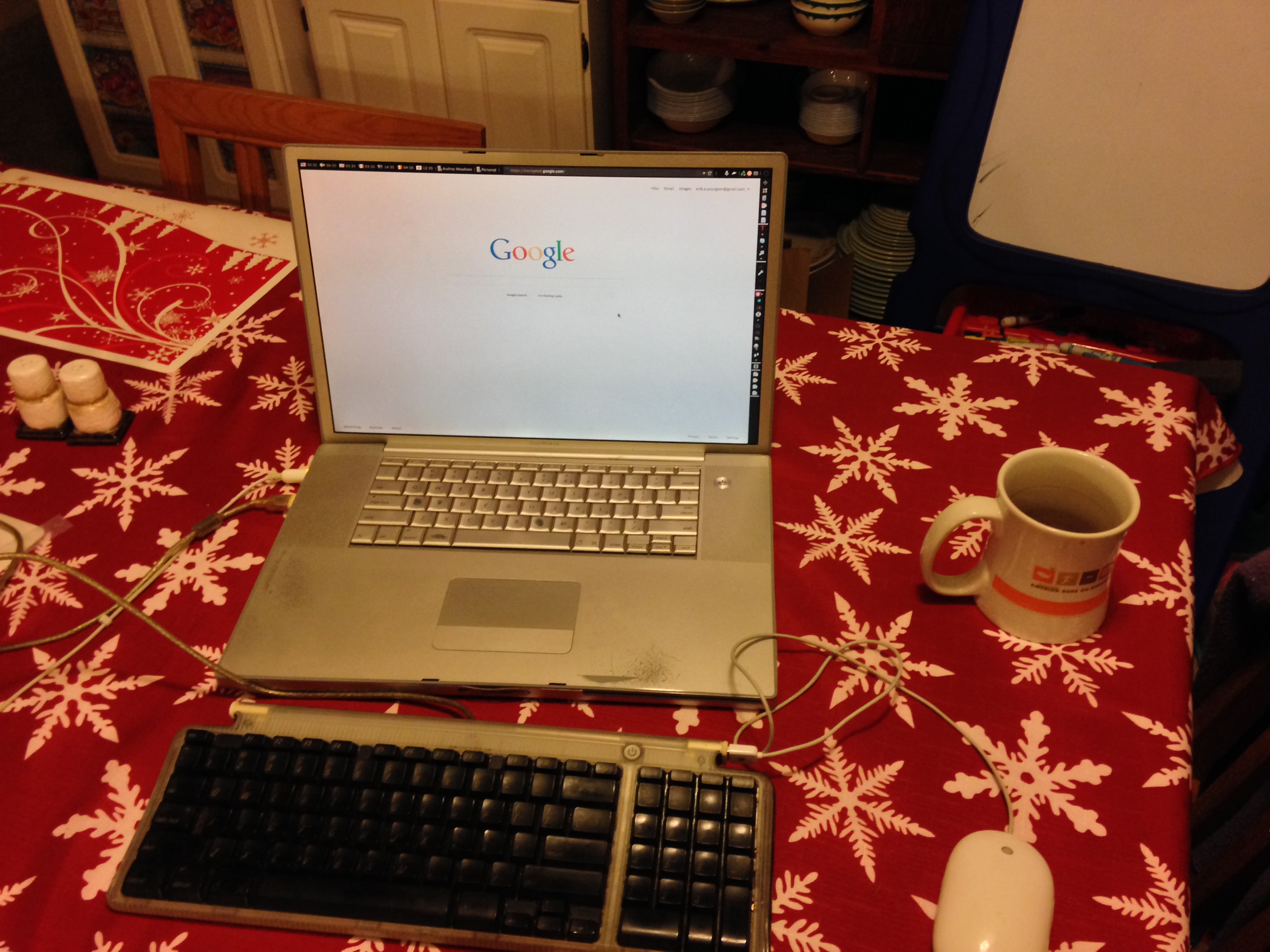

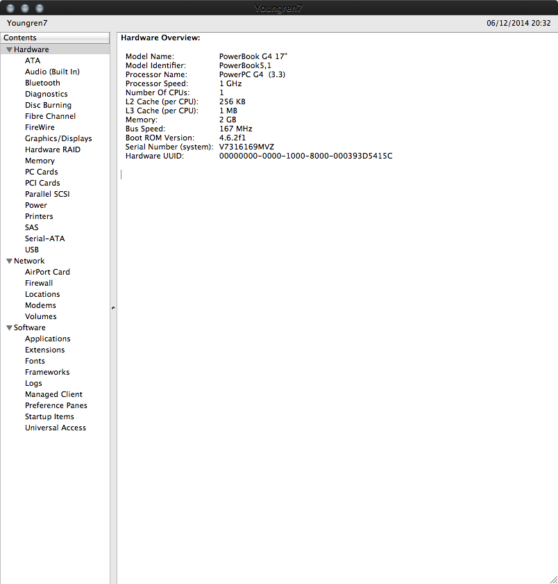

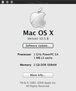

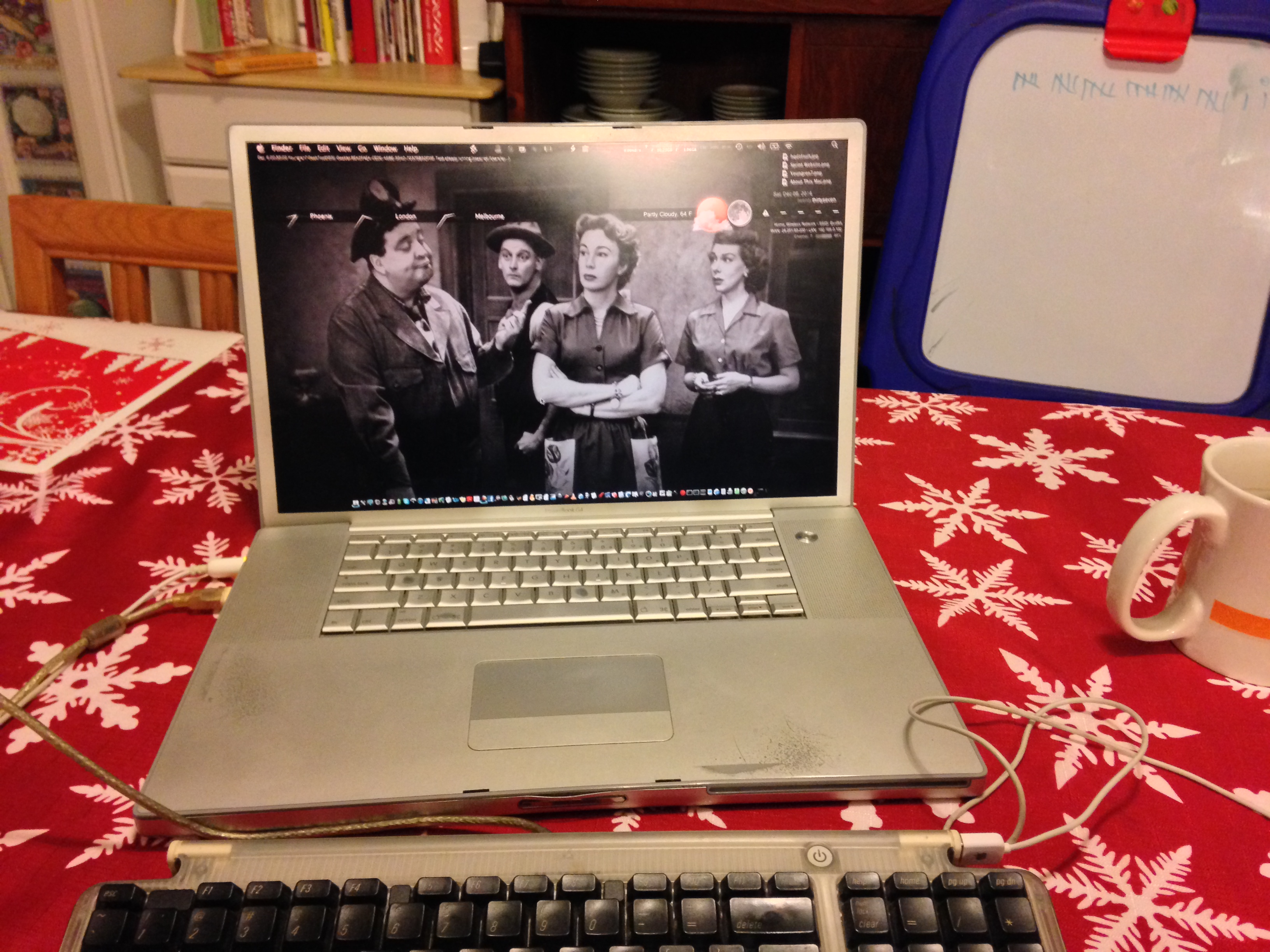

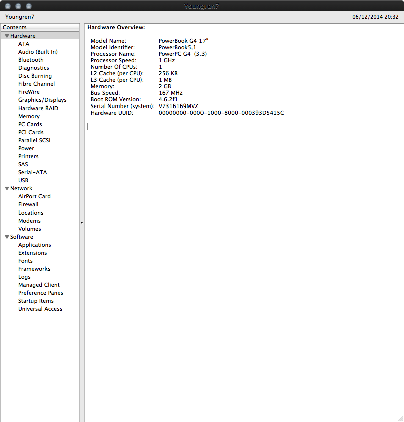

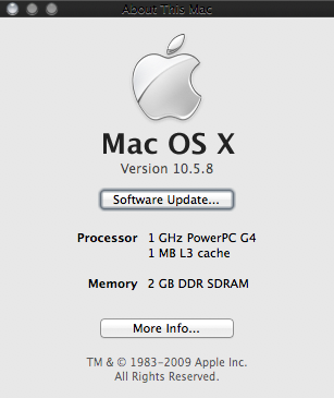

Well…
I checked the mailbox at 3:30pm today and the Mac was here. Got it home, and powered it on. Came right up but because of no hard drive and a cracked screen nothing was happening.
So, I decided this would become a LCD replacement.
The new Mac was missing screws and after replacing the LCD and putting my HD in I discovered that there are a few screws I cannot put back in. The bottom of the Mac seems to be bowed so that it's difficult to close the lid.
Not a big deal for me right now, but because the Mac is old, guess what happens? The trackpad connector comes off the logicboard!
After grabbing a spare keyboard and futzing I got it to boot so I'm guessing this was an issue already. I will see if I can work with it. But the Mac is alive – again. Although I guess I can't really call it the "same" Mac now.
I seem to have cache now though, which is cool! For the moment though I will be operating with a keyboard and mouse.

Well…
Not bad! That top case has a fair share of wear showing this Mac has been loved for years! Good job on the repairs!
LOL! Actually, that's my top case! The one hat came with the unit was beat to hell and had missing keys so I used my old one.
Going to mess with this thing tomorrow and see if I can't get the trackpad to work again.
