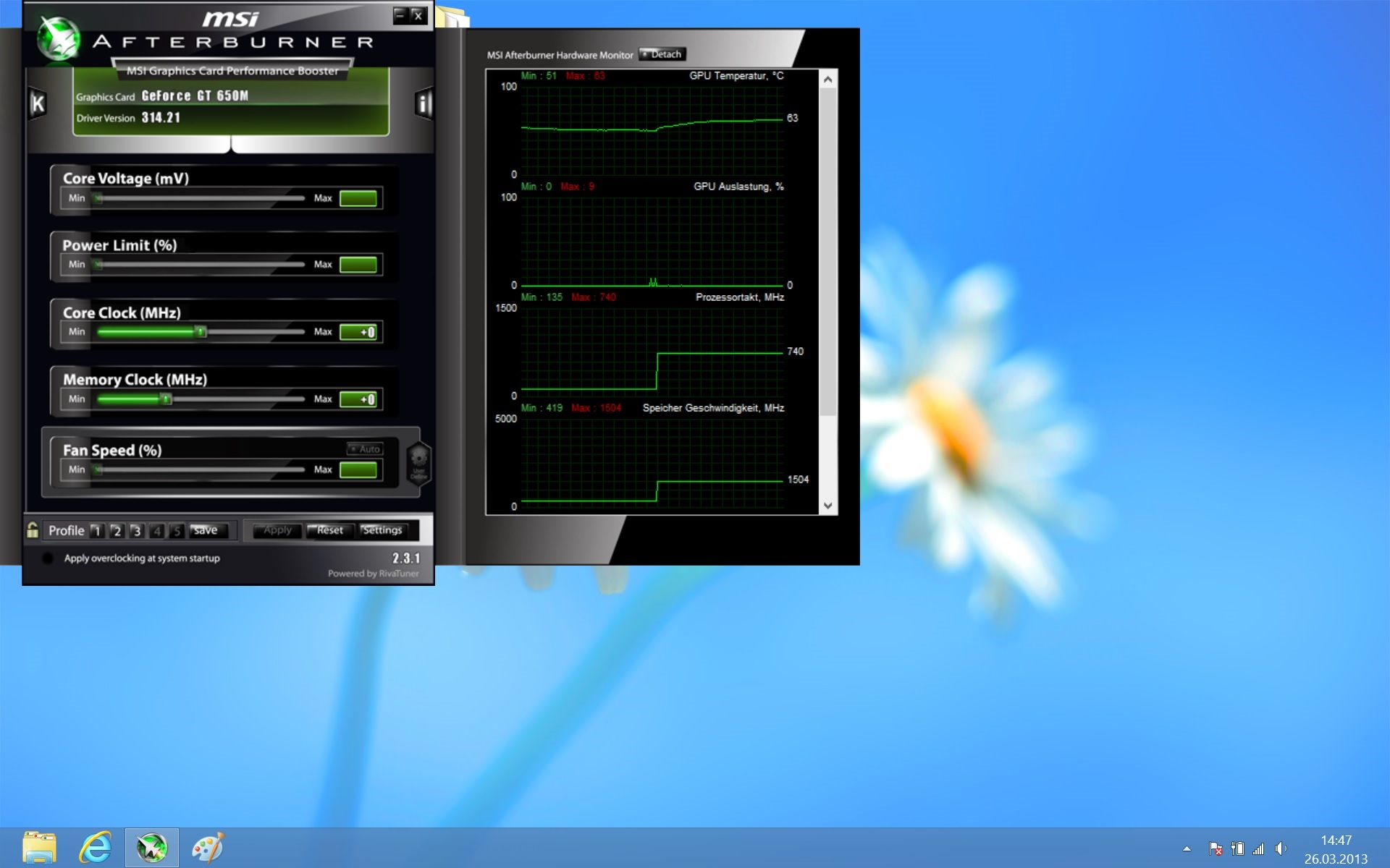

After several Days i've found a way to stop the throttling of GPU Power under heavy load (for example while Gaming) in Bootcamp.
Under normal conditions the GPU rund unter 135 MHZ Core Clock and 419 Memmory Clock.
While Gaming it reaches normally 725 up to 900 Mhz Core Clock and 2000 up to 2508 MHz Memmory Clock. But if the MacBook Pro Retina gets to Hot (80 Degrees) it throttels down the GPU massively to 200 Mhz Core Clock and what causes the micro lagging (stuttering) while Gaming .. FPS is during the throttling normal at 25 to 40 FPS. With the new SMC 1.1 Update Apple has change some things and the throttling does not happen so often as it does before.
You can see on the picture that everything was fine until the Temp reaches arround 80 degress. Then the GPU beginns throttling.
... So i have found a solution to tell the GPU **** and stay at the Clock that i want ^^

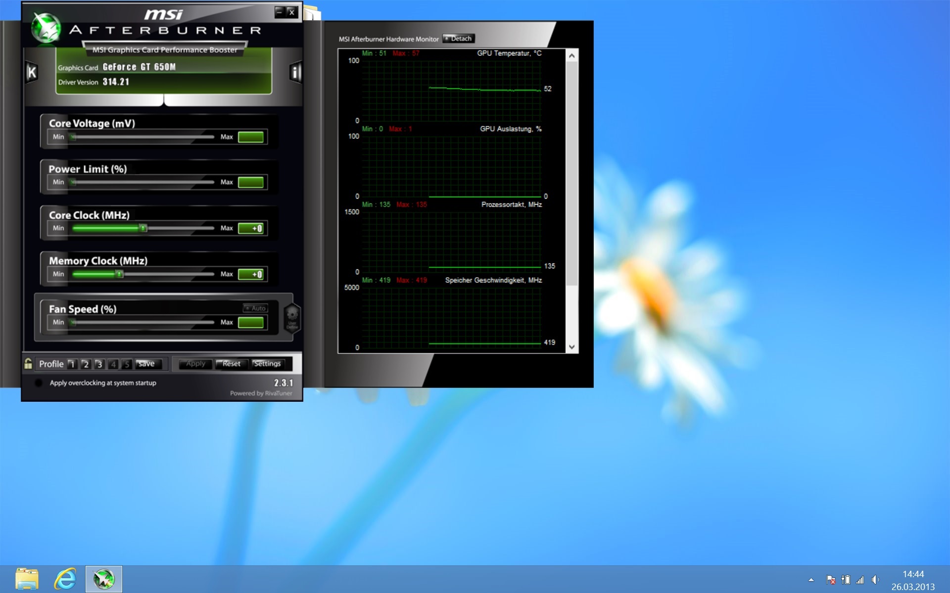

Here is a picture how this looks like when the MBPR is in normal state.
and here a picture while i was gaming and the throttling startet and i executed the even created shortcut. After a couple of seconds GPU has stopped throttling.

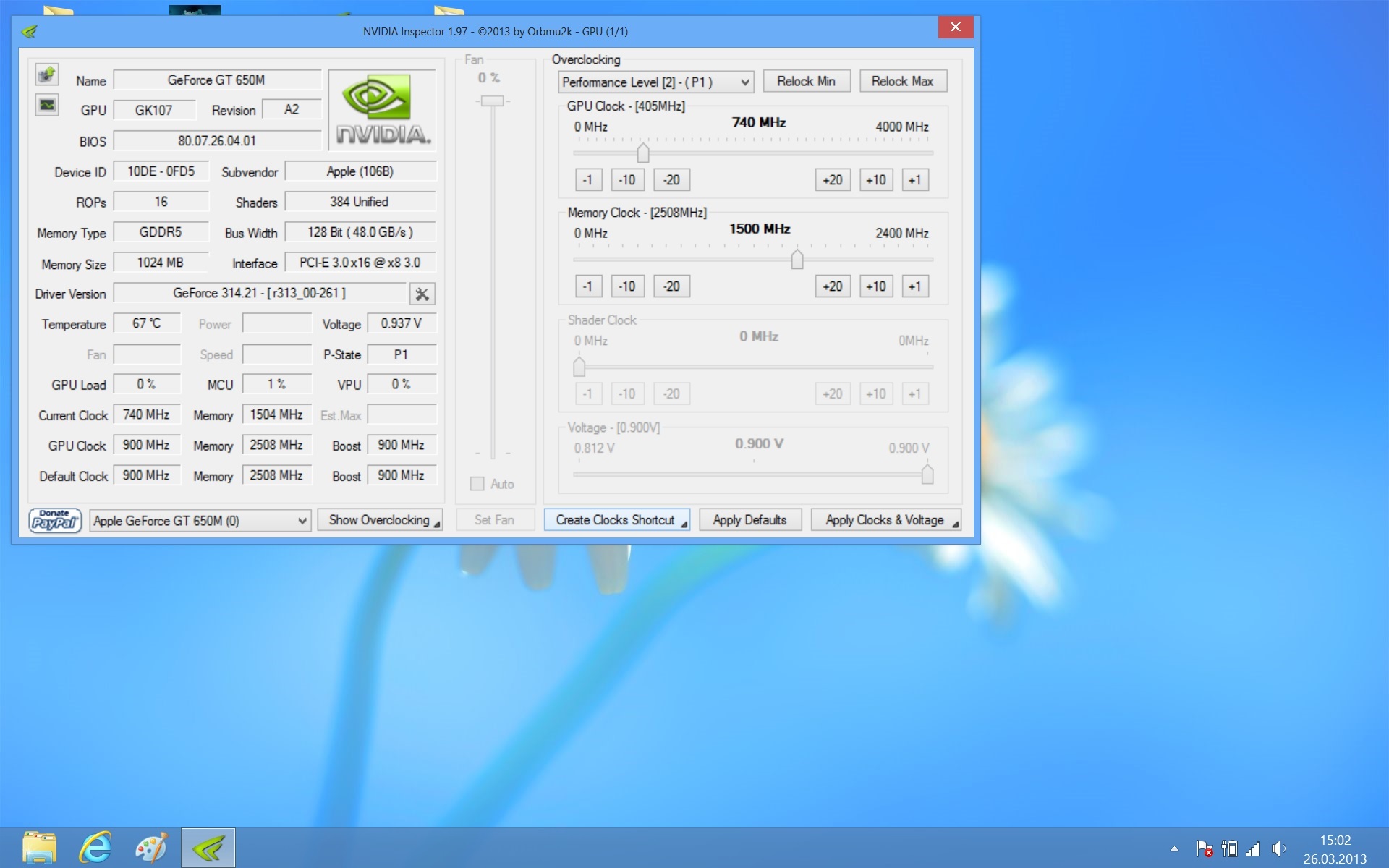

and here a picture of nvidia inspector.

1.download and unpack nvidia inspector (you dont need to do any setup in nvidiainspector ... just the shortcut).
2. create a shortcut of nvidiaInspector.exe
3. right click on the shortcut and open properties.
4. under "target" add right after the filepath the following text (without the text in quote)
5. thats all. ... just doubleclick on the shortcut and let the magic begin.
"C:\Users\Desktop\Tools\nvidiaInspector.exe" -forcePState:0,1 -setGpuClock:0,0,135 -setMemoryClock:0,0,135 -setGpuClock:0,1,405 -setMemoryClock:0,1,405 -setGpuClock:0,2,740 -setMemoryClock:0,2,1500
it should look like on this picture
