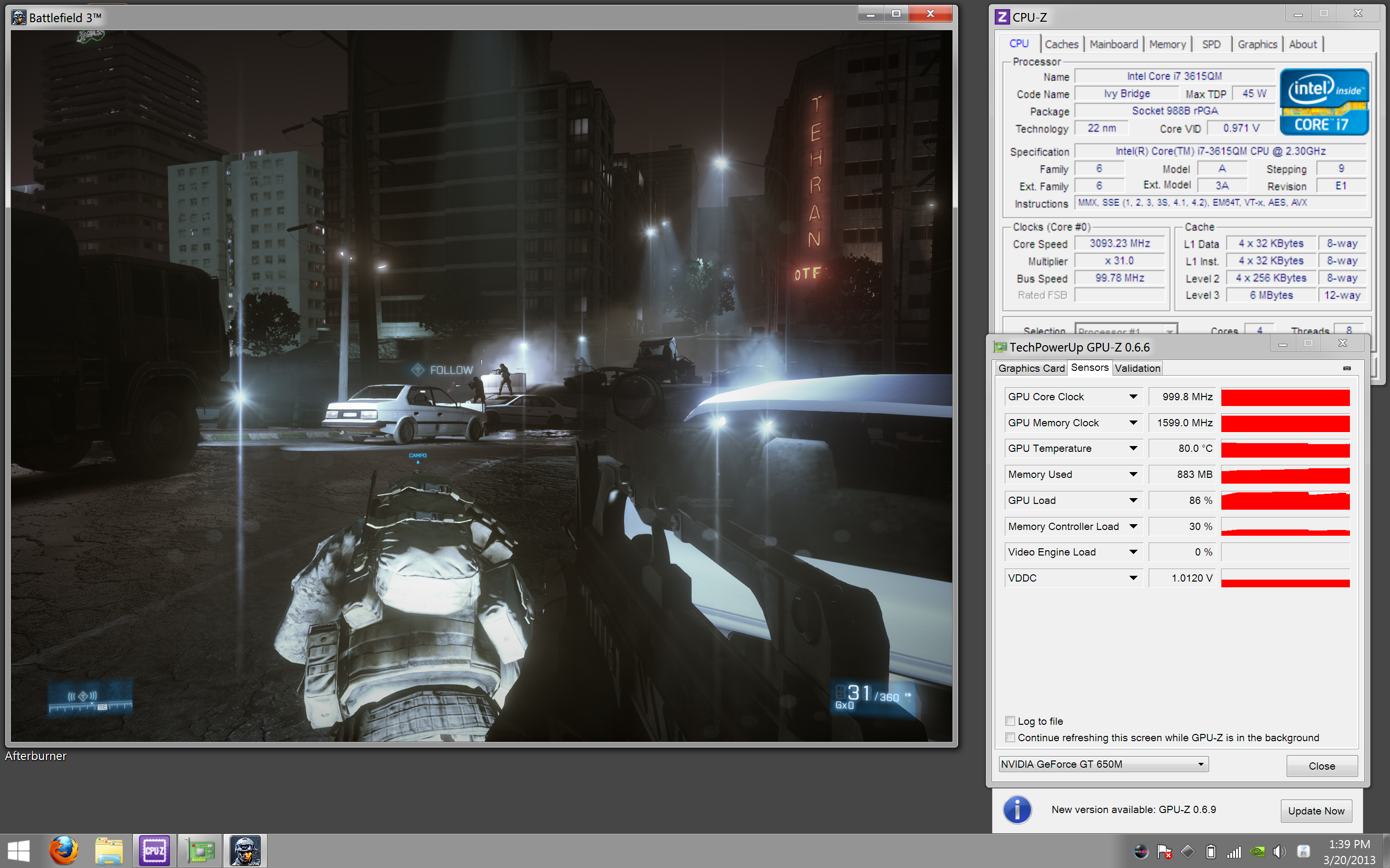

And I'm not having temperature or performance issue. To top it all off, I'm even overclocking my rMBP...
Edit:
Here's a screenshot so you know what to expect:
It may be because ambient temperature here is so low (~15C), but I also have a really hard time reaching past 85C even under full load.
