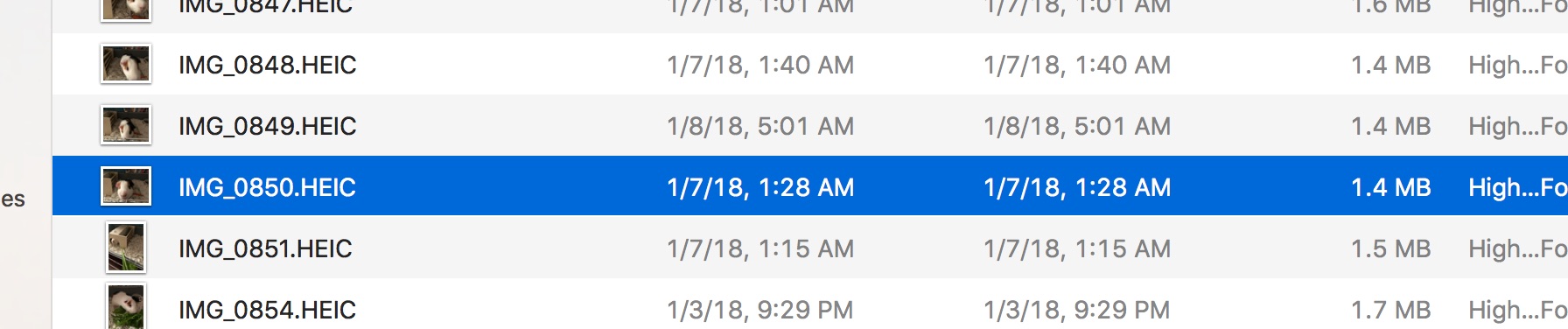

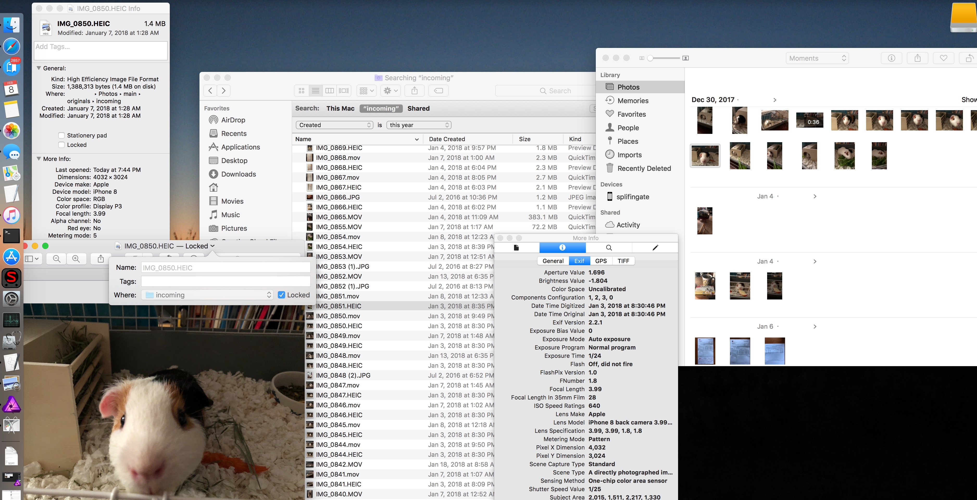

Nope, you are wrong. Finder has got a "Created date" search term that search in the file metadata for the created date, and a "Created" that search for the file creation date. I just tried to export a image from Photos (so the file creation date is today) set the "Created date" search term to the image taken date (4 December 2017) and it worked.
ah!, yes; awesome!; you are correct, Ritsuka, that Finder does allow one to ⌘F, select Created/Created date, change the "is" to a specific date-range, and sort files further, based-upon. I have previously tried similar, to no desirable effect.
