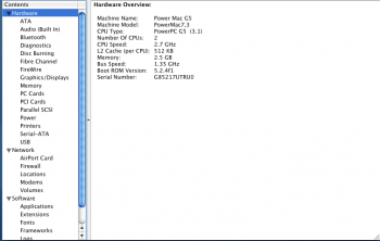

My G5 received a breath of fresh air with a OSX Tiger install.

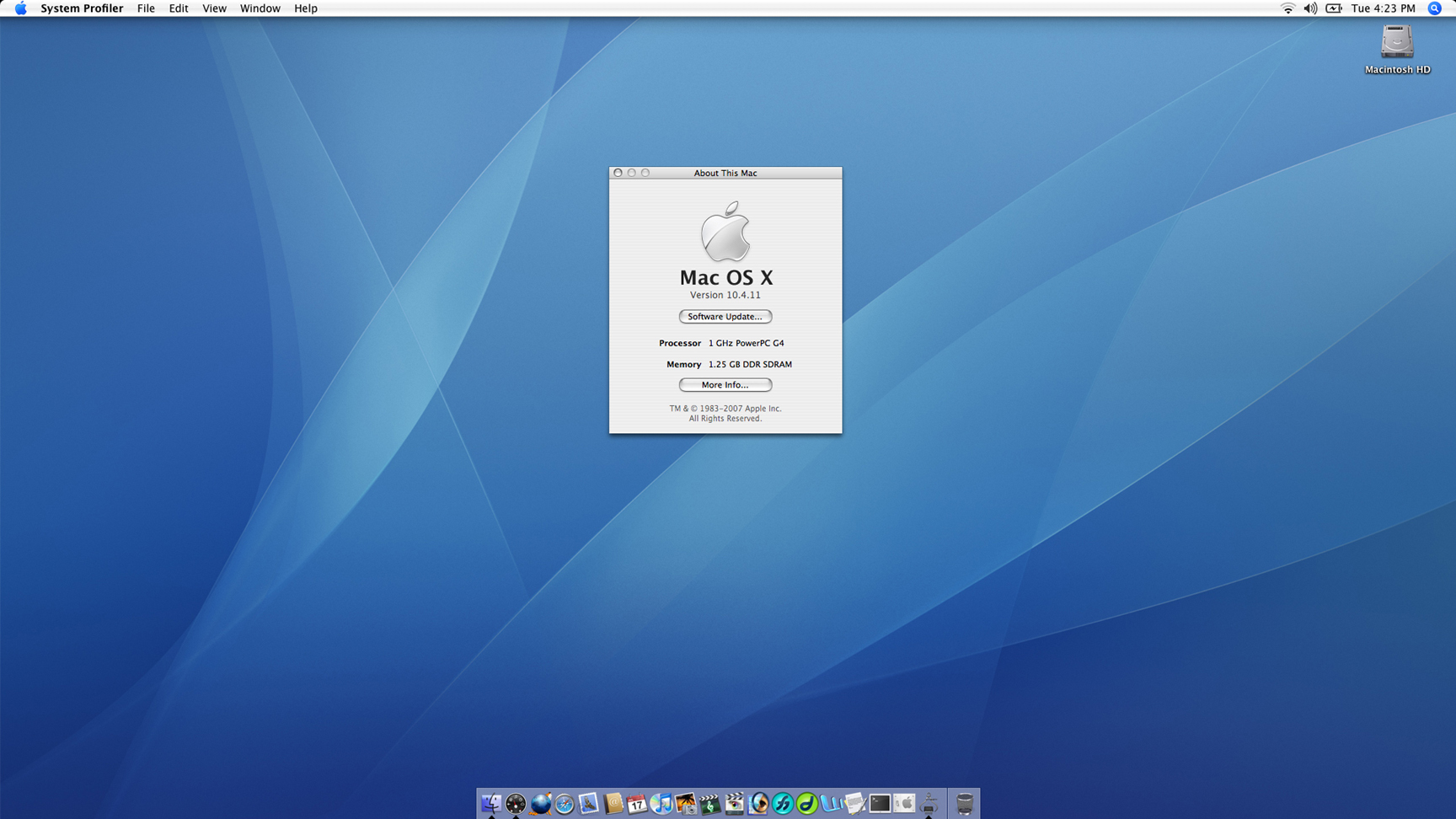

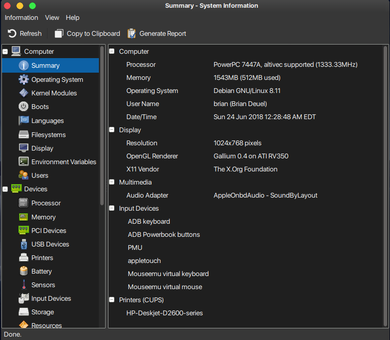

Is it the one with the radeon 9200 gpu @swamprock ? If so does Debian support this gpu? I have the same iBook
Radeon 9550, the last 12" iBook released. I downgraded the mesa drivers to gain 3d acceleration, per PPC Luddite's guidelines. I find that this iBook is in somewhat of a sweet spot for low-resource linux- once the usual PowerPC linux issues are bypassed (video drivers, sound, wifi), it runs very well.
You're limited to Debian Jessie (Stretch and beyond have no PPC support), but you can install the later kernel (install linux-base from Jessie-Backports first). I want to try Lubuntu and MATE, but I've gotten this iBook to a state where I'm super-happy with it and don't want to nuke the install just yet.
Oh... stick with webkit browsers. Midori is the best one that I've found. Firefox-ESR (56) just crashes and is very buggy. YouTube video is via HookTube and VLC, so no in-browser video (not a deal-breaker for me). I'm exploring other browser options...
Yeah debian is a great Linux distro. Wheezy works great on my MDD. If you get every hardware piece working it is really fast, the only thing which makes you regret OS X is the lack of softwares. So no gpu support for the Radeon 9200 :( sooner or later I'll try it, maybe there's a workaround

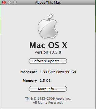

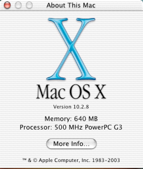

one of my ibooks only machine of mine that runs leopard

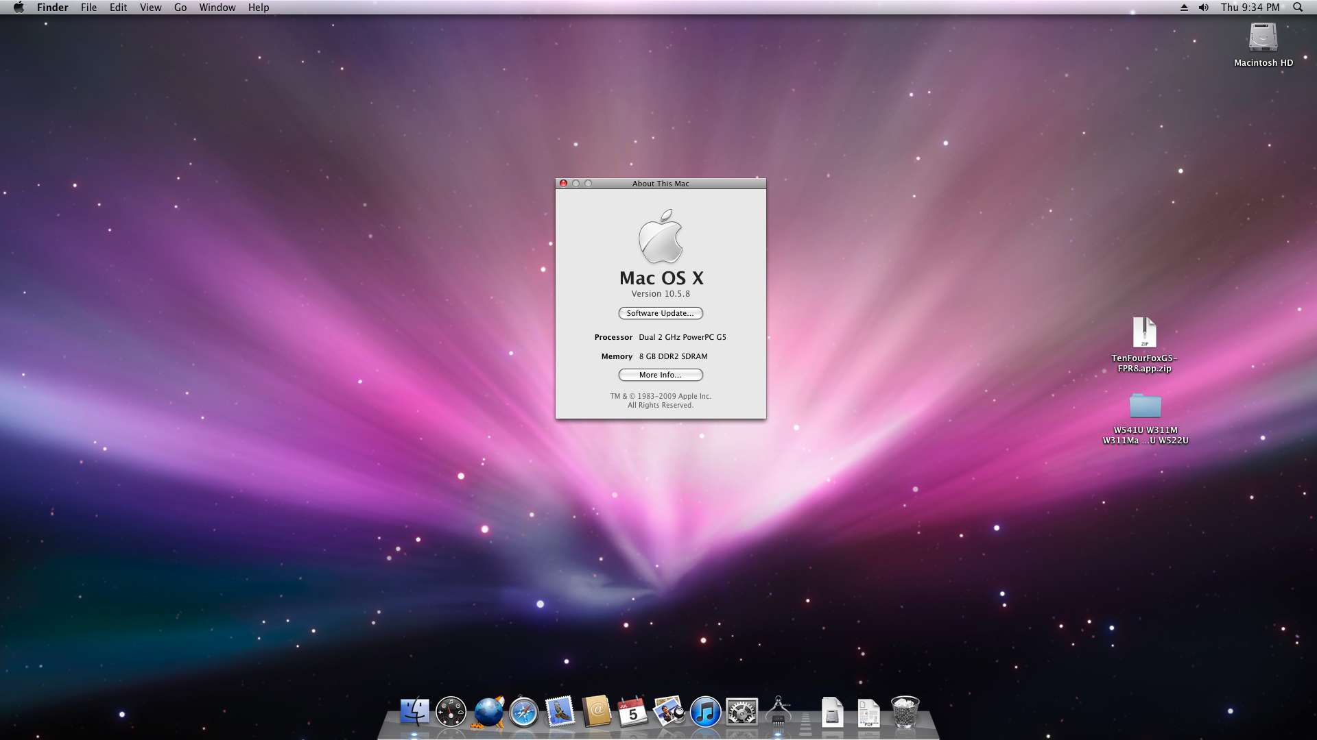

You're right! The C19 cord arrived today and I was able to boot her up. I am typing this now on the G5 (using TFF FPR8 G5 browser) and it's not bad at all. Youtube at 360p is fine, too. And, 720p is playeable with just tiny amounts of missed/skipped frames
It's almost like the difference between Dusk and Night... not quite night and day... but it's serviceable... useable...
The only thing I need to do is see if I can make this Tenda W311M USB Wifi Adapter to work... because right now, I am tethered to my iMac via ethernet cable and using Internet Sharing. Any ideas for that?
