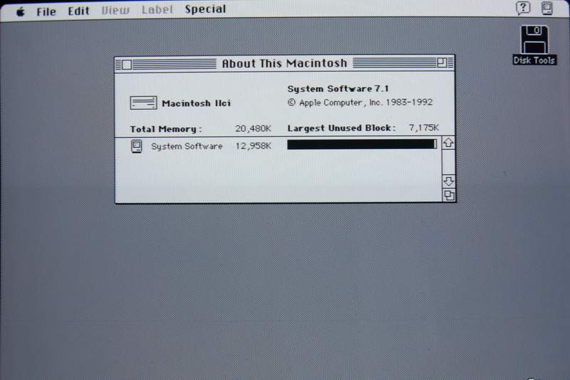

Here is a screenshot of my recent acquisition.

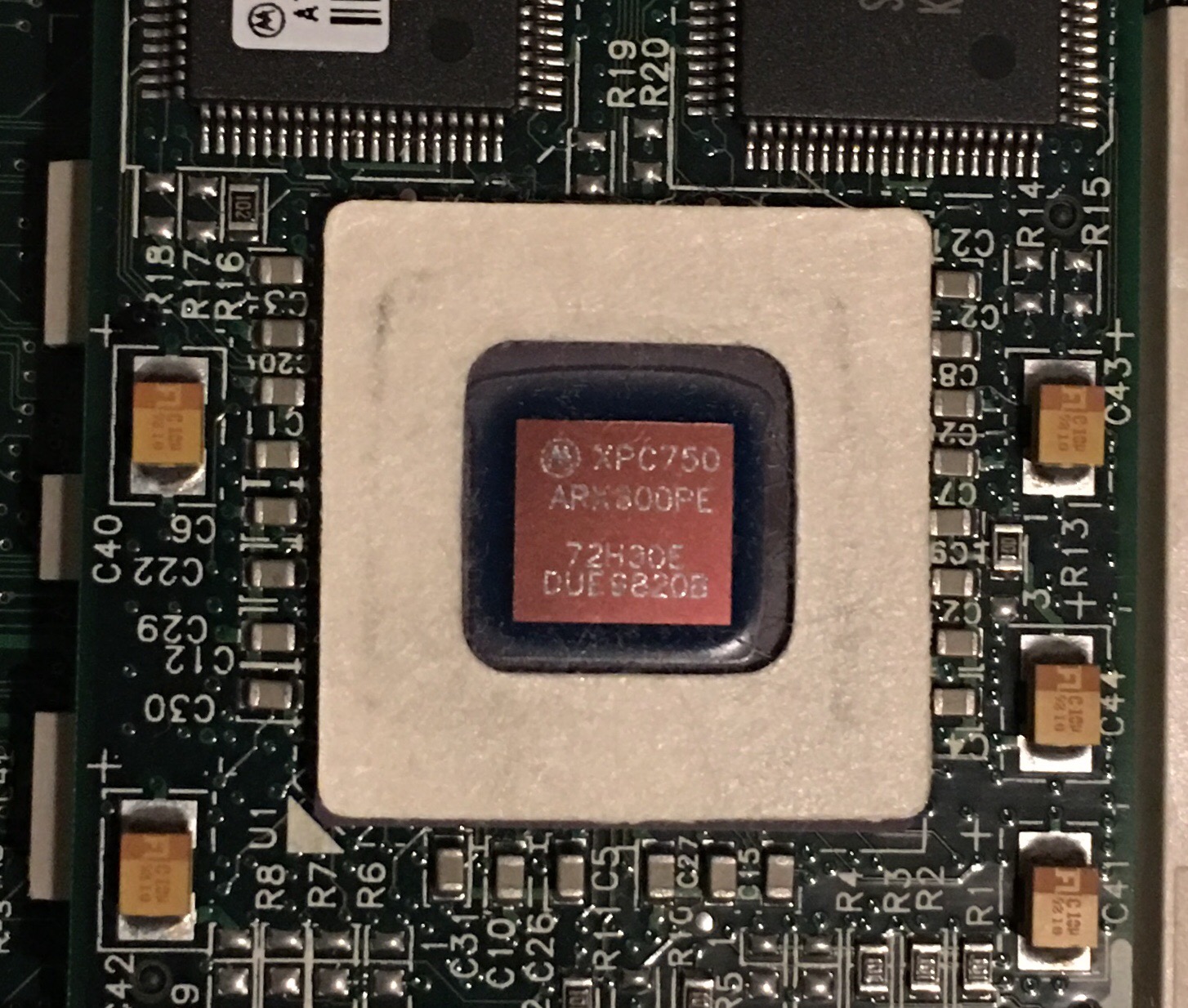

very interesting :) looks Apple did have a 300Mhz 750A done for them... (does anyone own a 333Mhz G3 beige they can photograph the CPU from? since those where only sold later on i wonder what CPU they have as well)
its also worth noting the Core voltage is set to 2.7V on this ZIF. (the MPC750A PDF says 2.6V is the nominal core voltage) sadly I cant find any data sheet outlining any special MPC/XPC750A parts on the NXP website.
Thanks for the photo :) (CPU was made 20th week 1998 if im reading that right)

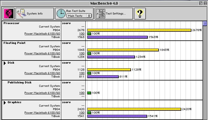

With regard to this, I managed to get a hold of Macbench 4.0 and Cinebench 2003. The latter refused to run on the TiBook and Macbench 5.0, which would be a much better fit, only does a few I/O and CPU tests until someone can dig up the full CD version so I only have these results for what they are worth. I had to run the tests from the CD as it would not detect the graphics test files from the HD (presumably as it is expecting a SCSI drive, given the age of MacBench 4.0). Even so, there is a pretty stark difference.
Reactions: Dronecatcher
thats quite a impressive gap, I know the 1Ghz AlBook has a 167Mhz Bus where as the 1Ghz TiBook has a 133Mhz bus :)
it is worth mentioning. that the 867/1Ghz TiBooks if they dont have a 65W charger and a working battery will clock the CPU down to 667Mhz and disable the L3 cache so its worth making sure you have those 2 things sorted/working otherwise you can end up with a System thats slower then expected (I figured this out when trawling through the Dev documents for the TiBook as @Gamer9430 had a 1Ghz TiBook that was running abnormally slow, once he got a proper charger and battery setup it ran much faster :) )

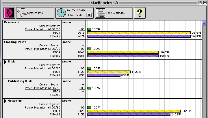

Aha. I took the battery out of the TiBook temporarily. I thought something didn’t smell right with those results and it couldn’t be down to the bus. I shall rerun.
I am using the same charger on both.
[doublepost=1522273190][/doublepost]And things are a lot closer as might be expected. Just the expected difference in i/O metrics due to hardware improvements.

ah yes that looks much better, as you say the bus speed diffrent would not of made that much of a difference hence why I mentioned the 667Mhz Battery/charger thing :) (its one of those obscure facts that can make a big difference :) )
I suppose the AluBook wins because of a larger, nicer screen, better cooling hence less fan noise and FW800 under OSX if that matters to someone, otherwise it is more of a wash.
Coincidentally, I installed G4FanControl on the AluBook only to discover that it has no detectable temp sensors. Let's hope Apple's thermal settings are sufficient to prevent overheating.
