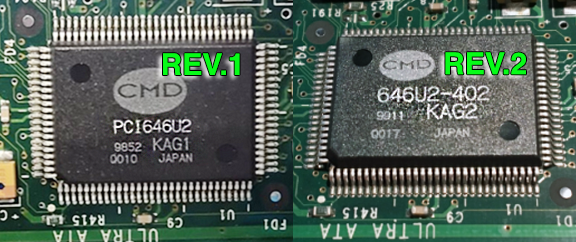

“Finnicky” is definitely correct and may even be an understatement. Especially if you have the Rev.1 board with the PCI646U2 CMD chip.
AND if you’ve installed OS X 10.2 without dual-partitioning your HD, keeping Mac OS 8.5.1 separate on its’ own partition (with OS X on another) ESPECIALLY with the Rev.1 board… yes you will have problems. I recently upgraded 3 B&Ws here to Rev.2 boards and with dual-partitioned HDs (plus SSD with the Rev.2). I’ve had no problems whatsoever since.

I would assume you actually have a Rev1 running 8.5.1. The rev 2 shipped with 8.6. But I would still verify which one you have. The only reason I asked if the drives were original is because sometimes previous owners have not always had things setup properly. And Being a B&W that can cause a lot of problems.
