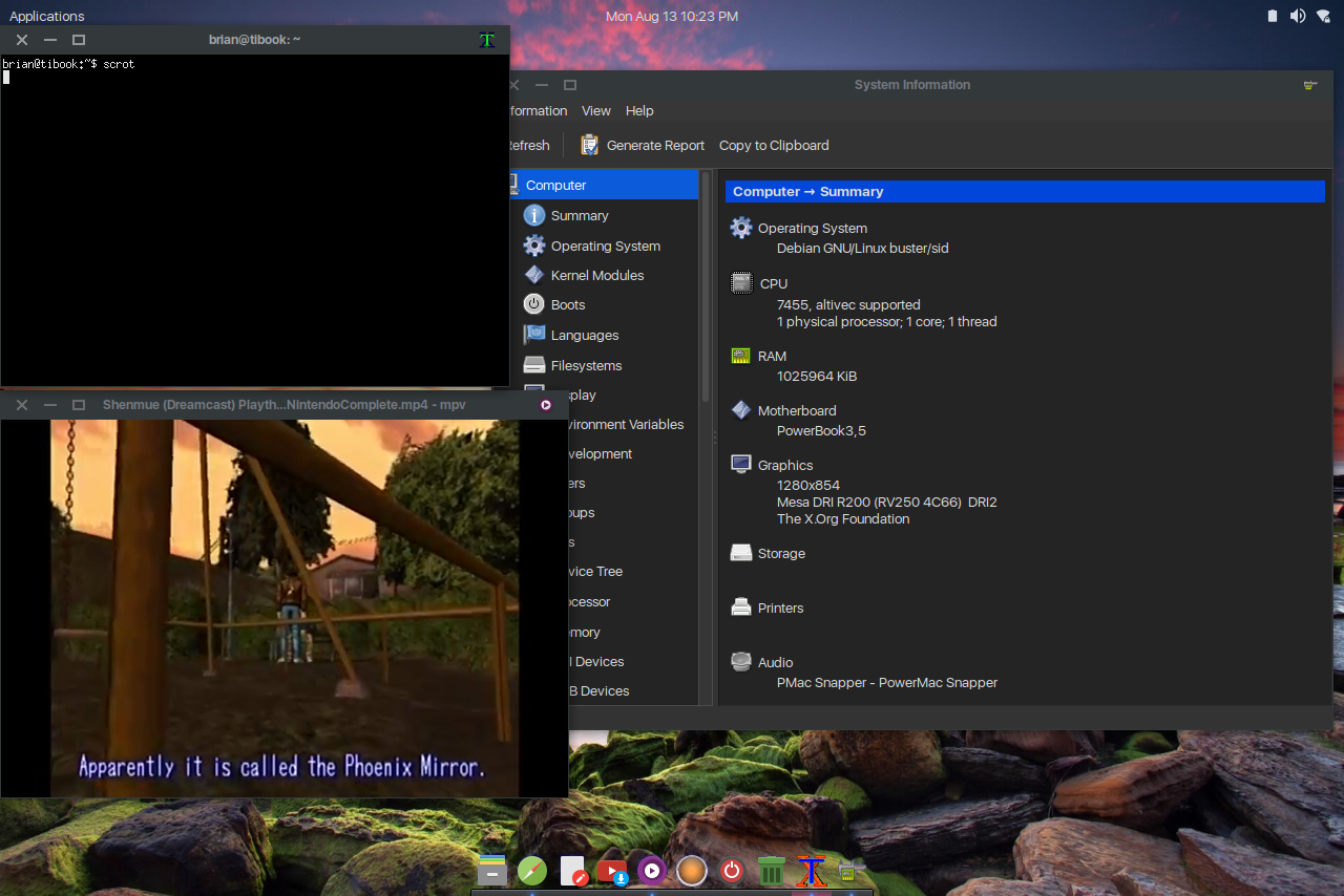

867mhz TiBook tested. Everything installed the same as my iBook (and other installs). No real difference between this install and other working installs that I've done, with the exception of the older trackpad (so, no gestures). Performance seems on par with my 1.33ghz iBook; most likely due to the L3 cache. Full speed 360p video via mpv, with about 60% CPU utilization. The orb next to the power symbol on the dock (which is Plank) is a CPU usage meter widget that changes size and color as more and more CPU is used. In the second screenshot, you can see that it's yellow, and I'm running mpv, hardinfo, xterm, and Midori. Checking the usage before taking the screenshot, we're at about 67% with these items running. Not too shabby for an old TiBook.

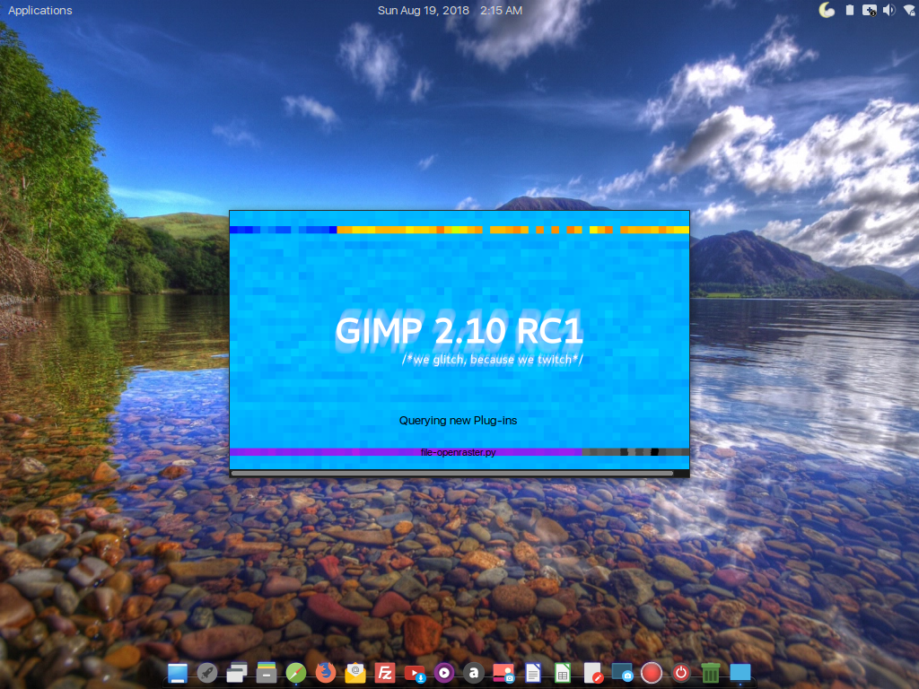

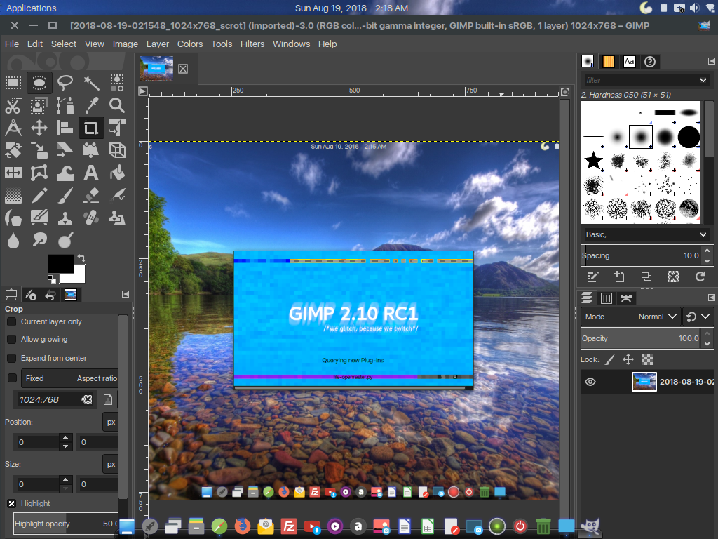

Screenshots. I themed this very similar to my iBook...

60 fps. Hardware acceleration works great once firmware-linux-non-free is installed. Agp mode is still unstable, so radeon.agpmode=-1 still has to be appended to keep things from crashing, but there's no longer a need to downgrade mesa.

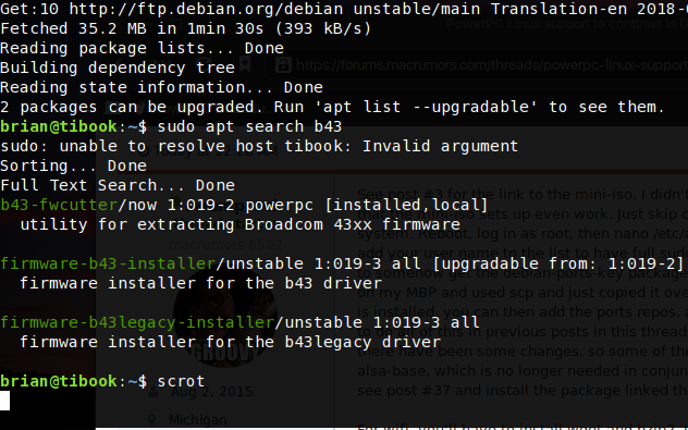

For wifi, you'll have to install wget and bzip2, then (once again) download and copy over b43-fwcutter and firmware-b43-installer and install them using dkpg. You can always wget the debs from your install if you can find a link to them. This picture shows why you need to grab the older versions of these packages (the Jessie builds work just fine):
(I need to add 'tibook' to my new hosts file to fix the error above. Oops.)
As you can see, the package versions are different, so there will be dependancy issues if you try to install the broadcom drivers from unstable.

Gimp is completely borked in sid, but I managed to compile the latest RC from source. It runs fine, if a bit slow, but Gimp was always slow on PowerPC-
