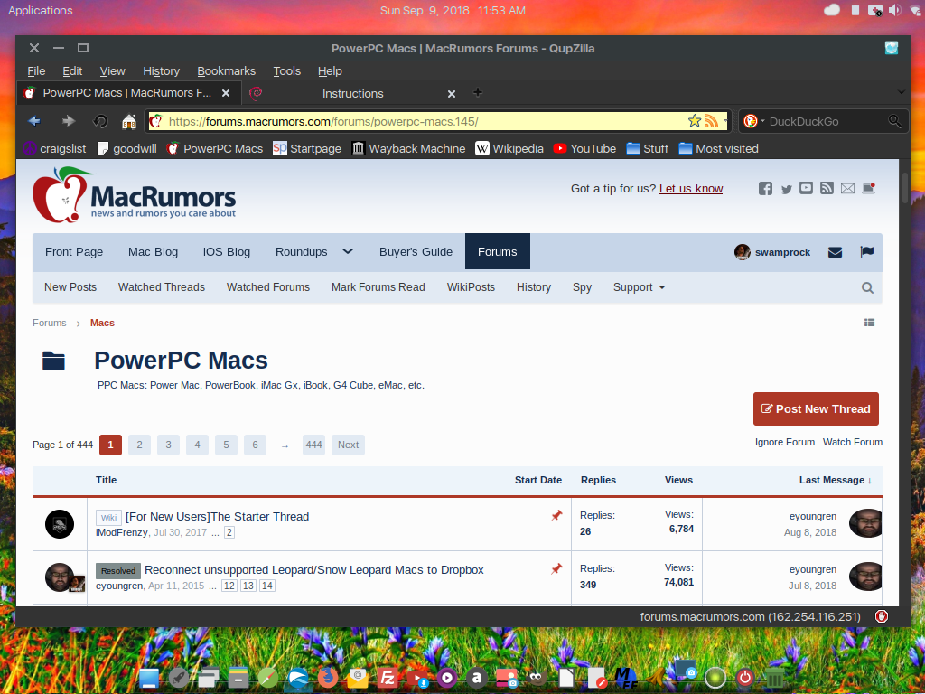

For usable web browsers, there are a couple of things that can be done. For Qupzilla, the Jessie repo can be added to sources.list and installed from there ("deb http://ftp.debian.org/debian jessie main") with no issues. Midori can be installed from Jessie Backports ("deb http://ftp.debian.org/debian jessie-backports main"). I added both repos and disabled the sid repos, then did apt update, and installed both browsers. I then reversed the process, disabling the older repos and re-enabling the sid repos, with no issues.
Granted, both browsers are older and out of date, but are the most stable that I could find for sid, until the rust compiler gets fixed for PowerPC (hence why Firefox isn't able to be built for PPC). Just don't do any online banking...

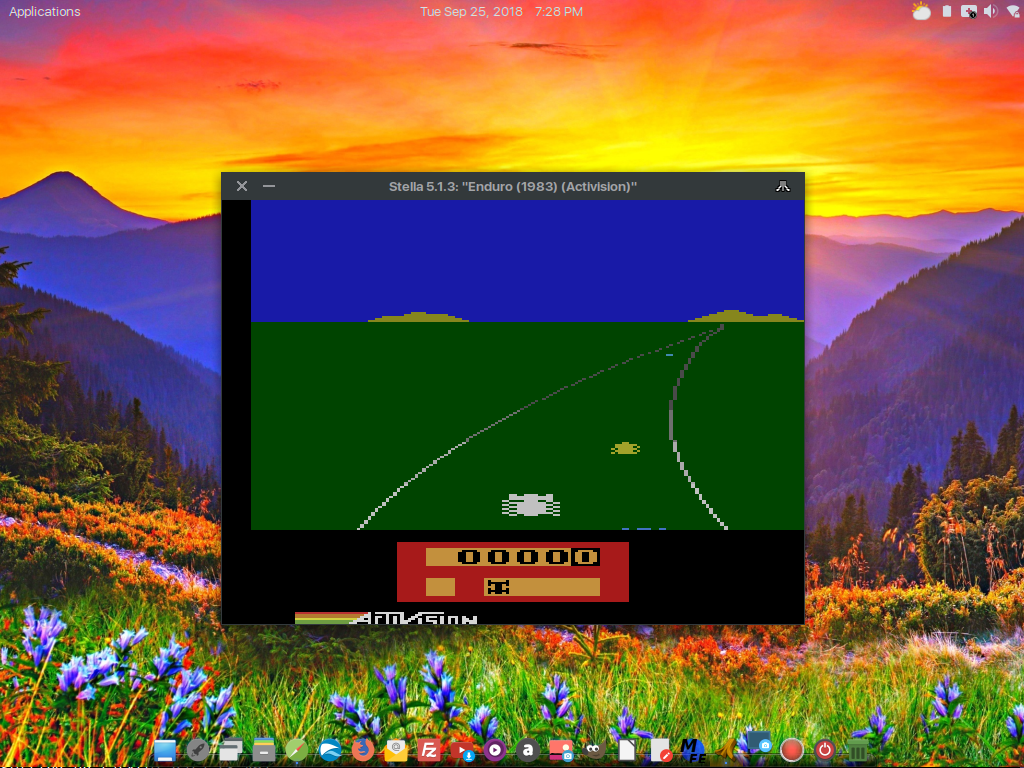

I tested a few video game emulators, and found Mednafen and Stella quite usable. Everything runs at full speed in Stella on my 1.33ghz iBook G4, and most of the systems supported by Mednafen run at full speed. Genesis and SNES emulation needed a bit of frameskip, but were definitely playable. Mednafen supports Gameboy, Gameboy Advance, SNES, Sega Genesis/Megadrive, Playstation (I didn't test this one), Atari Lynx, Sega Master System, and a few others. Both emulators (and Mednaffe, which is an essential frontend for Mednafen) are available in sid. Here's a shot of Stella running on my iBook:
I'm sure that there are other emulators available (computer, etc.), but I went with those that I knew would run at a decent clip on an old iBook. I haven't tried MAME yet, but may do so soon.
