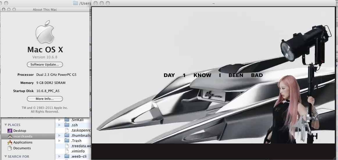

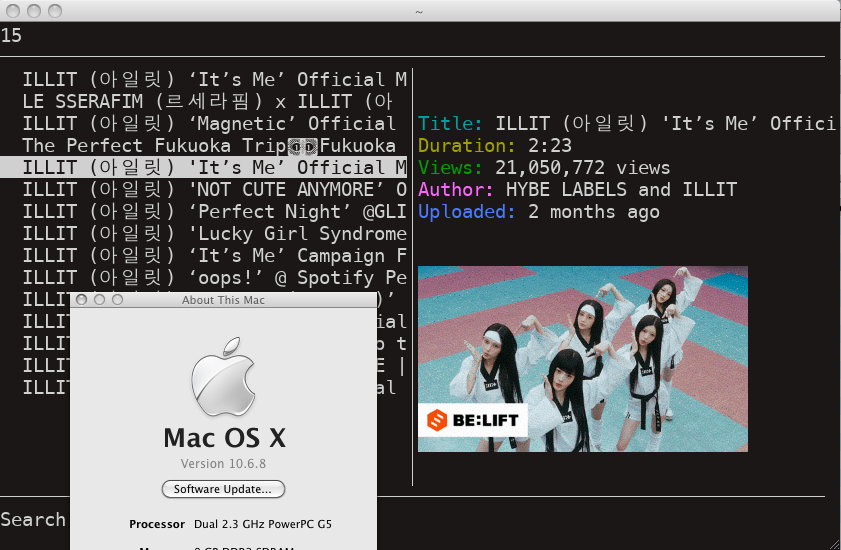

New terminal, proper images and video support
