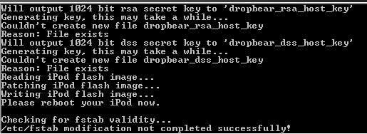

Ok ive posted everywhere about my problem and no luck so far so here it goes.
When i run touchfree.exe and it asks me to reboot for the first time and i do then come back and hit enter i get an error see attachement:

I'm still getting the problem when I start up touchfree.exe that the dropbear dss key or whatever could not be generated. It said "Reason: exists". I've tried running touchfree as administrator like one person said to do but it still doesn't work. Any tips? Thanks
