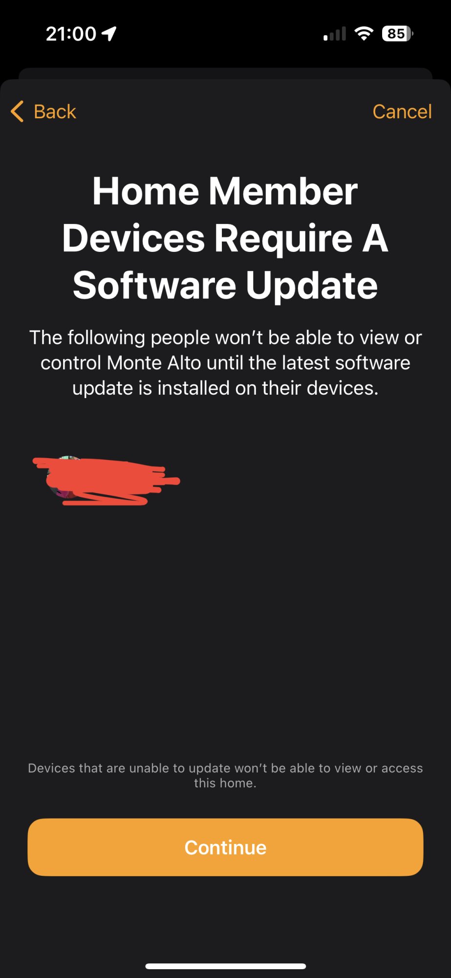

All our home devices are on 16.4 yet it claims my wife is not.
I’ve triple checked everything and it’s all updated. Any clues how to resolve this? (It doesn’t inspire much confidence to upgrade…add to the fact I will no longer be able to manage my mother in laws home remotely until I update hers too).

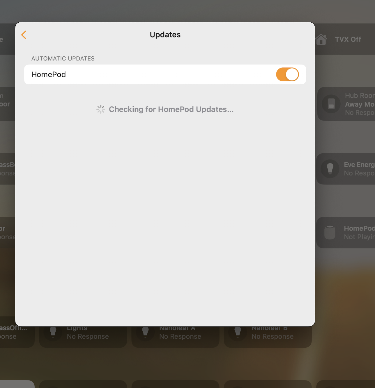

Here's my current experience⬇️. Every device (iPhone, iPad, Mac) all updated but all unable to update the HomePod.

The frustrating thing is that in my experience, the new architecture is a massive improvement over the old - so much quicker responses, no 'lost' requests or feedback... but I still can't share my Home with the rest of my family, even though they're all running devices on 16.4
If you updated the architecture in 16.2 and your still having this problem I have bad news for you. You will likely have to clear all your home settings and set up a new home....from scratch. That's the only way I got invites to work after 16.2.
I was able to upgrade before they pulled it last time. With that said, I’m still dealing with an inability to add people to my home. Invites just don’t go out. Very frustrating.
Some things of note as also identified previously in this string. If you use HomeKit within a family for things to work just right, everyone must be on 16.4. If you have teenagers that can’t update or not use their phone for 30 minutes, they can’t honestly take advantage of the new architecture. In my home for example, my 2 teenagers still show as pending invitation for my Schlage homekey smart lock they were previously using every day. (I also show 3 guest codes for some reason)

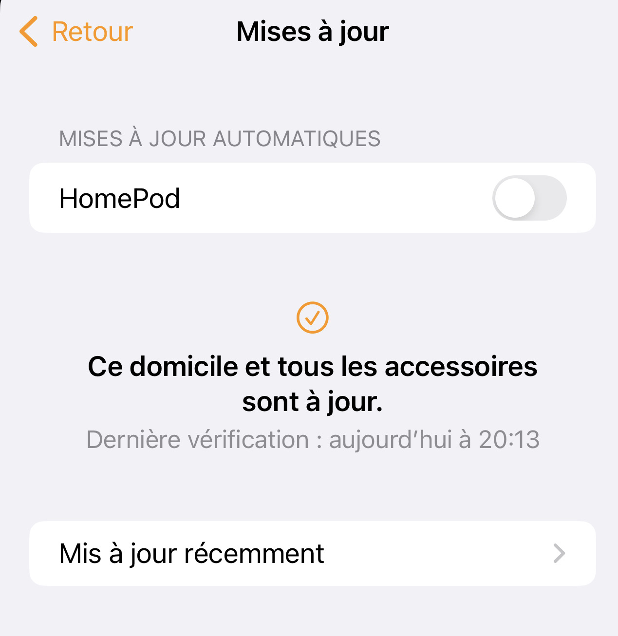

I don't understand why I don't get the upgrade option... I didn't upgrade before and my iPhone, iPad, AppleTV and Homepods Mini are now all on version 16.4 , but still no upgrade option in the Home app....
It doesn't show when you go into the settings? Click (···) then Home Settings / Software Update ?
No, when I go to the Software Update section, I get the message "Checking for updates for the HomePod...." and after a few seconds it displays "This home and all accessories are up to date".
Are you using IPv6? Who knows what's correlated with what, but on a guess I switch off IPv6 on my router and HomePod update started working correctly!
At this point nothing would surprise me, including that the HomePod update server is somehow misconfigured for IPv6 so that devices that want to update kinda sort think it's available by IPv6 (eg valid DNS record), but can't actually download from it (invalid IPv6 config on the server)...
