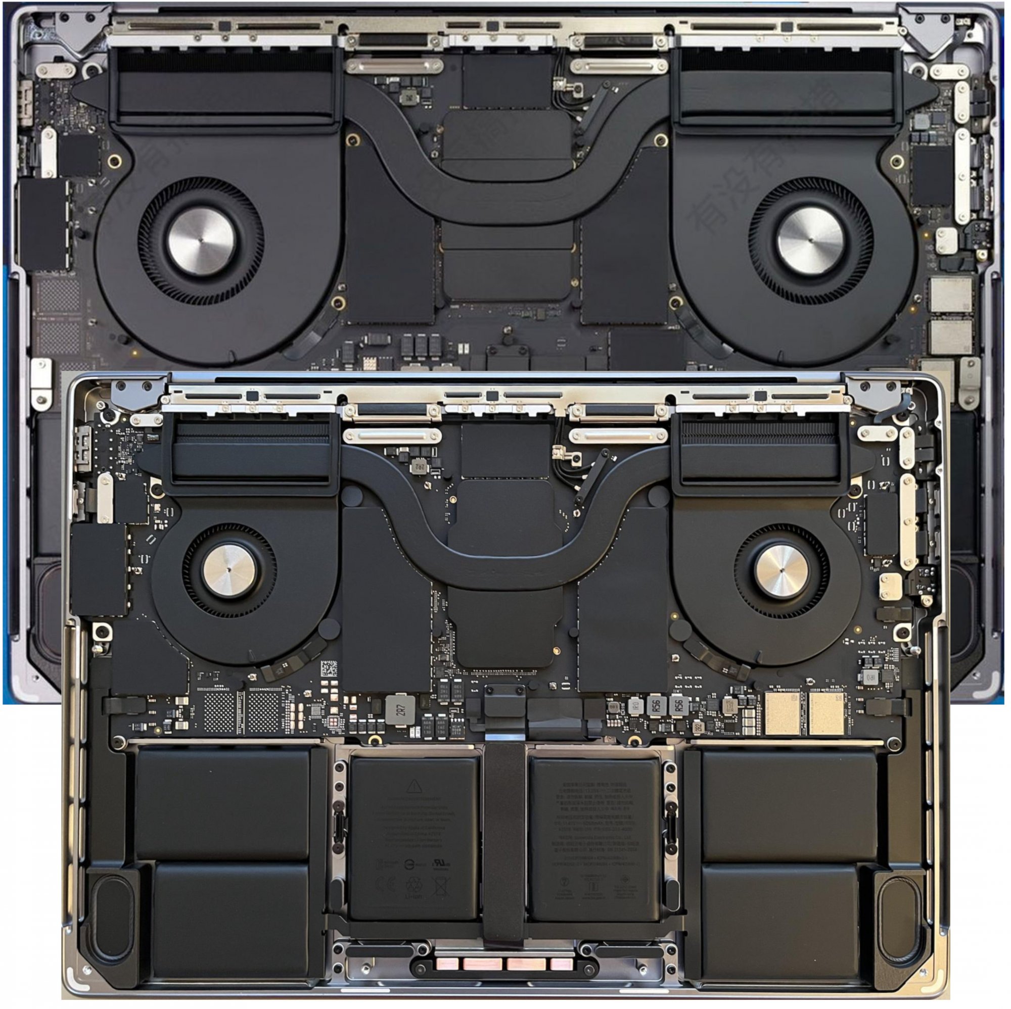

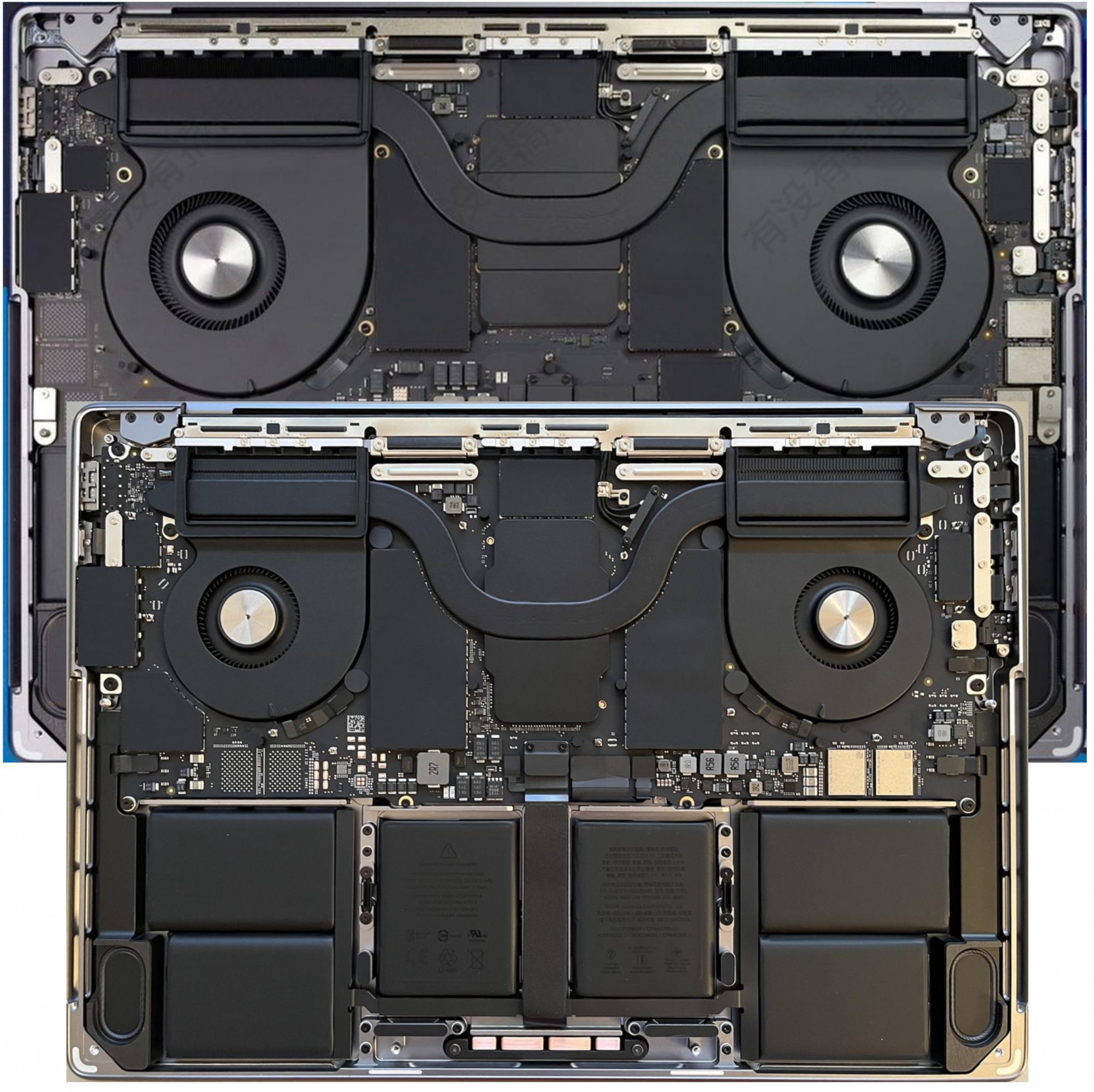

Threw together a quick comparison - the 16" magnification is a bit off (should be bigger) but:
14" has much smaller fan and heatsink
14" has smaller speakers
If both the laptops are showing the same Geekbench benchmarks - it seems the M1 Max and Pro are frequency locked despite the 16" having better cooling. Keep in mind that the SoC can still be thermally limited so it will not show in Geekbench but will show up when pushing both GPU and CPU at the same time (so the 16" will probably downclock less often etc)
where is the all new improved cooling design? if the fans are smaller than the outgoing model?
It’s supposed to be more efficient (and probably quieter based on the early reviews). It may be more about how the airflow is routed and managed and the details of the fan “blades”.
Reactions: amartinez1660
Fans on 16 are significantly larger, heat pipe longer too. Wondering if there is any difference between 16 pro and 16 max? Now waiting for a 16 m1 pro photo…
Reactions: madisonm
What has fan size got to do with thermal cooling efficiency? Its more dependent on the transfer of heat from sink -> pipe -> fans. These M Pro/M Max SoC's run cooler don't they? no separate discrete GPU anymore.
just trying to understand where the extra size/weight comes from and what design choices were made.

The firs thing that strikes me when I looked at the pics it that there really isn't much else on the board other than the SoC - mostly just regulators and periphery stuff. This is a pretty incredible design, to have eliminated so much circuitry by stuffing it all in the processor slab. Must be saving a lot on board design and manufacturing. Impressive.
Small thing, but it appears that the bass transducers are identical on each. So I reckon 14" and 16" will have a similar fullness in the bottom end, but 16" will get louder overall with those larger tweeters boosting the mids and highs.
I was surprised/skeptical when they said that the 14" had the same sound system.
Reactions: Rashy

16" version shows 8 positions for the die for the SSD. 14" version shows 4 on visible side, likely has 4 more on the other side of the PCB.
It would help to know the SSD config of each version shown in the above picts.
Seems to be using same 512GB NAND modules as ones in iphones 11/12, thus upgrading storage should be possible for as cheap as about $100-$120/1TB.
However, still waiting for an in-depth teardown revealing the ICs (by the looks of empty layout patterns, DC-DC power controller & a FET) & all the small passive surroundings. Should be as easy as for iphones, though.
