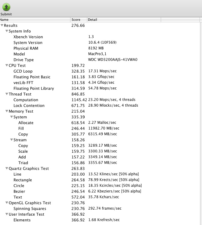

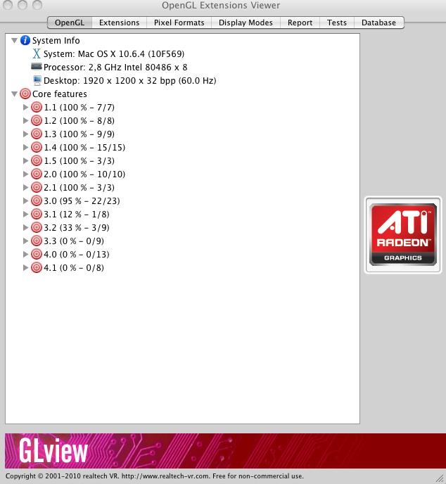

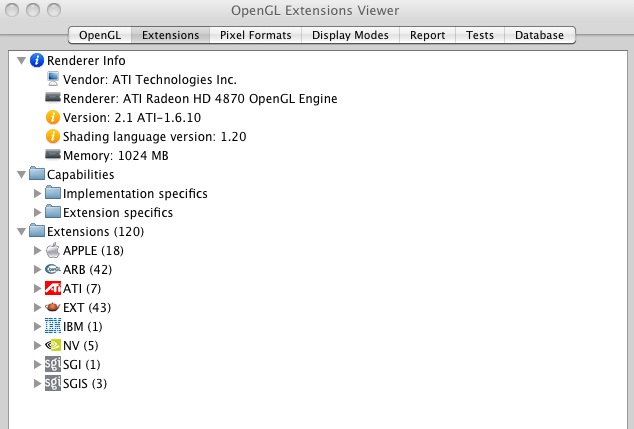

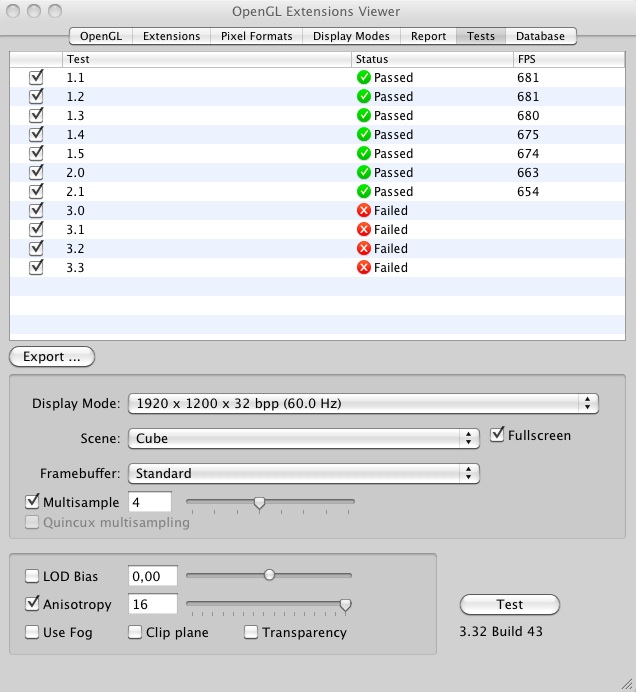

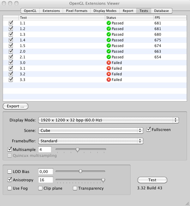

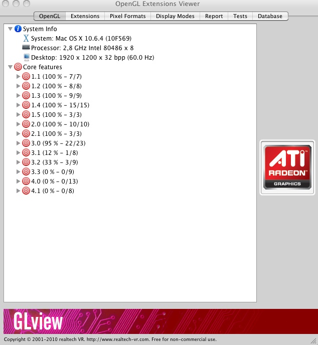

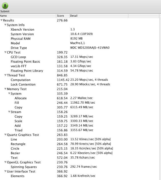

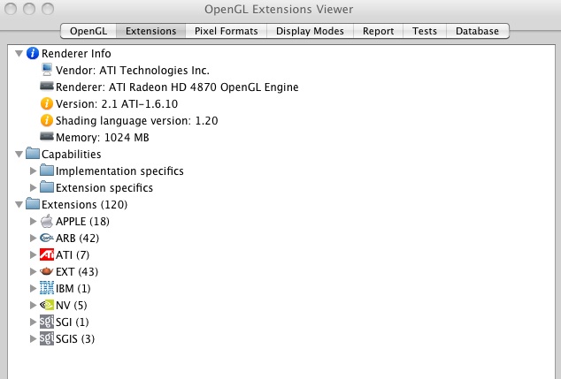

Ok, just another successful story 😛
got one XFX 4870 1GB (HD-487A-ZWFL ver.G.1) (two wire fan)
I`ve got early 2008 MP running 10.6.4
steps:
-booted windows with both cards in (second is orig. apple HD2600 XT), saved 4870 rom with gpu-z
-rebooted with only HD2600 (got KP with both cards in, when booting OS X) patched 4870 rom with Zeus (v.2,1)
-restarted in windows, burned custom edited UBCD with rom and atiflash.. (ultimate boot cd)
-flashed in old skool DOS way (Zeus flashing didnt worked for me)
-booted in OS X with only 4870 installed, without QE/CI (Zeus patches didnt worked for me)
-downloaded Keita_1`s patch from https://forums.macrumors.com/posts/10244228/ , installed two times (?!), and it worked!
So, one big thanks for Rominator, Cindori, Keita_1 and other people and their experiences..
