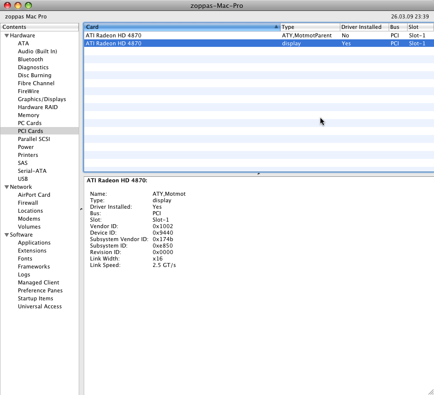

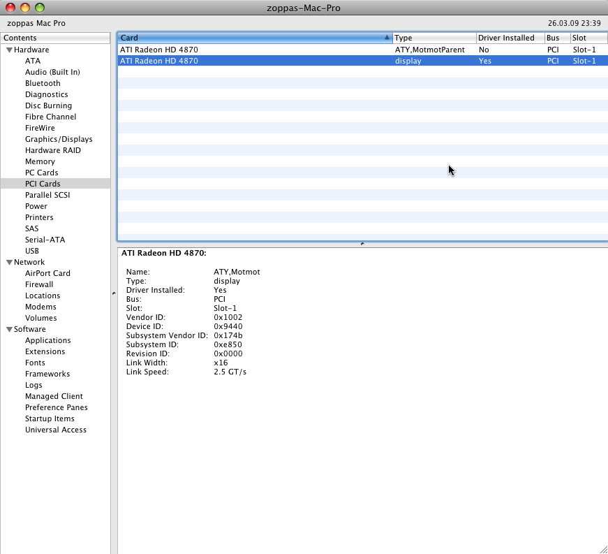

What about the System Profilers view on PCI?
I got Link Speed 2.5 GT/s. On ATI 2600 it was 5 GT/s !?
The same here - 2.5 GT/s. Other question: what about the first line, No driver installed for ATY/MotmotParent. What does is mean ?

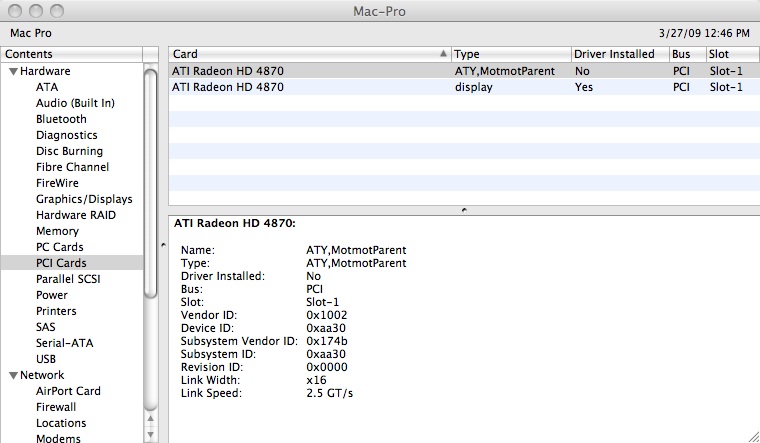

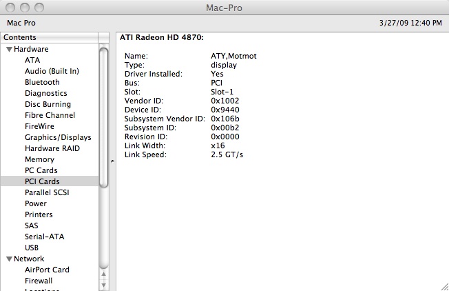

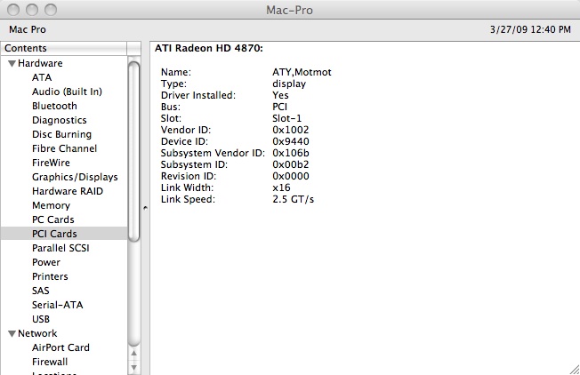

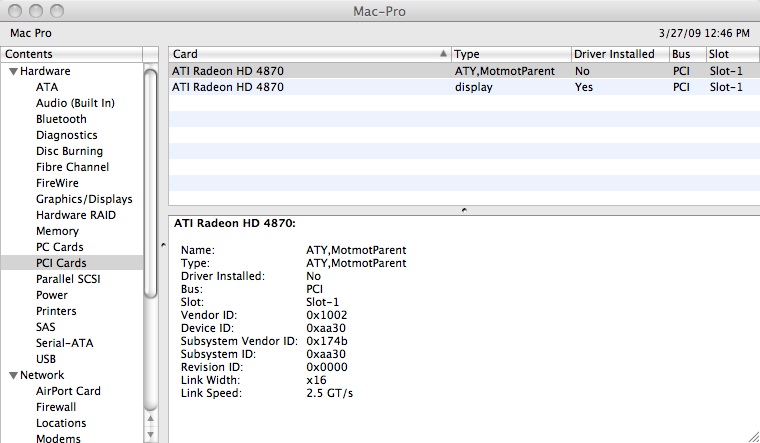

I just checked that PCI line with both of the 4870's I have here.
My original Diamond running the OEM ROM and the newer Diamond running a custom patched ROM.
Sure enough, the one that can run both screens doesn't have that incidence of the "no driver loaded" but the one that crashes on second DVI connect DOES have it.
I know that in the device tree each card exists as a parent and then as an "A" and a "B" where they two "children" are the two display channels. So for some reason, only one is lining up with the driver and the second is NOT.
