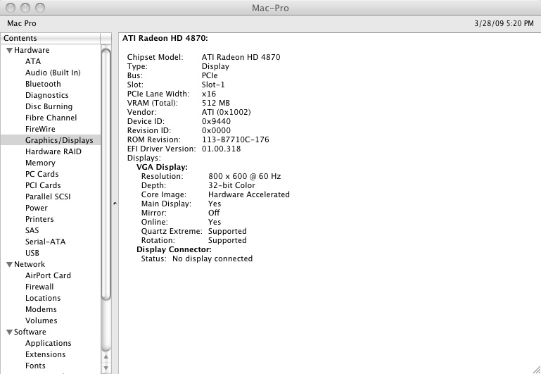

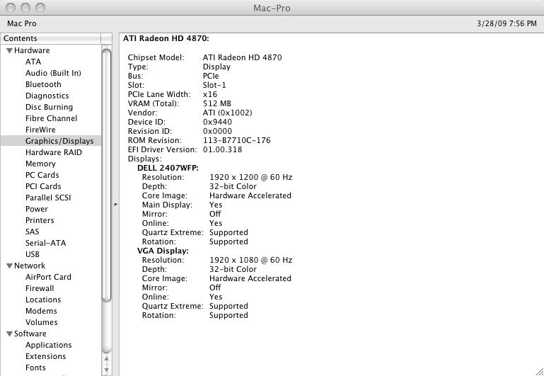

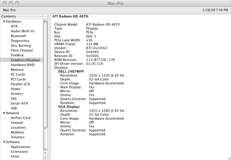

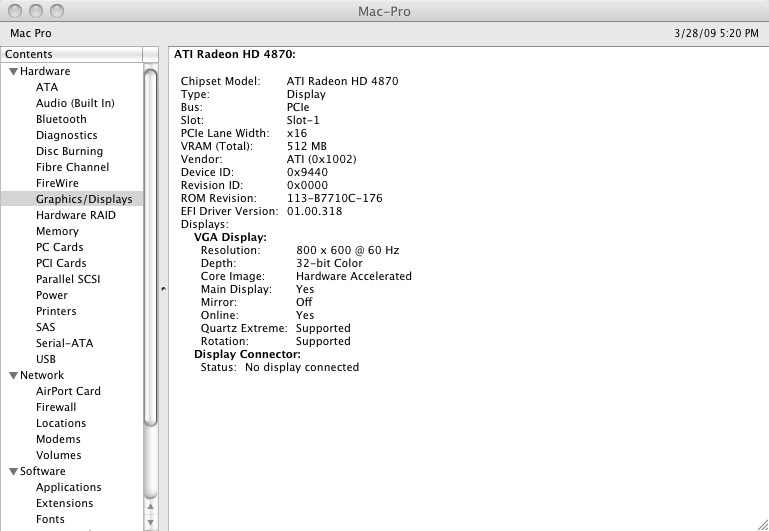

After reading this I realized there was one set of things I hadn't tried.
So I put the DVI-VGA adapter on each output of a 512 Dual DVI card while connecting Dell 2407 on other connector with VGA and.......................
When the adapter is in the LOWER port (Dual-Link one) and the VGA is in upper, THE VGA WORKS !!!
Well, sorta. It appears to not be getting an accurate EDID as it can't guess what display it is and just calls it a "VGA Display". Most of the res options for it don't work.
1920x1200 is there..but at 76Hz....not LCD frendly.

Well, the "Single Only" Diamond 4870 didn't care for the DVI adapter trick AT ALL.
It did it's "CRASH" trick.
I am attaching the IOReg report from the OLD Diamond 512 Meg 4870 that runs Dual.
This report was taken while it had the DVI to VGA adapter on the lower Dual-Link port and the DVI splitter on the upper port. Thus, both SEPARATE display channels were present in the single, upper DVI port.
The screen shot was taken at same time.
Note that only res close to native was 1920x1080 @ 60Hz. Everything looks a little funny.
