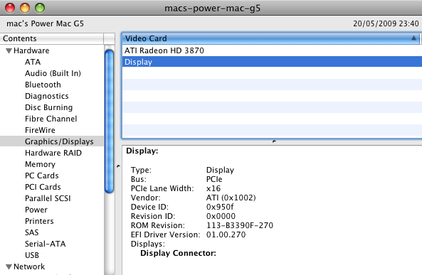

Is this natit just for 4870 cards as I have installed it and it does not recognise my unsupported card 3870x2. If it needs to be tested with 4870 I can probably buy one for testing.
Edit: I see from the natit plist that it is only for 4870. Ok sorry about this.
PS I don't know why my system profiler on the external firewire drive thinks my Mac Pro is a G5 🙄

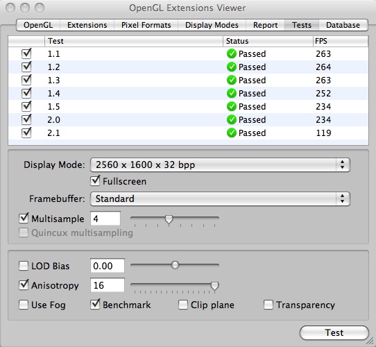

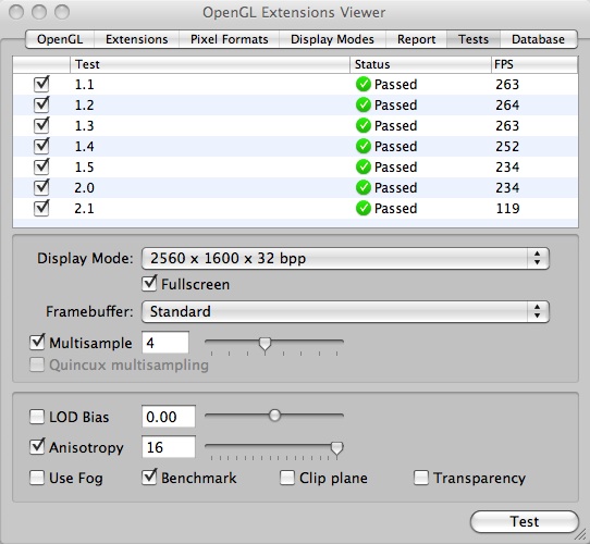

I installed the kext and rebooted and tested with opengl and performance was cut by half. Tried twice and same result, uninstalled and went back to normal. - compare to result post 1336 - XFX 4870 1g flashed
lol, such comments always make fun, nobody asked to measure performance with very cpu dependent test. the test was to get dual dvi.
thought that it worths looking into since performance was cut by as much as 50% with the kext, doesnt' matter if cpu or gpu related. Dual DVI is working with or without kext for the XFX 4870

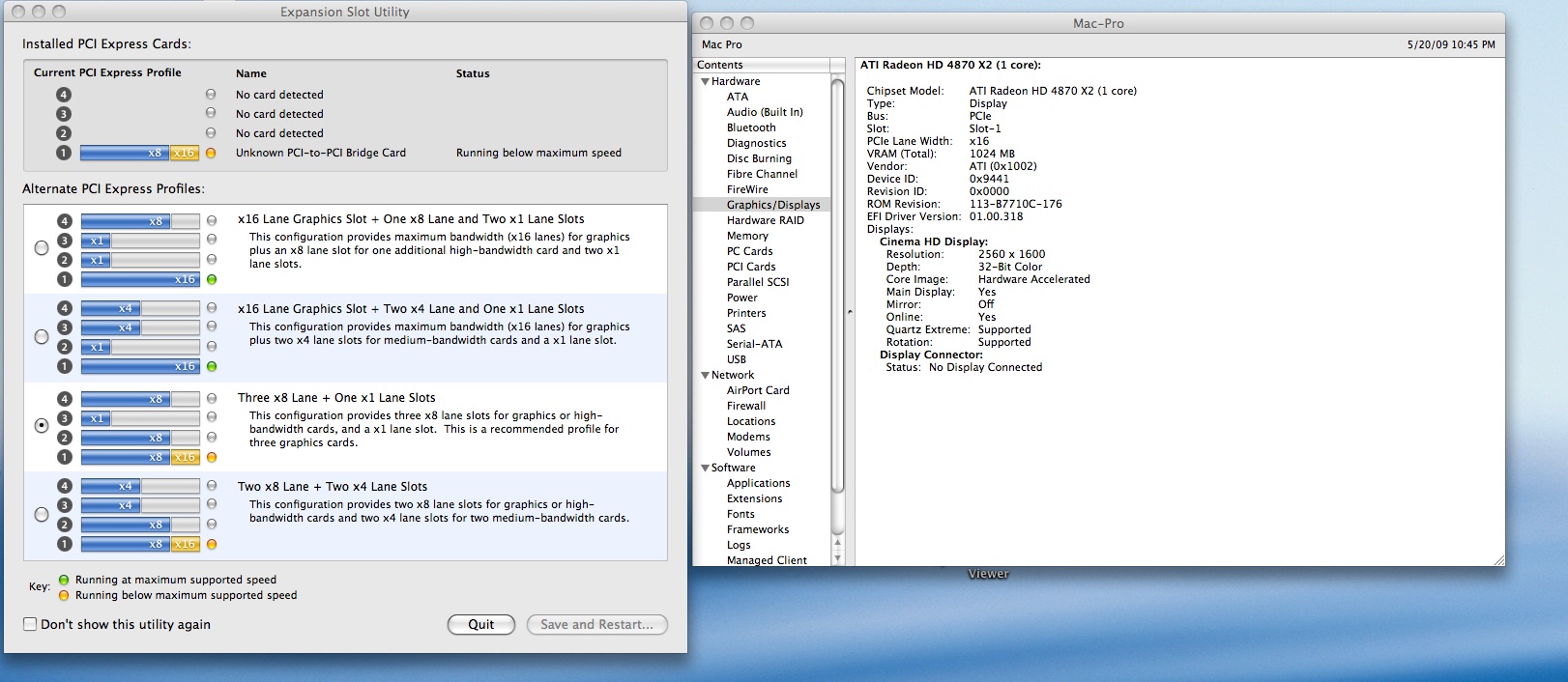

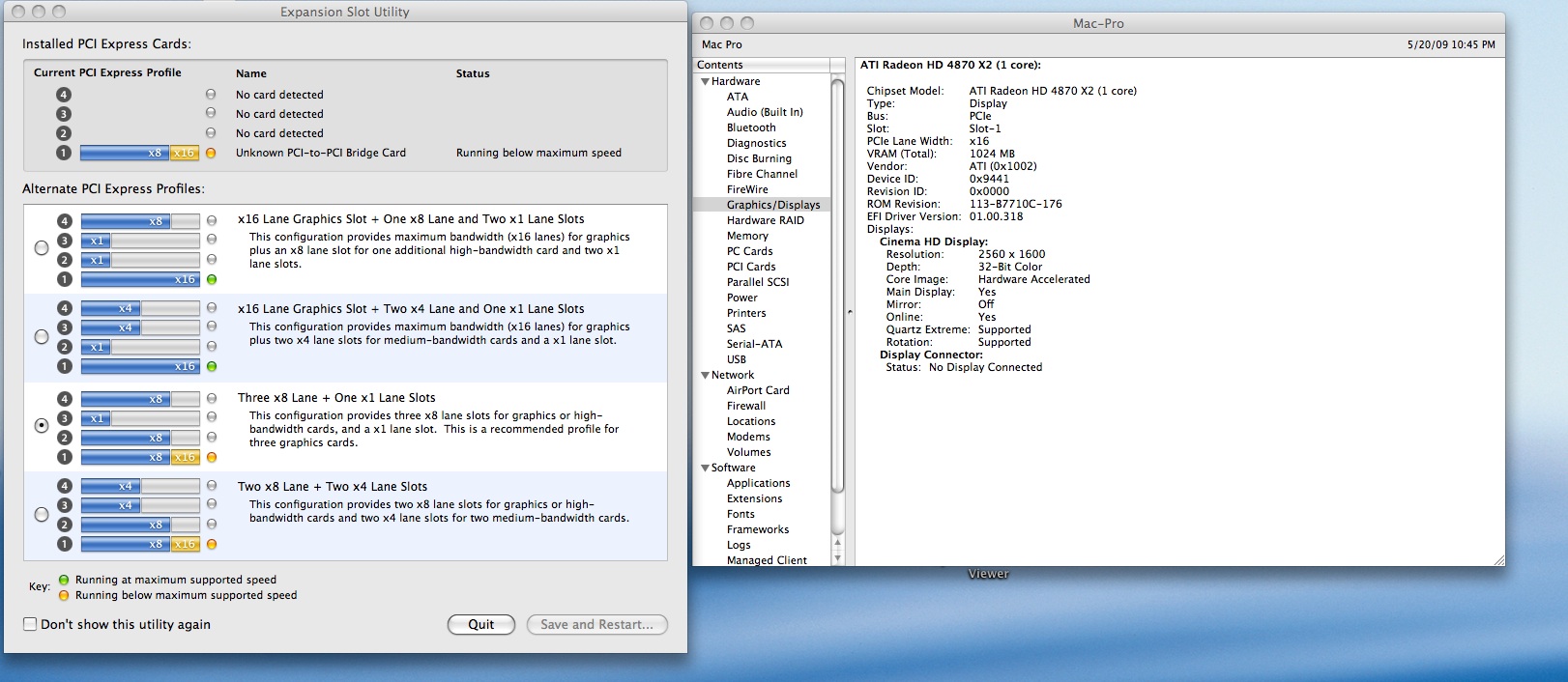

During my extensive Crossfire testing in the last day, I had occasion to run the 4870x2 again. Now with Netkas 4890/exotic cards magic the card works in OSX. As I reported before, it is MUCH slower than even a regular 4870 at this time.
But I think maybe we need to have another look at it. I have attached a couple screenshots. It turns out that in Windows the card is designed to work as a single card, with a PCIE bridge chip combining the work of two separate GPUs. As you can see, the Expansion Slot Utility sees it as just this...a bridge chip. While the 9800GX2 requires working Sli via software, the 4870x2 is supposed to "just work"....if the bridge chip is supposed to be invisible, well, all beyond me.
At the very least, it would be good to figure out how to get it to function fully as a single 4870 in OSX...then it could blossom into an X2 in Windows at will.
