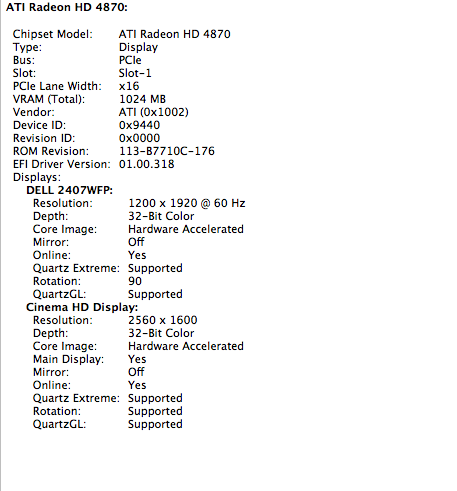

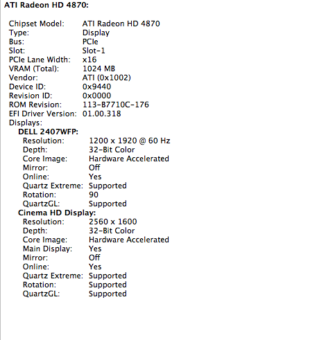

Just tried the Natit.kext on with my flashed PC SAPPHIRE 100259-1GL Radeon HD 4870 1GB with OS X 10.5.7 and now the second monitor is working fine. This is really good news so thanks to those responsible.
Have not tested the possible sleeping issue yet.
