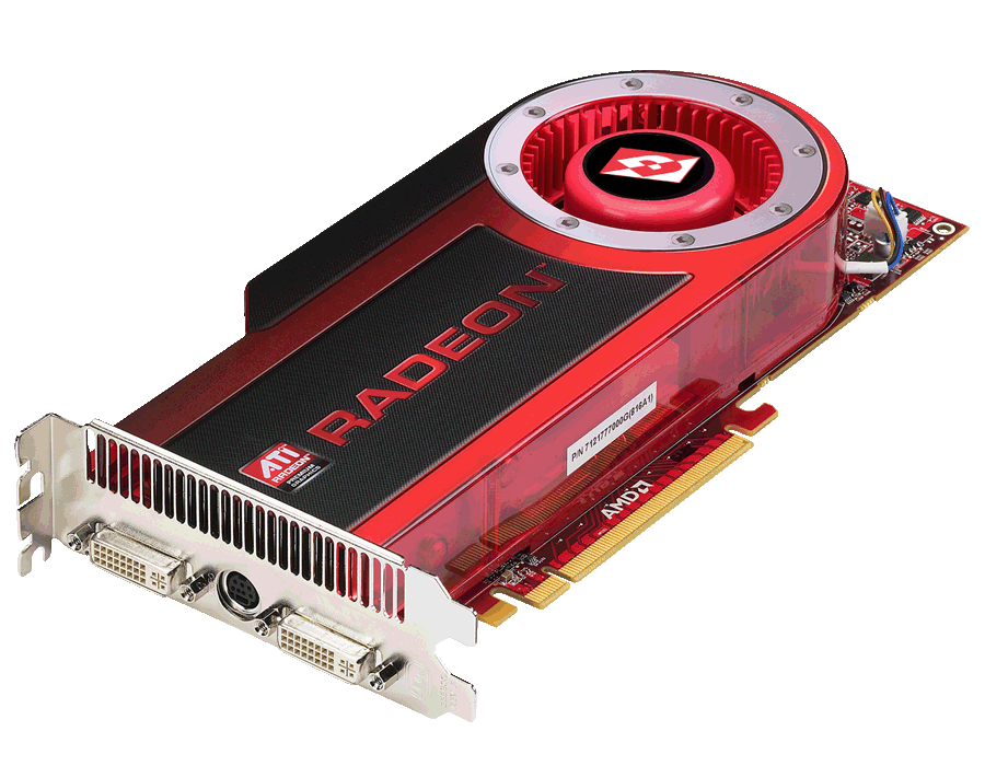

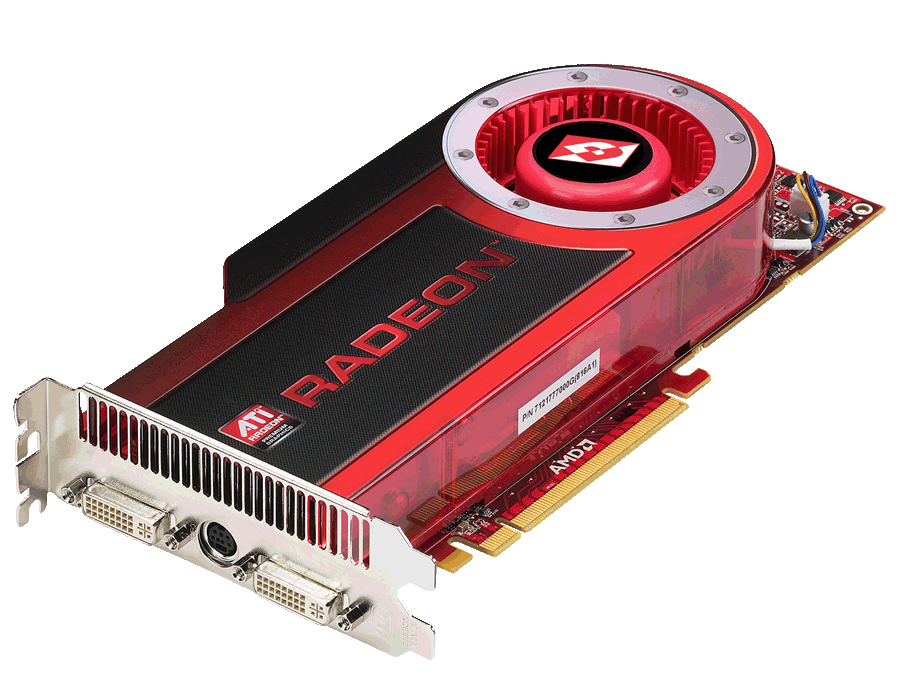

This is for a Diamond 4870 512Meg version.
I am using the Mac Pro motherboard power connectors (mini 6) to power it on a 1st gen 2.0 ghz 4 core.
I don't get the power warning, and all I did was flash the ROM. I'm not using an injector or anything. I bought it specifically because it looks so much if not exactly like the ATI card.
I have not checked the part number on the attached photo against mine, but it looks exactly like it.

Rom for Diamond Radeon 4870
Attachment didn't work...here is the completed ROM made with piccolo's .py script.
**IT IS NOT A ZIP. Just remove the .ZIP extension, I'm on my Mac and too lazy to do a real ZIP. 🙂
This Diamond (if it looks EXACTLY like pictured) is AMD reference design card. And there was no need to create custom ROM 😉. All of reference 4870s 512MB are working with Apple original ROM (easiest flash ever).

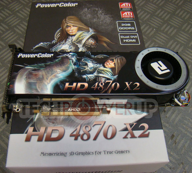

I've Powercolor 4870x2 card. I'm using 10.6.1 SL with QE/CI (-pci0 works great)
I'm gonna upgrade 10.6.3 version. Which ROM should I flash it and install patch before upgrade? 😕

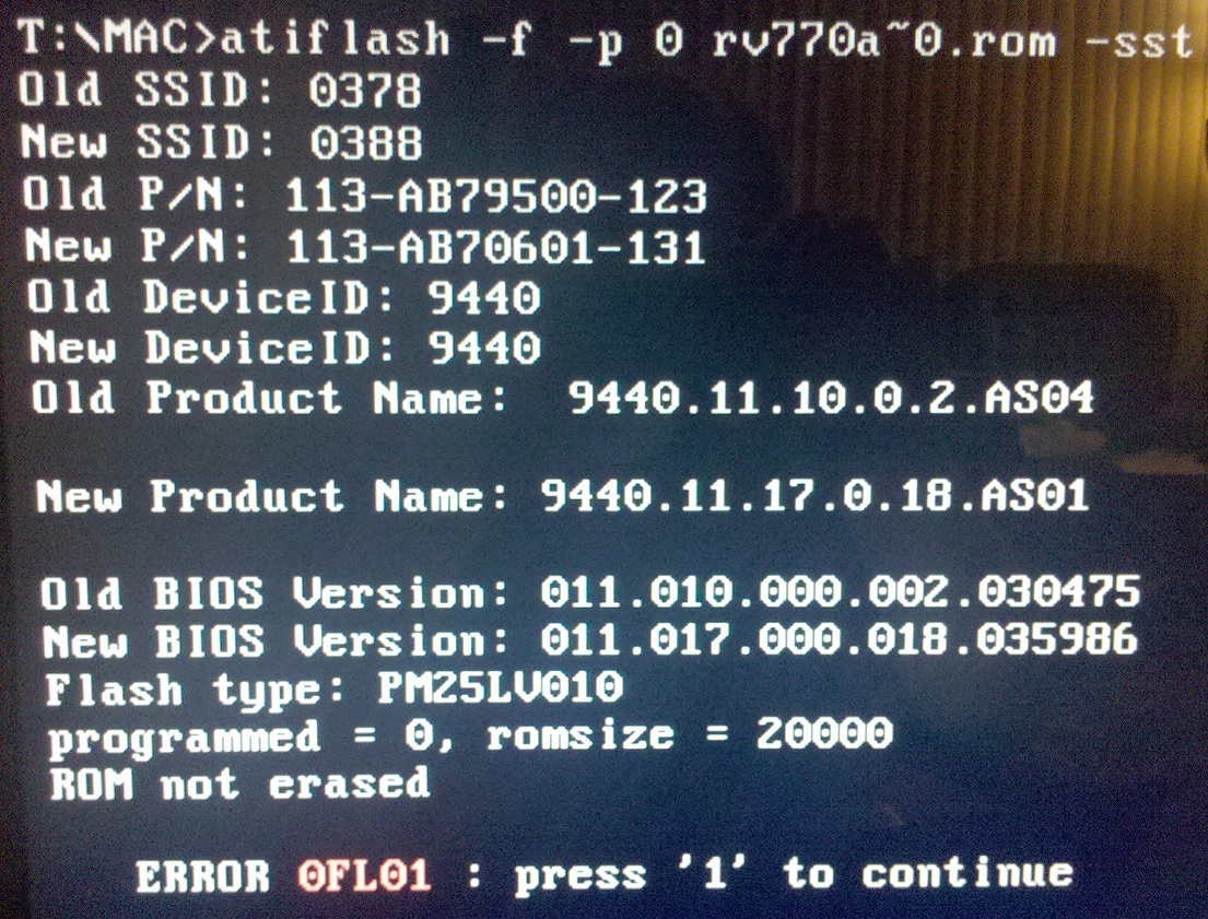

Hi Yak! I recently obtained this card as well (at least I believe it's the same http://www.newegg.com/Product/Product.aspx?Item=N82E16814121376&Tpk=asus 4870). I tried using the rom that Cindori created for you, however I got the same error you did. How did you end up getting around it? You said it took many hours, I'd like to save myself that time (if I can). Also, I'm posting my original rom to see if it should be compatible with the original you posted.
I should additionally add that I'm using Snow Leopard 10.6.3, I have the ATI card in slot 1 and my NVIDIA 8800GT in slot 4. Also, I can't boot into OSX in this config without going into safe mode, I'll have to put the NVIDIA back in slot 1 and see if the cards being in the slots they are is causing that issue. Also, i noticed my BIOS version is different than yours:

no go
I just gave 3.60 a try and still no go, any other suggestions? Yak said he got it to work with 379, so I'm hoping he will chime in soon...

I found Asus EAH4870:HDTI:512MD5:A.zip in the golden guide forum, but I have a 1GB card, and that one is a 512, would this bios affect the amount of memory that could be read? (assuming it's compatible).
