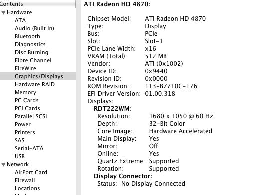

Thanks to all the friends around this forum I have succeeded flashing 4870 card. It is running well so far. No warning and sleeps OK.
I got the used card and 6pin cables from auction.
It wasn't in a box or with any manuals but it says P/N7120777000G on the fan box.
I have tried some uploaded ROMs first but didn't work. So I made a ROM following the instruction here. I booted Mac Pro from DOS CD and move to Bootcamp directory then flashed with ATIflash command.
Actually this was my second attempt(second card). First one from Sapphire with Zalman fan, I screwed it flashing with Zeus for unknow reason. With the bad card Mac Pro won't boot(not with OS X, Windows nor DOS) so I can't recover it by reflashing. Anyone with solution for that?
Attaching ROM I made and original one in case someone wants them.

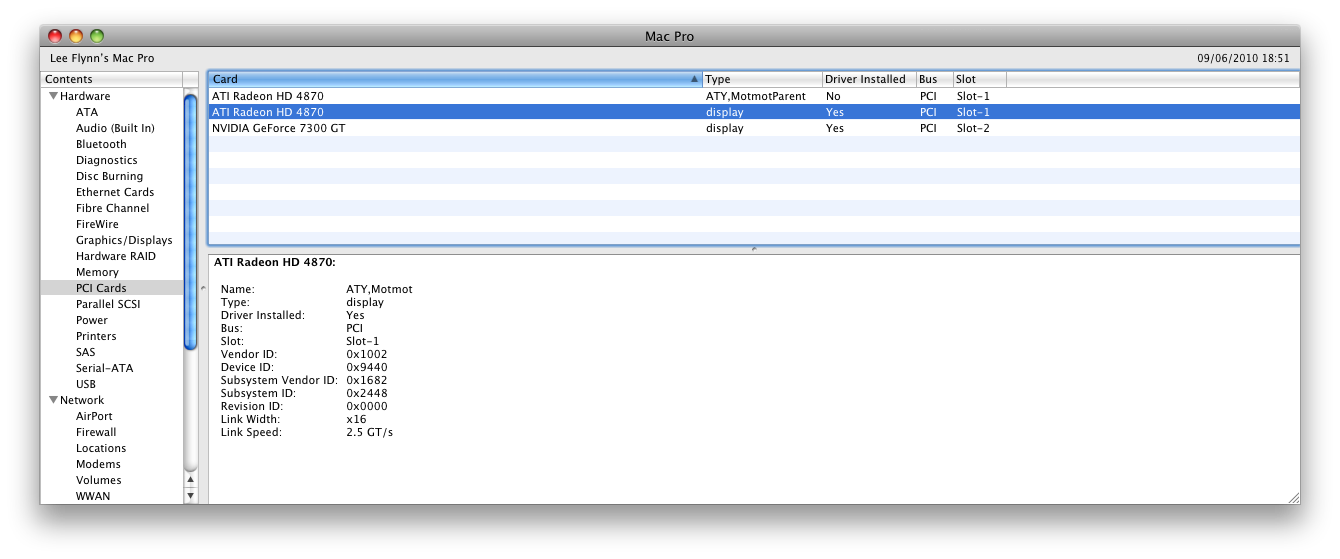

Hi All
Firstly thanks to everyone that made this possible i just saved over £150 and got a extra 512mb of ram.
I spent about 12 hours reading all this thread and groths blog the golden rule and various info the the web, it then took me 3 hours and bang it works.
MP1,1 2006 7gb Ram
Thank you all
I first thought i had a broken gxf card but found out today it was my Hp 30" screen.
My card was the HD-487A-ZWFL made in china version C.0 1GB bought in the UK, for £100 plus 2 power cables from ebay £10.99 each cheapest around unless i wanted to wait for them to be shipped from the USA at £7 each.
My rom is attached but it the one from this site i used any way and the one from groths.org the golden rule Small collection of roms. I found that Zeus would not work for me natit and flashing also.
So i tried the ati flash tool also from groths.org.
1,installed natit from ati flash
2,turn of and inserted 4870
3,booted up a couple of time eventually found that only the background was available and right click work no comands or anything could only create new folder and get info and that shot off the screen as if i was missing real estate.
3.5, zapped the pram dont know if this helped but!!
4, booted back up with old 7300gt in slot 2 just above the 4870 worked.
5, zeus again would not flash the rom so used ati worked.
6, rebooted with 4870 all good tried zeus and it worked so flashed it again and rebooted.
7, uninstalled natit on both ati flash and zeus and rebooted again all working very happy.
I must say a few times in between 2 and 4 and got kernal panics and BSOD hangs i just turned off and pulled the power cables from the 4870 so although the fan spun the card did not show up in system profiler. when i had it running off the 7300gt i just carefully put the power cables back in and flashed the card, rebooted.
I do get the error message about power cables i can live with that either click ok or leave it as it goes in about 10 sec and does not effect anything acording to all the info on here.

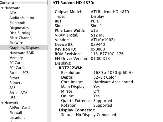

I have looked in S/profiller and i have a duplicate 4870 there see image
weird but ha it all works and i i start to read more further down the line im sure both of them issues will be sorted and i might even have a go a building my own rom.
Thanks to all posters and contributors esp Cindori and The Rominator and a big FU to apple for trying to rip us applets off.

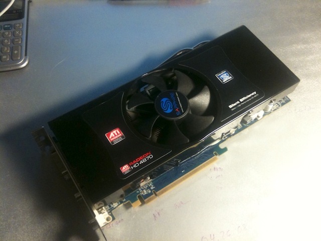

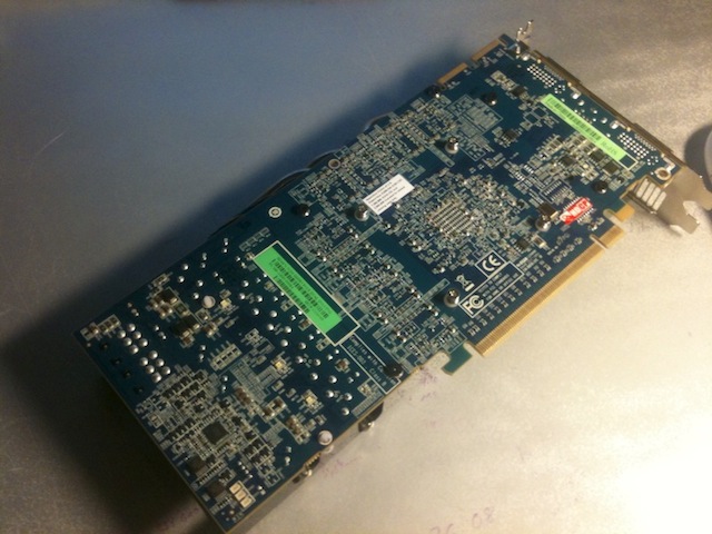

Hi guys
its my first post here. I'm roger from Switzerland 35 years old.
And i need your help advice.
I have a MP 1,1 with a 7300GT in in and it's so low. so i decided to buy a sapphire 4870 with 512MB Ram (PN: 288-10E85-030SA).
i tried pipomolos way to build a custom Rom (NewPC4870.rom) out of the mac rom i found on the net (Mac4870.rom) and the extracted original Card rom (original-PC.rom) --> see attachment
Flashed it with the BootCD under dos and the flashing worked good.
Also the card works under windows (bootccamp).
But now when booting parallel with my monitor attached to the 7300GT, the apple logo shows at startup, but the i get the kernel panic! --> included in the attachement.
also when i install only the 4870 i get the panic.
i don't know what i did wrong.
hope anyone can help me, thanks a lot
Roger
PS: excuse me if i could not read through the entire post

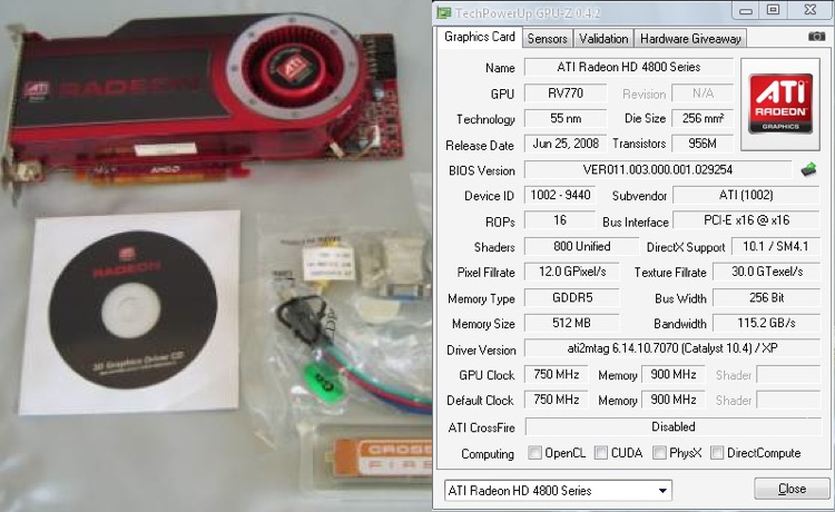

HD-487A-ZWFC Ver G.1 Can't get working
I've read just about everything I can find to try to get this to work.
I'm running 10.5.8 and I'm trying to the card listed in the title flashed and working. I've used Zeus and loaded modified and unmodified roms and the card isn't getting recognized by the OS.
If I install Natit the computer grey screens on boot and I'm forced to hard reboot.
Is this card flashable?
I'm also getting the error message from Zeus:
Flash Aborted! Possible reasons:
ROM Already identical to card firmware
Card not compatible with ROM or Zeus
Any help is greatly appreciated!

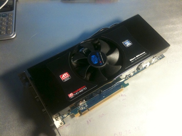

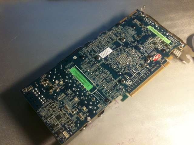

Hi 666sheep
my card looks like the attached pictures.
i tried the rom i found somewhere here on one of the eralier posts 🙂
flashed it with the original rom, but gray screen and kerne panic --> hard reeboot.
so i tried pipomolo42 way and created a custom rom --> same thing, gray screen
I'm running 10.6.4 by the way and did nothing expect the flashing of the rom (as i understood i do not to need to do any OS X modifications such a separate driver installation)
thanks for further help
Roger

Hi 666sheep

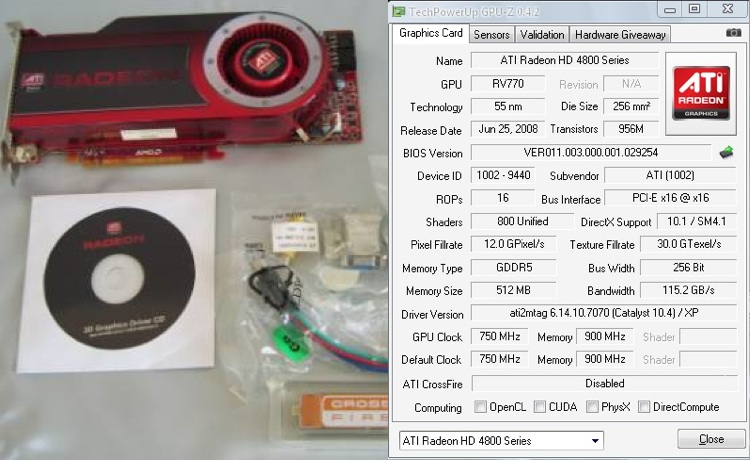

Roger
I have never held one of those 4870s in my hand, but I do know that LOTS of people have had luck with the 1 Gig version.
May be worth a few hours reading through posts, or at least searching this thread.
Did you check your finished ROM for 2 @ MCUCs? That "GoTo" address lines up with where the 2nd one is?

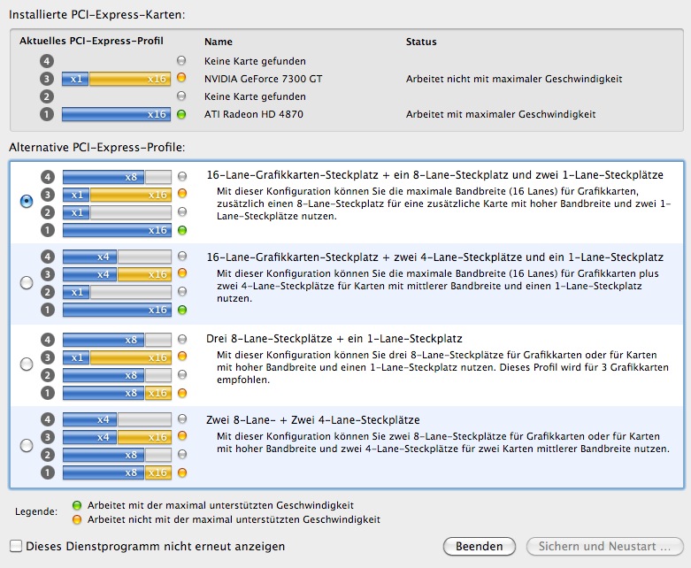

hi guys
it worked! i used the http://groths.org/zeus/XYZ.zip way now and suddenly it worked. i have the new sapphire card.
i also have testet it with 1.3 benchmark and achieved the following results (see attachement) are these anywhere where they should be or is my system not running at full speed?
Also something that strikes me is the fact that the card gets quite hot and the fan is very loud, is this normal or am i just used to the silent 7300GT?
With additional fan modification, what am i risking? overheating?
thanks guys again for your help
Roger
