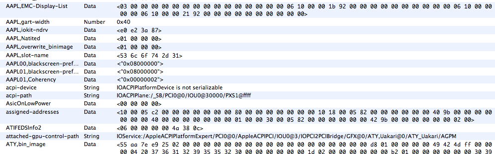

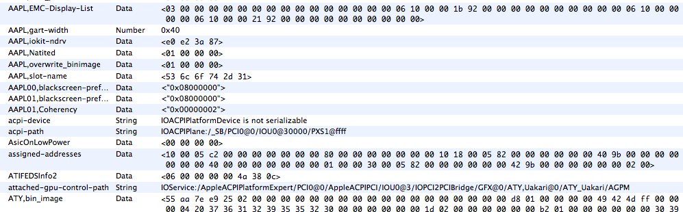

Meanwhile, back at my 10th floor tenement, I couldn't STAND not knowing if that AGPM / MacPro 4,1 thing was important. So, I stuffed BOTH hands down the couch cushions, grabbed ALL of the change I could grab, and bought a 4,1 Mac Pro.
And no, it didn't make any stinking difference. Still runs EXACTLY the same, but now IOReg Explorer actually shows BOTH of the control strings, the ones my 1,1 showed, and the ones the 4,1 hack showed.
If Netkas can think of any 1,1 vs 4,1 tests that might help, I'll do them.
