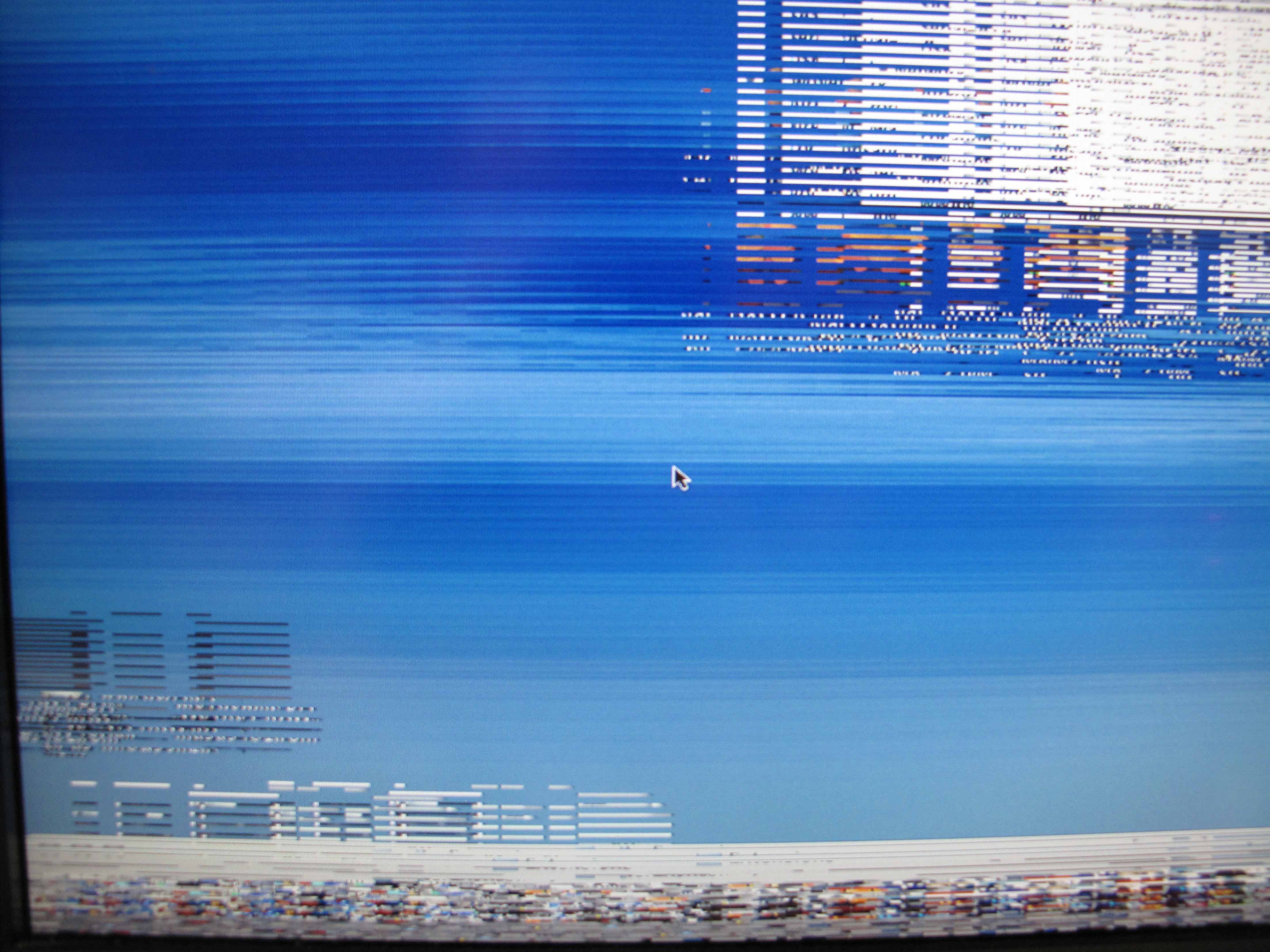

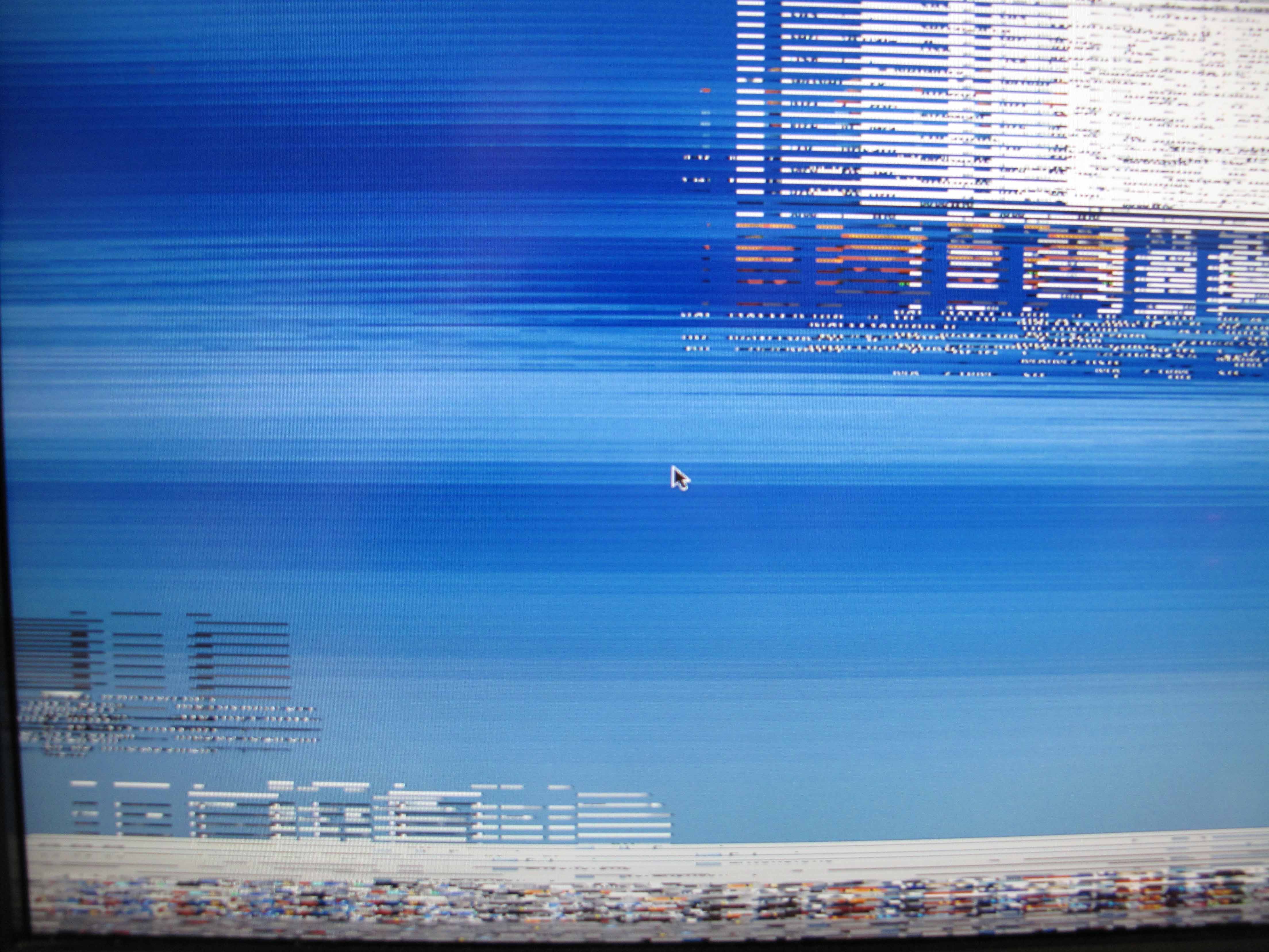

More Znalis & Vervet findings
With the Zonalis framebuffer, the lower DVI port can be enabled by plugging an HDMI display. However, using this framebuffer, BOTH DVI ports are Single Link. The DP port can sense Hot Plug, but no signal comes from it.
Someone with a 5770 that only has upper DVI should try plugging HDMI cable in. HDMI cable may need to terminate in a display.
And again, no QE/CI.
Also, have a theory that messed up screens may be due to incorrect math for pixel clock. May or may not know what I am talking about. Pix at 11.
Vervet has same basic behavior. When used with an ATI 2600XT, either X2000 will load or x3000. If 2000 loads, the 5870 works as 2D frame buffer and 2600 works normally. When x3000 loads the 2600 stays locked on boot screen and 5870 shows mess.

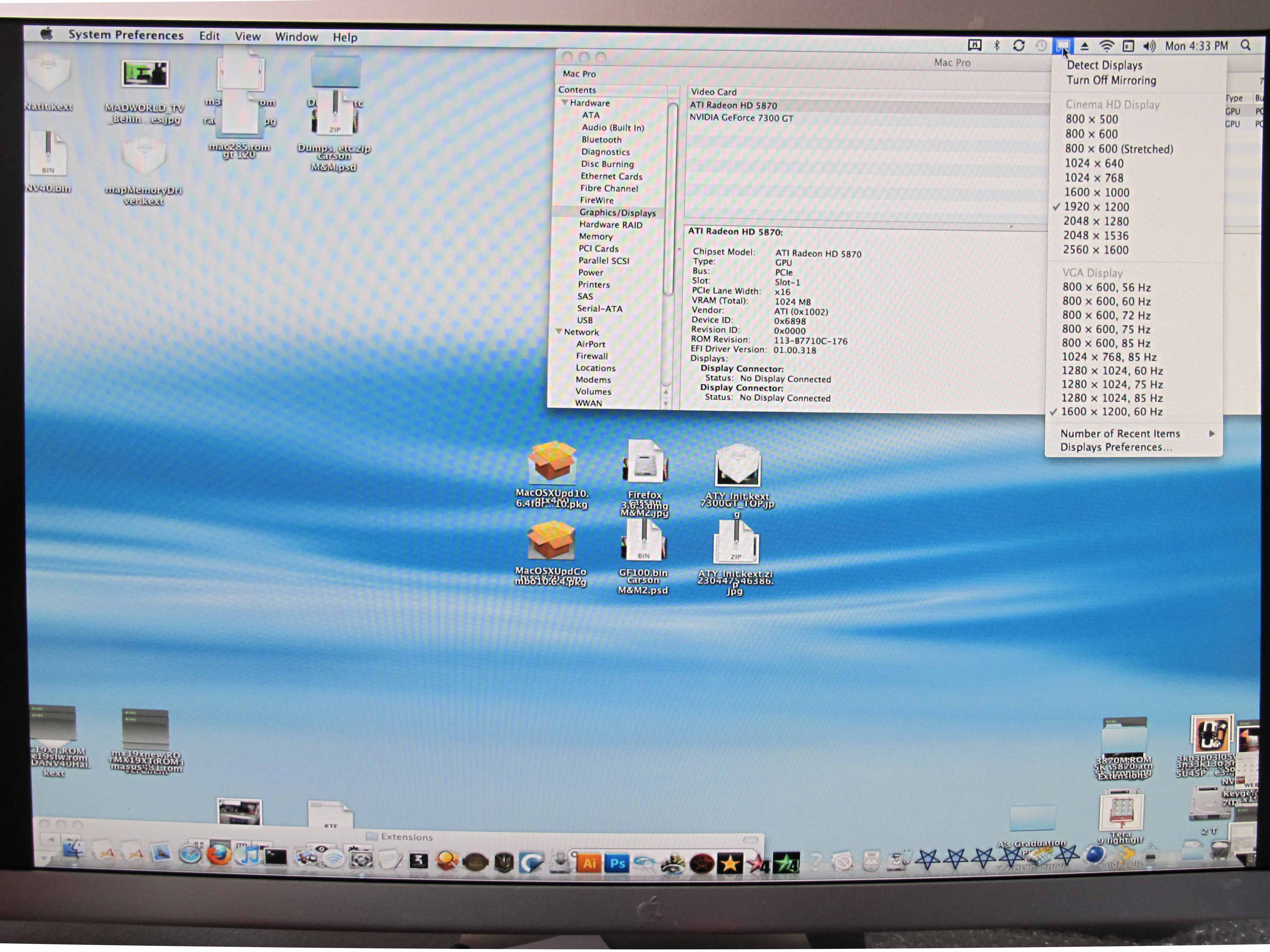

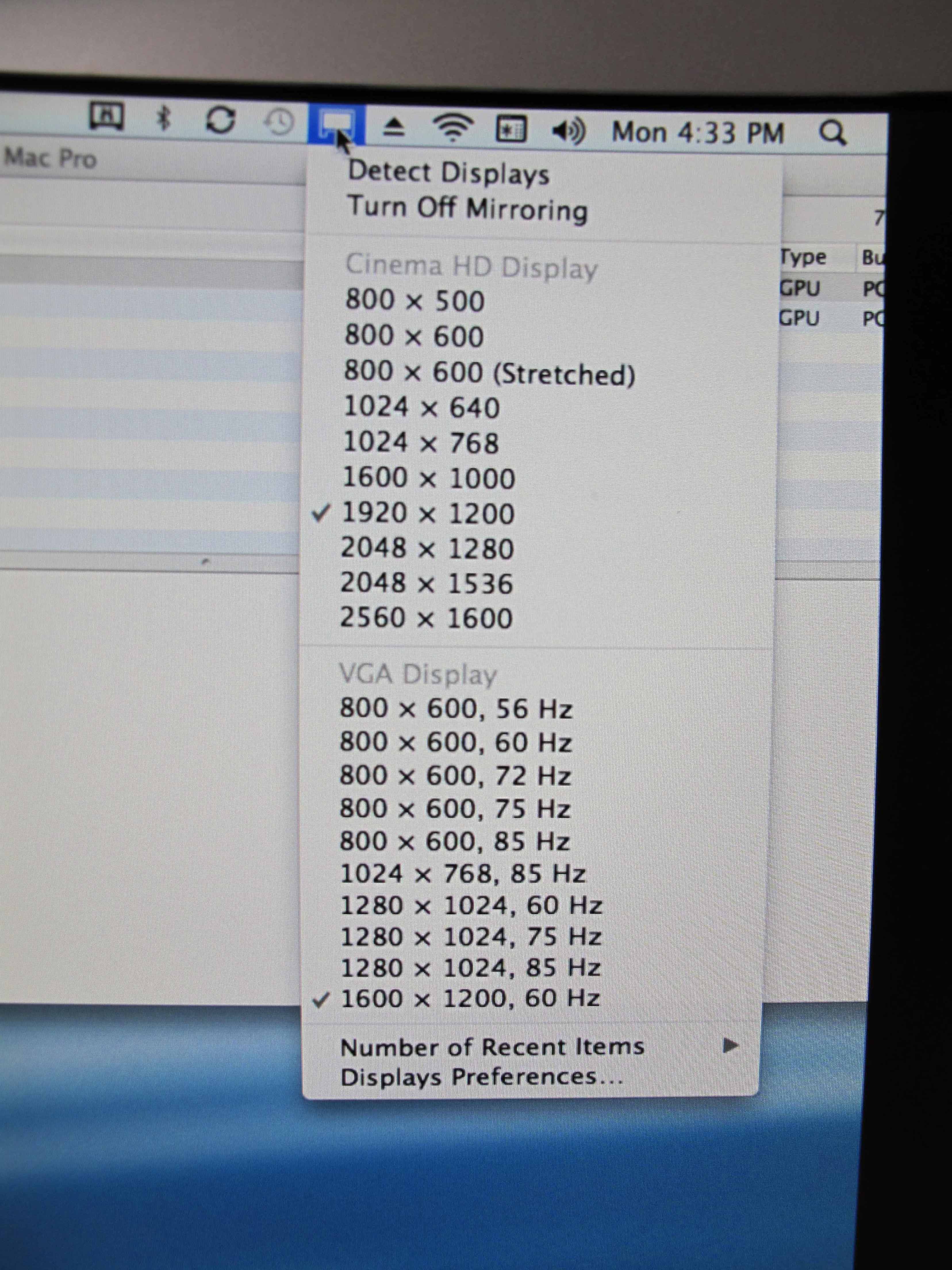

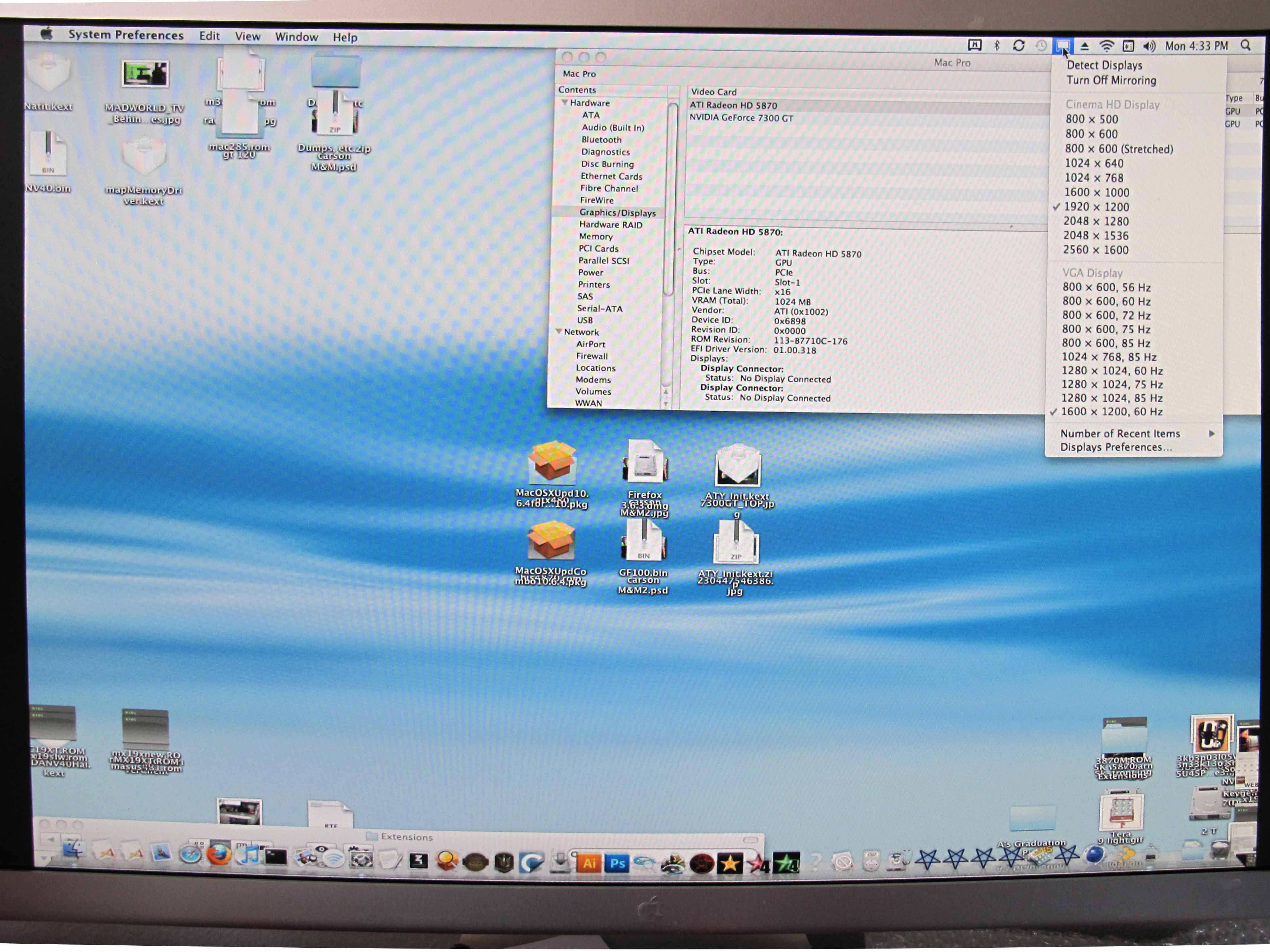

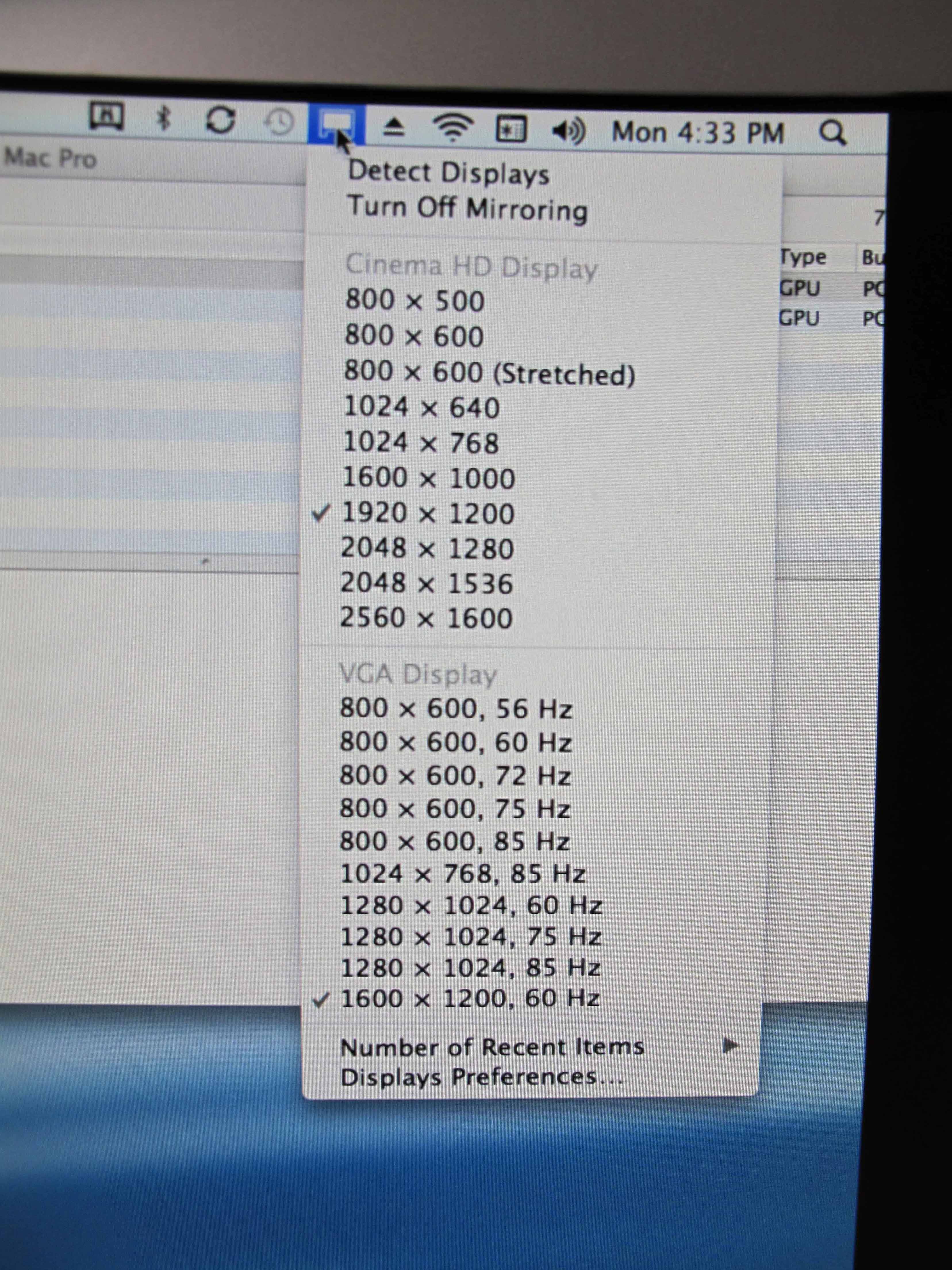

When I tried VGA on the 5870, it becomes somewhat easier to see. Instead of strange repeating squares of distorion, it seems that the desktop is stretched horizontally.
This is bourne out by the resolution choices with the Apple 30" on the 7300GT in. It only wants to mirror, doesn't allow me to click the off selection for mirroring. When 1920x1200 is chosen for 30", the 24" Dell is given 1600x1200. It even seems like you could SQUEEZE the picture from the sides and line it up. Mind you, each action or resolution change takes 40-50 seconds. The machine seems mostly locked up and occasionally a mouse click gets through.
Further tests tomorrow with other Frame Buffers. I may also try flashing my 5870 with the Sapphire Vapor-X ROM and see if it runs better with the ATY-Init that includes it.

I've got an Asus 5870, and working from an otherwise successful hack install of 10.6.4 I've been unable to get it to boot with the aty_init and driver bundle kexts installed. Serious artifacting similar to Rominator, or just hangs at a blue screen. I'm going to try the trick you recommended, netkas. However, with the level of artifacting i've been getting it'll be hard to do anything, such as change resolution. If I set Graphics Mode to 1024x768 in my com.apple.boot.plist, will that start osx in 1024x768? Or rather, should it?
Edit: didn't work, oh well. I removed that line from my plist and it's not artifacting at all anymore. Now it's just hanging at a lightish blue screen.
