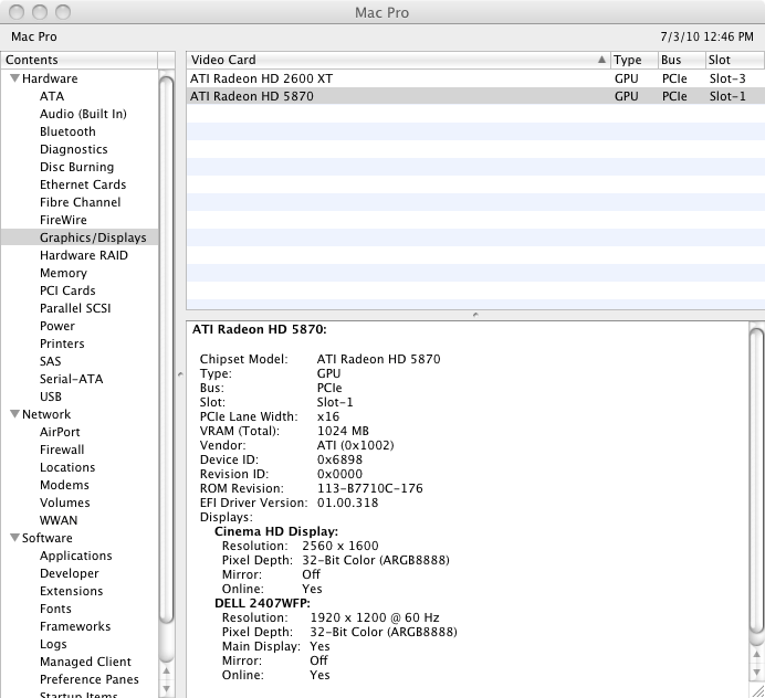

Got screens up and running, but using software rendering now.

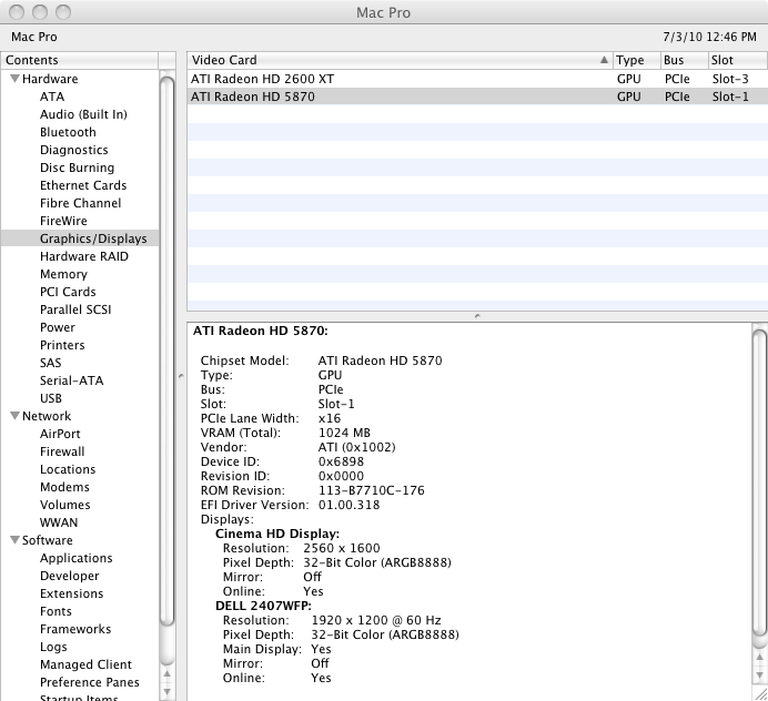

I've installed the 3000 kexts all of them at once and quartz is enabled and transparency and everything.. i'l make some screens now

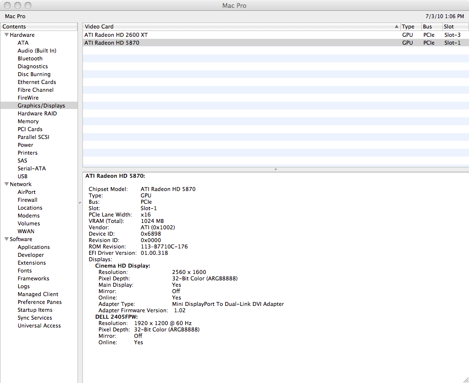

Wondering if I have flubbed something. Screens look great, but no QE/CI or OpenGl.
I DID try all of the ports...oddly enough they all seem to work. I have the 30" connected through DP through Apple's adapter.
However....can't run 3 screens at once...so no Eyefinity....yet

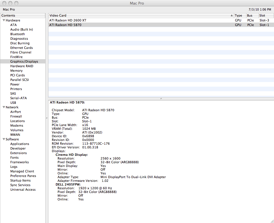

Rominator, you dont have ATIRadeonX3000 kext loaded
remove it, and it's bundles and reinstall with kexthelper
