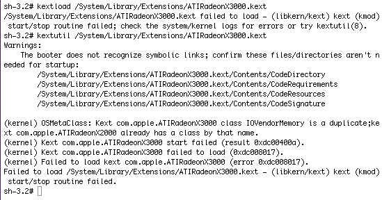

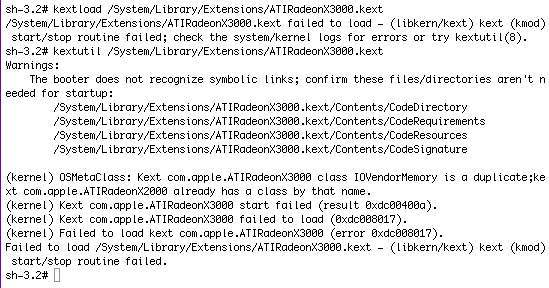

Rominator, try to kextload atiradeonX3000.kext manualy when booted, maybe smth wrong with it, so you will know.

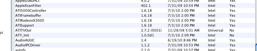

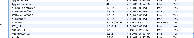

OK, by using 5870 only with NO displays connected I was able to see this from Macbook.
Next I am going to try using Macbook via firewire s startup drive since I never use it to test stuff, a "virgin" system.
With no displays connected it boots up and 3000 is loaded.
Attaching displays AFTER boot doesn't do anything, even with "Detect Displays" hit.
If the displays are connected at boot, it loads a messy set of screens, lots of squares and SLOW drawing of more squares.
Did a dump from it while booted with no displays, will attach.
indeed
doesn't load if a display connected
loads without one but then won't detect
results verified via startup from unfiddled-with Macbook HD.
dump is from when no displays connected and 3000 DID load.

indeed
looks like you need to remove atiradeonx2000.kext first.
could be wrong tho.
