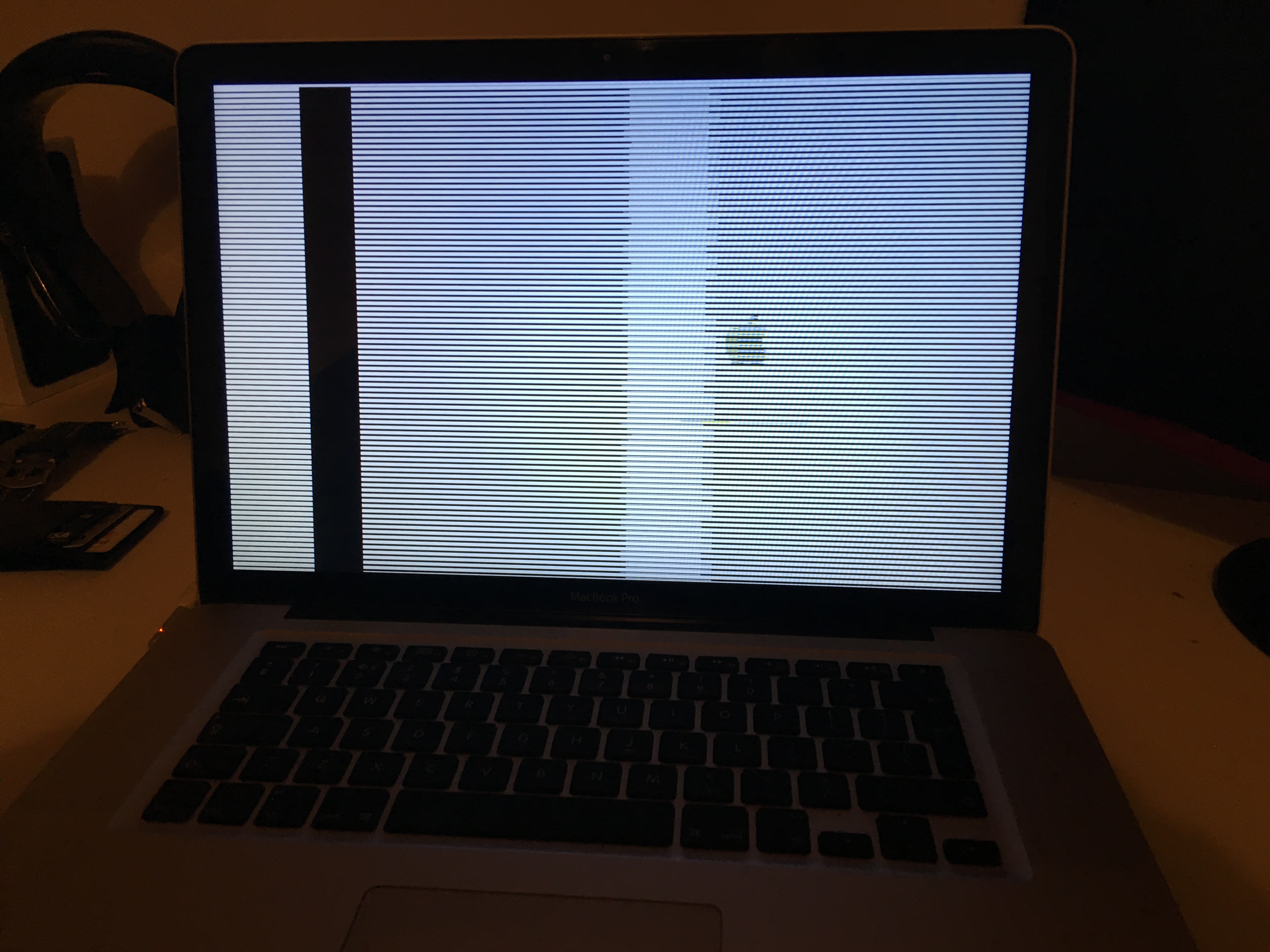

Soon as I get home I see this -
Take it back to Apple with pictures. As stated Apple wants to minimise their exposure. Your best interests are not their priority, more sales are...
Be polite, equally be firm elevate to the store manager as required. Your MBP is clearly indicating signs of imminent dGPU failure. Should your MBP fail to start it will not be possible to verify that the dGPU has failed, or if it passes the GPU test Apple wins...

Thanks again for your reply. I'll take it back at the weekend, with the pictures and video I took tonight. Just have a feeling that because it passed their test they won't do anything. It doesn't happen all the time. Since I took that photo, it's been up and running without any issues.
Thanks again for your reply. I'll take it back at the weekend, with the pictures and video I took tonight. Just have a feeling that because it passed there test they won't do anything. It doesn't happen all the time. Since I took that photo, it's been up and running without any issues.
Remember this is exactly what Apple wants you to think, perseverance is the key. Ensure that Apple documents all, I would also contact them online with imagery attached, once again to establish a strong documentation trail of issues directly related to graphic corruption. Apple wants to project a very specific image, in reality the sole objective is to make ever more revenue. This I have no issue with, equally Apple must be held accountable by the customer, frequently all to often this is not the case...
Speak with citizens advice, I believe that in the UK you are protected for up to 6 years on personal computers. Think of it as a siege, with patience you will win.
Q-6
So I've spent a good 30 or 40 minutes chatting to Apple via their support chat. Glad I did now, as they've escalated my issue after seeing the pictures and video. Callback is scheduled for Sunday at 9:15am.
