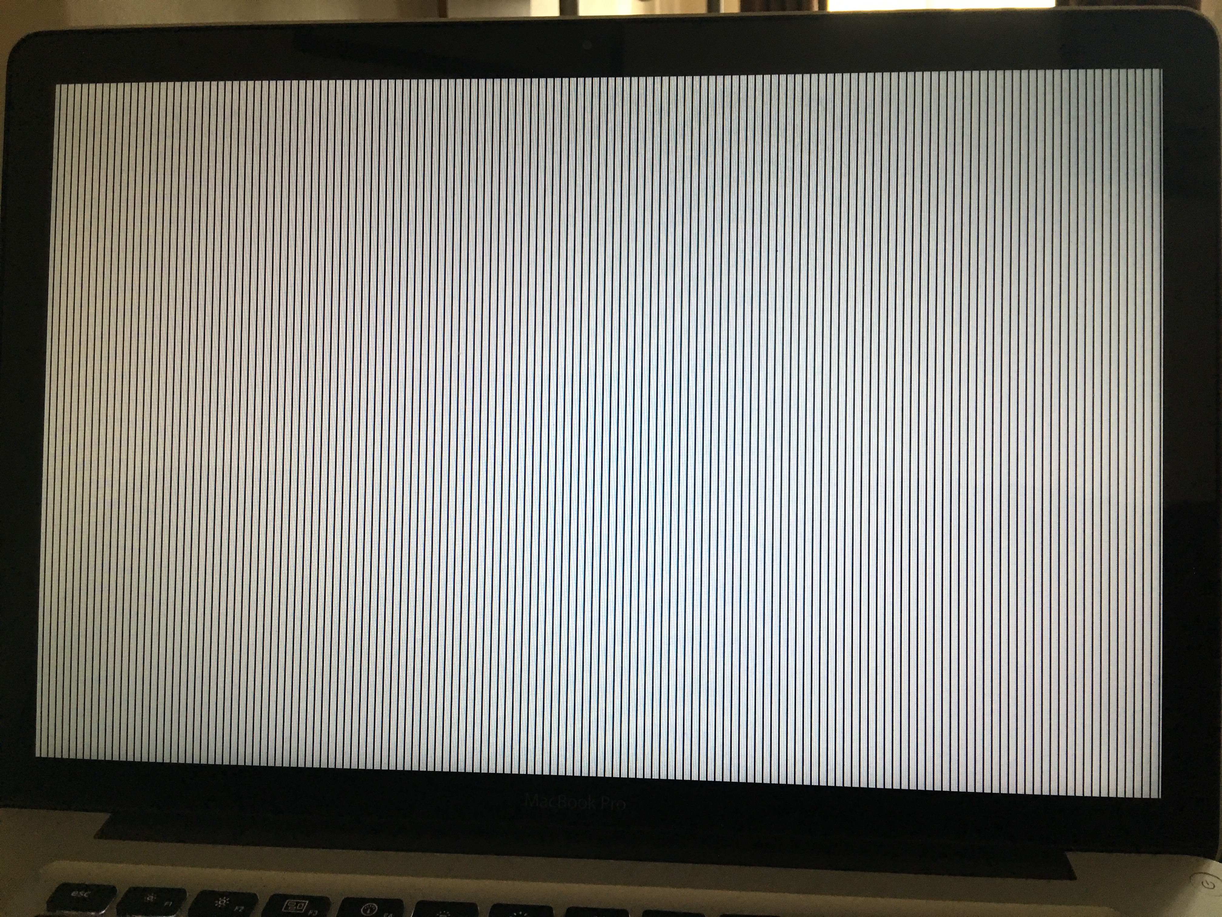

Same here. Green tint, plus horizontal bright green lines. Passed the tests with flying colours. It was the same on an external display therefore not the panel so so they took it in. (That was before the repair extension and under consumer law.)
EDIT : Having read the other comments from last night.....
As above, you have to play the game. When it fails, take photos/video if you can.
Use the correct language if you get to the stage of needing to use consumer protection.
DO Politely express your dissatisfaction with the product prematurely failing given the price paid, an that you'd expect better from a premium Apple product. Keep calm and remember the genius of the other side of a desk is trying to help you.
DO NOT Kick off at the staff and say that everyone's logic boards on MacRumors are failing. That just gets their backs up.

When my father had his 2011 MBP repaired, it passed all the tests even though the screen was pink when it booted. The Genius took it in anyway though, as there was an obvious problem. It's a shame they didn't do that to yours, it seems pretty clear it's not working properly!
I had a feeling that it would pass their test, as it doesn't happen all the time, it's a little random. The pictures/video I took last night definitely helped though. The laptop cleared it's self within a 10 minutes of being on and I haven't see any other issues since then.

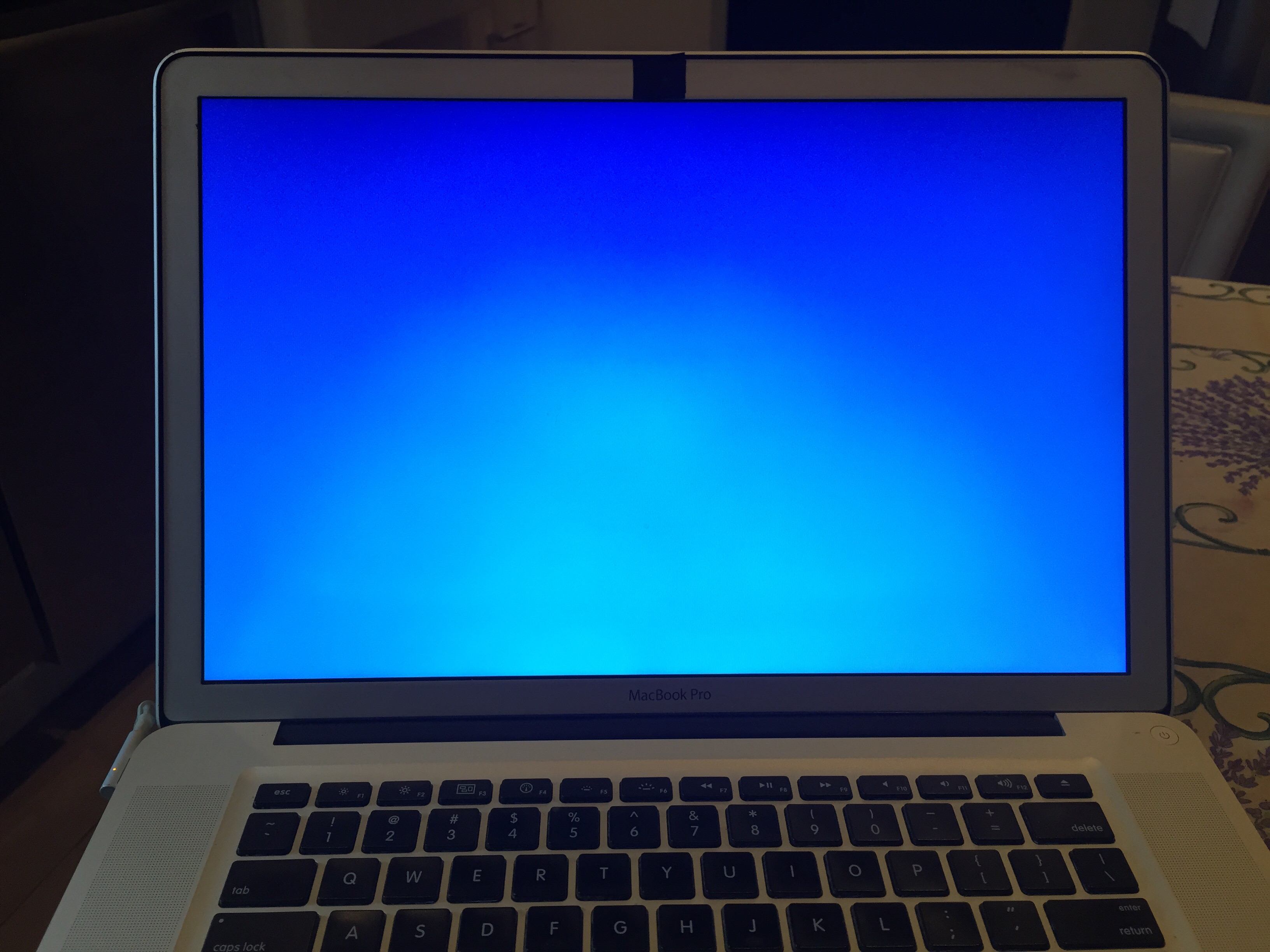

So this happened this morning. Wasn't doing anything other than editing an excel document. Just going to call Apple again.
