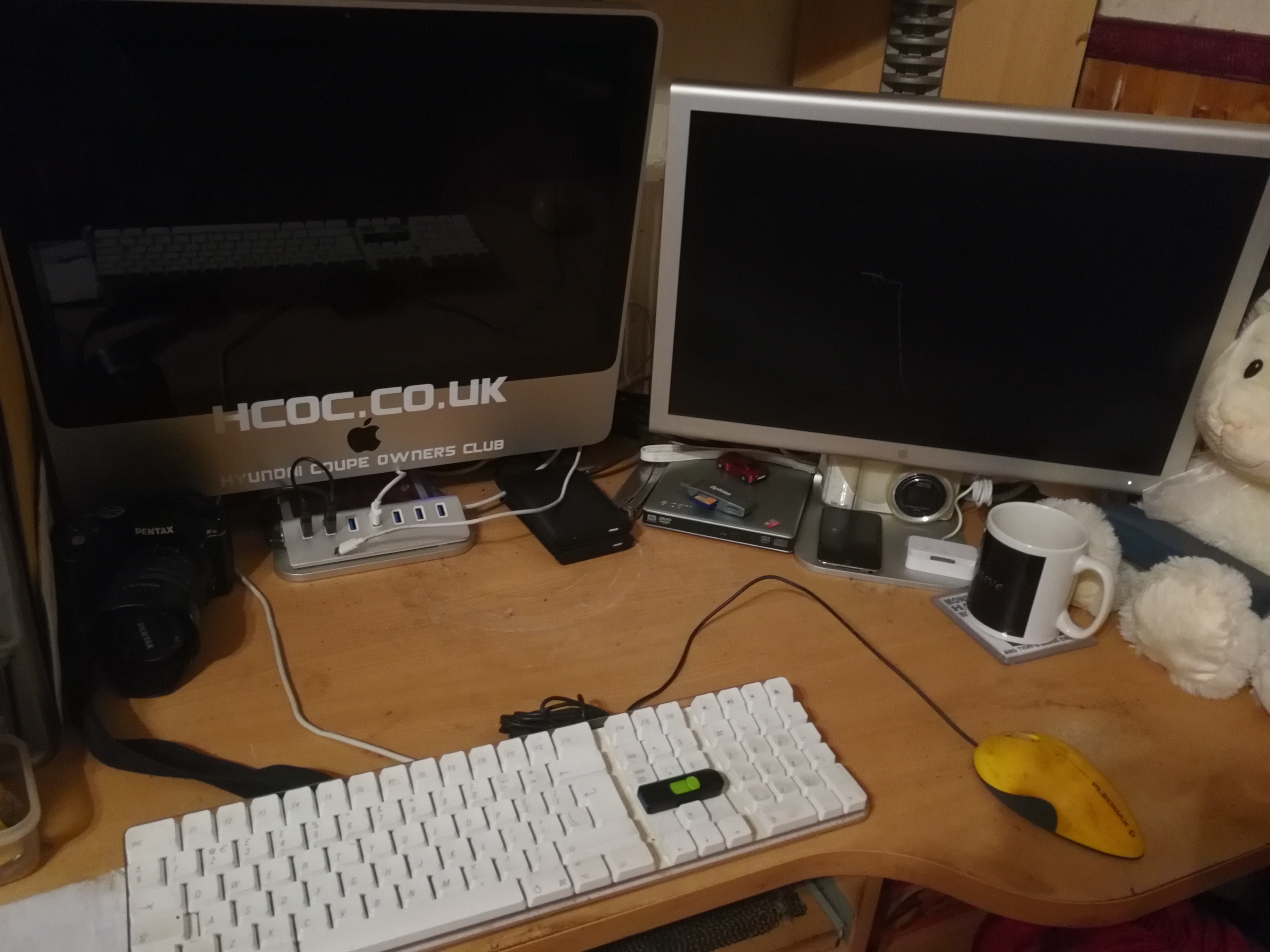

This is mine, 7 port hub stuck to base.
The two black usb is for the HDD which is stuck to base behind the hub.
I had to buy a PSU as was not powerful enough.
