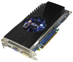

HIS Radeon HD 4870 iCooler x3
Hi everyone. I am new to this and have read all the pages and I am still not sure how to get my card working. I have HIS Radeon HD 4870 iCooler x3. Has the following ports x1 DVI x1 VGA x1 HDMI.
Have installed the ATI Flashing tool. Installed Natit, trying all the options in the list and all i get is a blue screen. Have not even reached the stage of flashing the card. Maybe I have missed something?
If I ever reach the point of flashing the card the required rom is not in ROM.zip file. I understand I may need to make my own but again I am not sure how to go about this.
Please if anyone could help out it would be much appreciated.
Cheers
