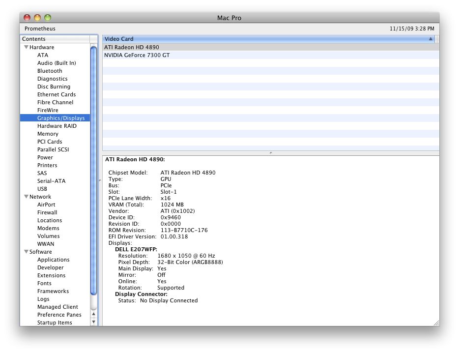

Just want to report another success with the HIS H489F1GP HD 4890. 😀 It was painfully easy to flash and reboot – and it's soooo much faster than my 7300 GT. Cindori, you're awesome. I'll have to contribute to your candy jar sooner or later.
