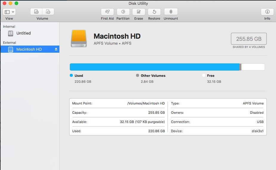

This is what shown on Disk Utility

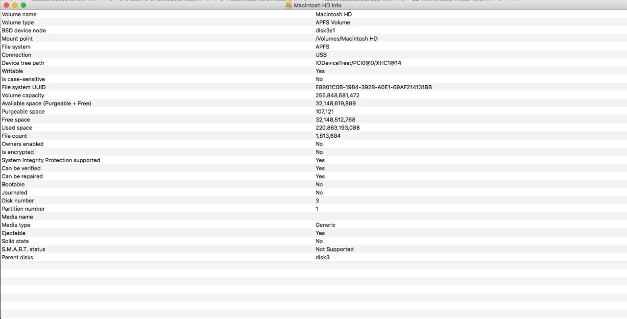

and this additional information about disk drive

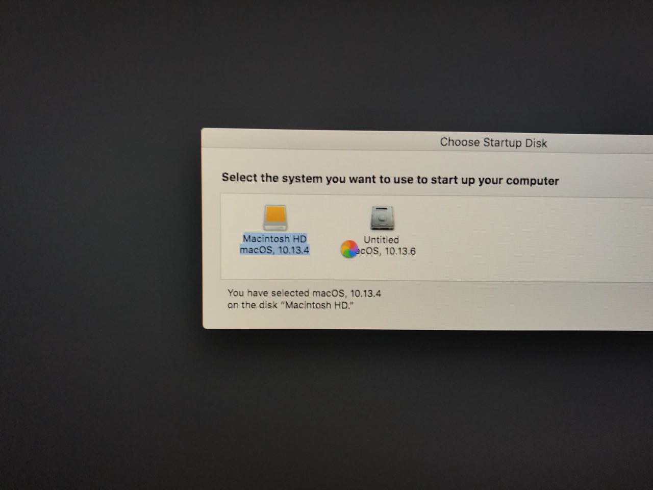

Also what i tried its to connect my broken SSD via USB-to-SATA and enter to recover mode to re-install new HighSerra...the result is the same, it can't be choosen as hard drive for installing(in fact it detects, but you can't do anything there).
If choose as startup, also freezes up 🙁

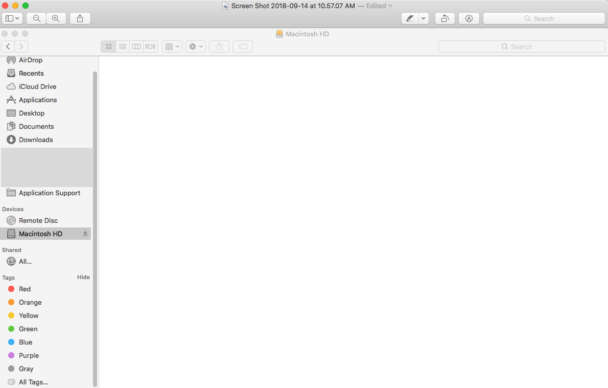

First time when i have connected 'broken' macOS SSD, i got a chance to browse it properly(any folder/any directory).
But now in fact i can connect and only initial folders that are available,if i will jump somewhere there than my finder will die as Not Responding.

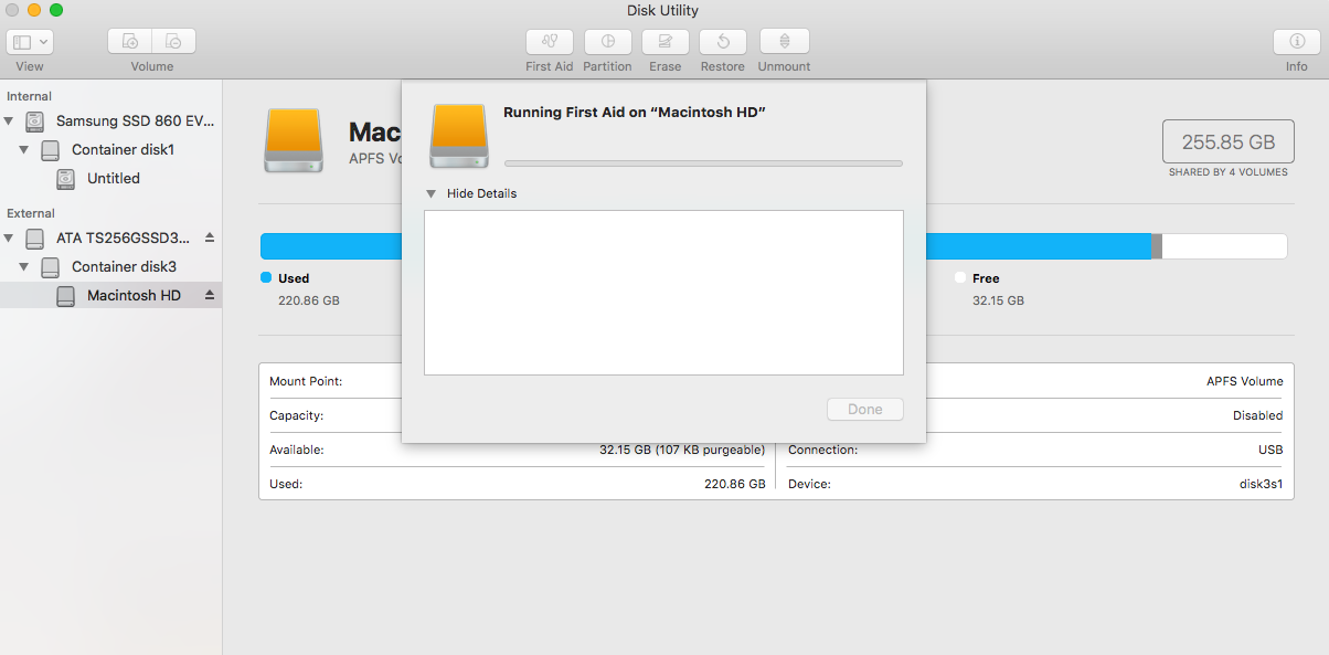

Thanks for fast reply.
I already tried and zero reaction.
Now it's much more worse. When i connect my SSD(honestly i didn't made anything that was like "breaking changes"), i remember that last thing what i have tried it was booting MacOS with connected via Usb-To-Sata adapter and trying to re-install/startup with broken version MacOS(external SSD,the stuff is pretty much described on initial post). Anyway, i didn't manage it, because SSD with broken OS was 'uneditable' and i didn't made anything.
What i'm getting now 🙁 it's that :
1) When connect SSD with broken MacOS (via adapter),it shows nothing

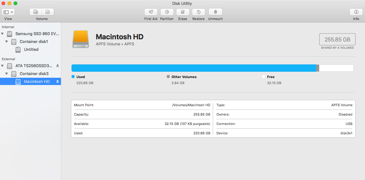

2) What shows Disk Utility now
3) When i tap to "Unmount", there is zero reaction on this button. Just nothing happens now 🙁

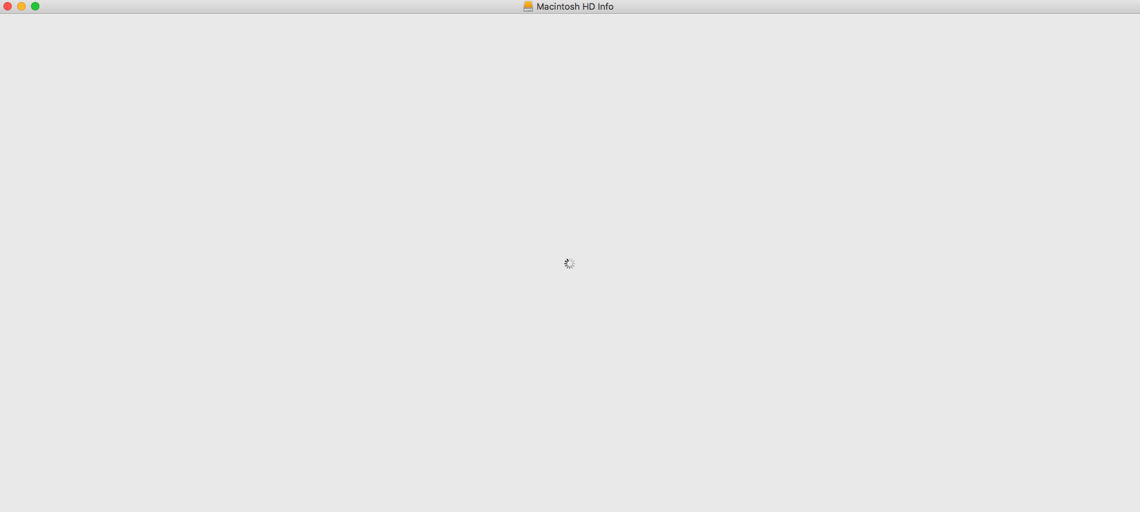

4)When i pressing on info button(left corner),it just shows this
(its like a infinite loading, it can't show now any information that i was able to see 🙁 )
5)First Aid as other guys(zero reaction), like no effect(but's not freezing)
6) what shows DiskUtil in terminal(seems to be it can be unmounted by bash command(?) ) :

PS All is bad now 🙁 ?
