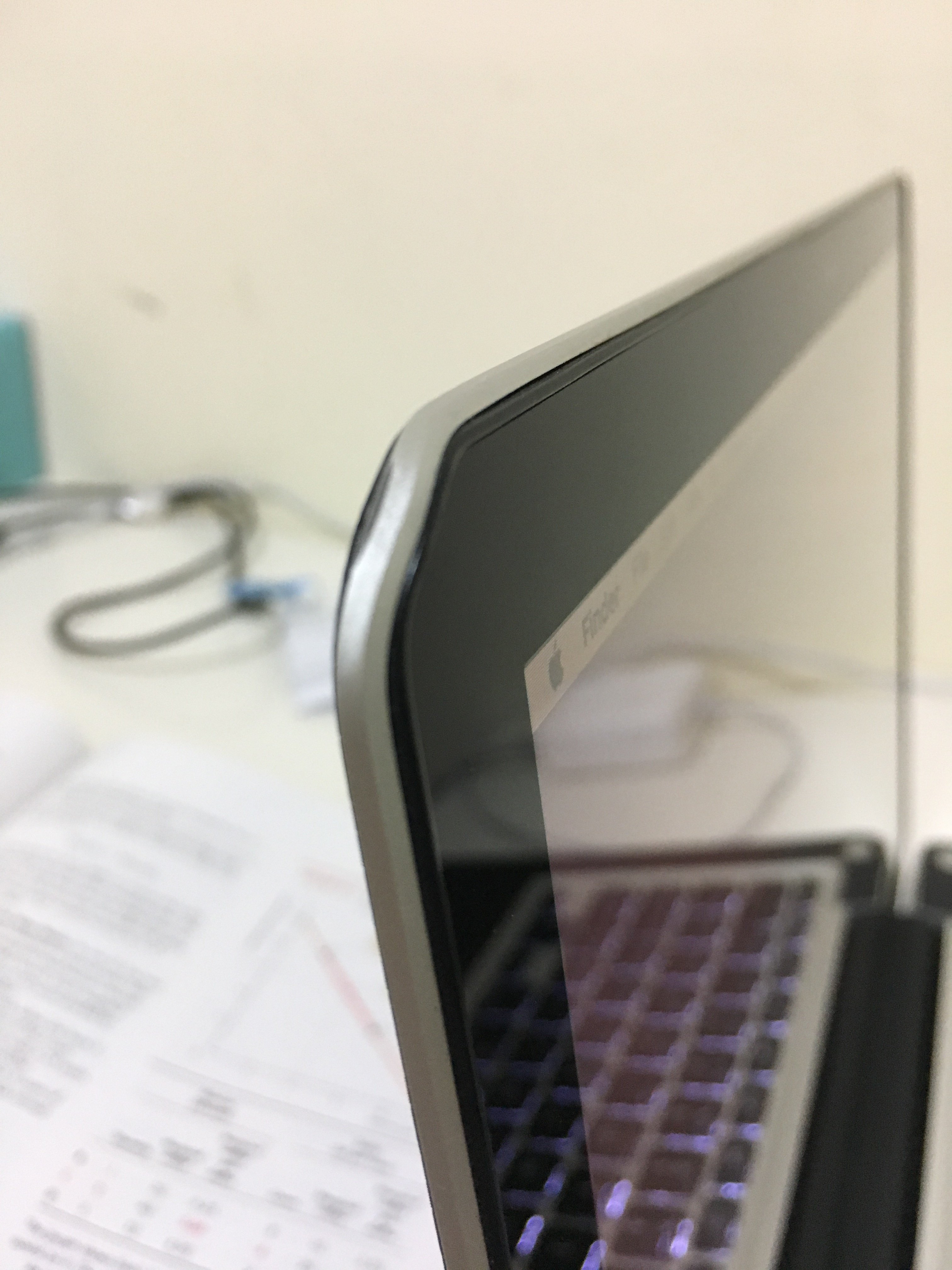

3. My MBP fell on a corner sometime back and so one corner is slightly bent. When I close the lid only the left side (the one bent) of the lcd touches the base while the right side stays like half a mm (or may be even lesser) above the base. It's rarely noticeable unless. Should I take a plyer and attempt to repair? Any1 has any experience?
I do. At university one day, some guy knocked my MBP over and the same thing happened. I took a pair of pliers and bent it back. No problems since.

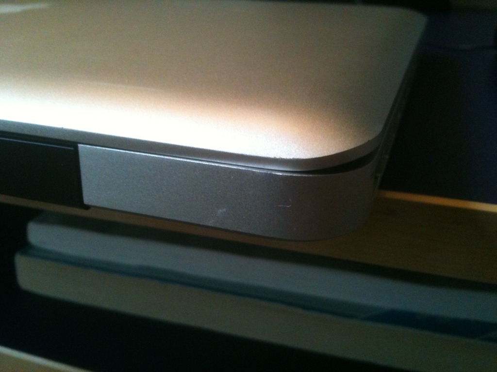

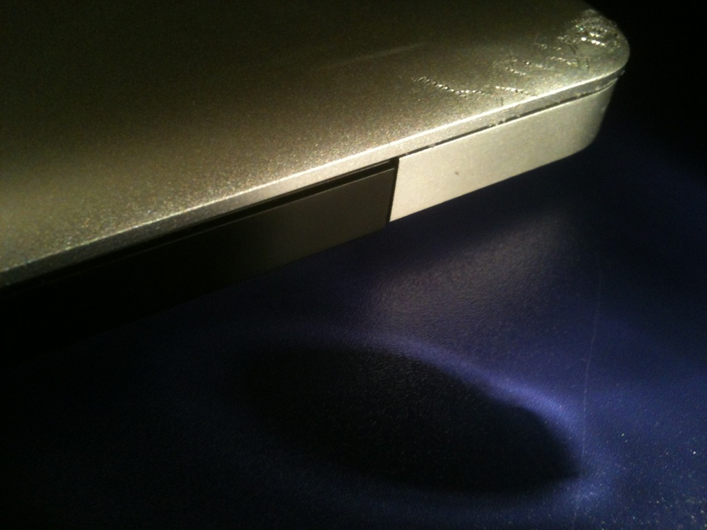

Can you please describe the bend you had and how difficult was it to repair? I'm really nervous doing this repair. I'm scared that I don't damage/shatter the glass. My corner is very slightly bent but I don't know how flexible is the MacBook aluminum.
It is actually embarrassingly flexible. Here's the thread I made back then. That corner still doesn't look pretty, but I got it almost exactly back to where it was. I was initially worried about pressure on the LCD, but two years later, everything seems to be fine.
Here's how it was when it got bent.
And when I bent it back.
