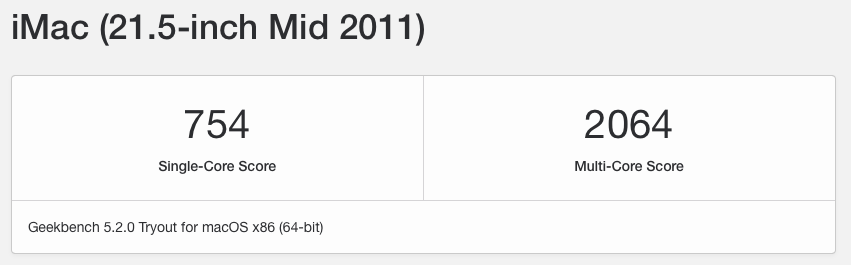

FWIW, My 2011 iMac i5...Native

Keep in mind GeekBench 5's baseline is a Core i3 8100, a 3.6Ghz 4C/4T CPU that scores roughly 1000 in ST (duh, its the baseline) and 3000~3500 in MT, so a score of 830/2800(ish) for non-native code on the A12Z running at 2.4Ghz on only 4 cores is actually pretty damn impressive IMHO.
Does it mean this is an acceptable level of performance for a Mac in late 2020/early 2021? No, but assuming that the Mac chips will be A14 derivatives, that the A14 delivers a measurable jump over the A13, and that they will likely feature more cores and higher clocks/power envelopes vs the A12Z, it's not a bad initial showing. While I'm going to need to see more benchmarks (Cinibench please!) to really come to a conclusion, these initial Geekbench scores are encouraging and Apple at least gets a passing grade for Rosseta 2 in my book (certainly better than I was expecting)
So, these benchmarks are meaningless, being based upon old chips.
That said, 811 average is 73% of native performance for emulated (maybe a bit higher, if 2.4GHz vs 2.5GHz).

So the A12Z, emulating x86, is already as fast as the most recent MacBookAir in multi-thread (although ST for this one is 1070).
Add 20% (A13) and 20% (A14) and the next MBA-ARM is going to be far far faster - and that might be 8C as well!
