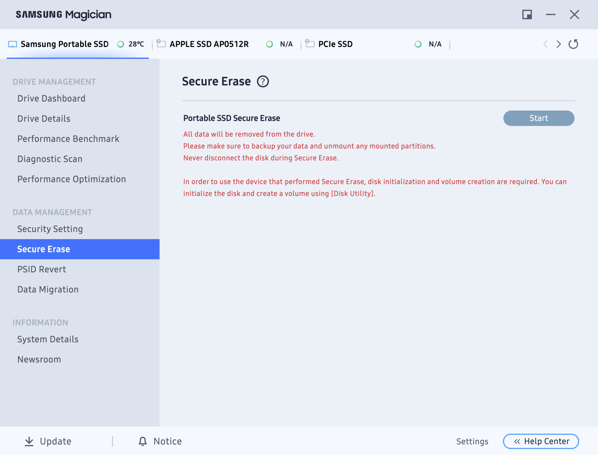

Yes, I think you can. A couple things:
1. AFAIK, APFS encrypts on a per-volume basis, not the whole disk—I have encrypted and unencrypted volumes on my T7 Shield.
2. I'm not using Samsung's software—I agree with Bigwaff about the pitfalls—so I set "Security Mode" to "Disabled" under "Security Settings" in the Samsung Magician software (8.1.0.800). Is that what you meant by "portable software"? I did find that I had to eject and remount my drive after changing settings like Security Mode in the app, or I got an "All Volumes Locked" error. After doing so, I was able to run some diagnostics and performance tests that are possible with the MacOS version of Magician (but some functionality is only available on PC).
3. The "Secure Erase" option is available to me in Magician—perhaps that's a more secure erase than Disk Utility offers, at least with its quick erase function? But if your issue is just wanting to reformat to exFAT, as per above, you can do that with Disk Utility. Either way, Magician is a free download and I believe you need it in order to enable/disable the Security Mode. More importantly, it's what allowed me to upgrade the drive's firmware.
I'm enclosing some screenshots from the Magician app.
Hope that helps—either you or others searching for info, as I was!
