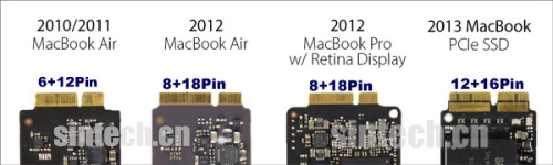

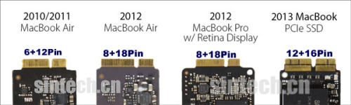

Just for clarification. Only the last one on the far right is PCI Express.

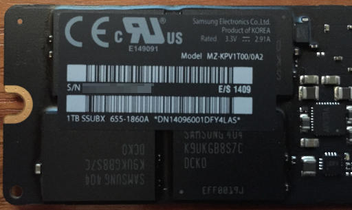

Man, I really want to pick up one of those 1.4 GB/s SSD Blades. That's the MZ-KPV1T00/0A2 correct?
Anyone have any idea when or if we will see another wave of these on eBay?
I got $1K burning a hole in my pocket! 🙂
this just turned up today 😎
...they are a few out there still, just keep an eye open for them.
I heard a rumour of another 20 going on eBay in the next week or so but the downside is the sellers have cottoned on to these now I'm expecting them to be closer to $12-1500 price whilst still hard to find.
Ill do some benchmarking this weekend but I expect it will match the other results on here.

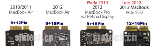

Not mentioned in your diagram is that there were EARLY 2013 rMBP's and LATE 2013 rMBP's.
Early 2013's rMBP's used SATA
Late 2013's (and later) rMBP's use PCIe
Source: http://www.everymac.com/systems/apple/macbook_pro/macbook-pro-retina-display-faq/differences-between-macbook-pro-retina-display-early-2013-late-2013.html
