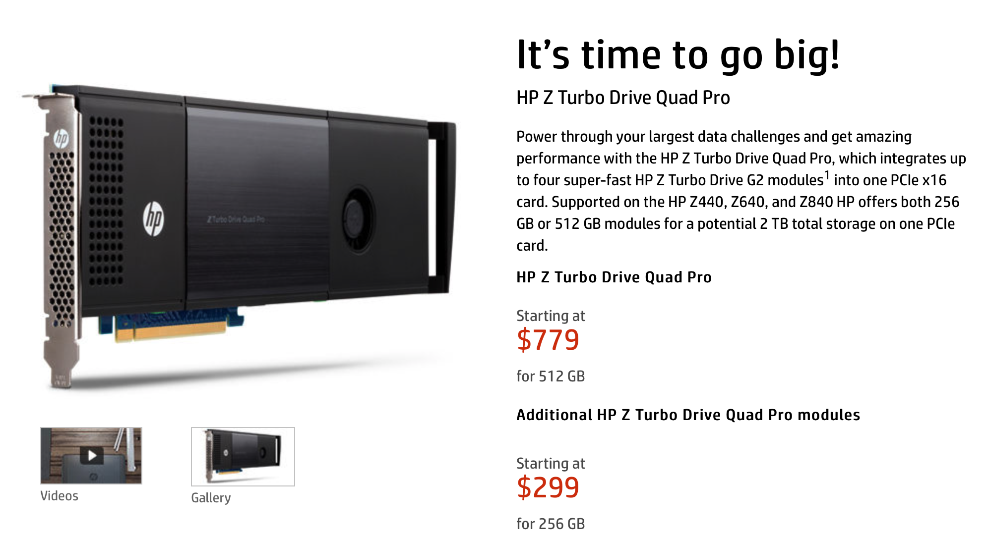

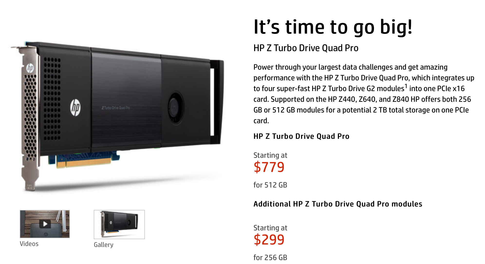

Quad M2 adapter, x16 lanes, with cooling. Should work in Boot Camp for a fast project drive but OSX's partial implementation of NVME might not be compatible.
http://hexus.net/tech/news/storage/88049-hp-launches-z-turbo-quad-pro-workstation-storage-solution/
Looks like a more elegant solution -- even has proper cooling! The price looks good too at $299 for 256GB option. The Amelfec option is around the same price but just for the adapter alone. If only HP have a AHCI compatible version of this thing.
$299 is for the rebranded 256GB SM951 with a HP sticker. HP's website shows options with 2 256GB sm951's as the lowest cost option for 779.00. http://www8.hp.com/us/en/campaigns/workstations/z-turbo-drive-g3.html
german IT magazine "c't" writes that hewlett-packard locked the Z Turbo Drive Quad Pro and it will only work in the hp Z workstations mentioned in the ad. "c't" writes this is because of the special firmware implemented on the card...
