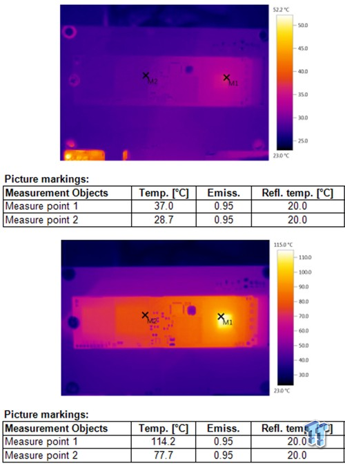

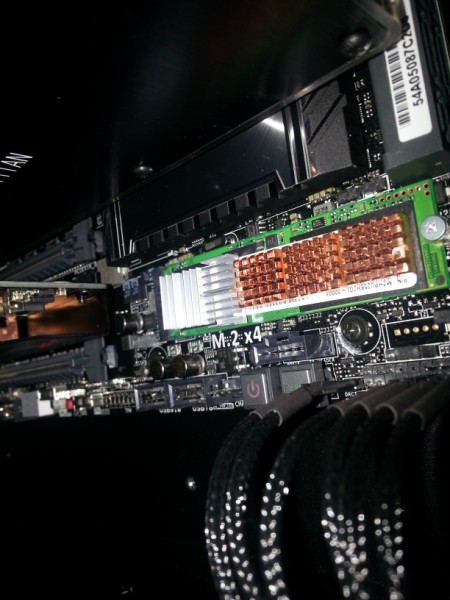

FWIW... The controller is the only thing warming up on the M.2 SSD. $75 seems rather pricey for a thermal solution.
A small piece of thermal tape and a low-cost heatsink should do the trick. While this person was excessive with raspberry pi heatsinks, the temp never exceeds 65c.
Not exactly $75 for the thermal solution. The Lycom DT-120 M.2 Adapter still cost around $30, so the extra $45 may be for better cool, and better protection to the SSD, or may be better looking (compared to a small piece of thermal tape / heatsink). Doesn't sounds too bad for me.

Apparently, tis the season to over-charge for a $15 product. Ouch!! A m+b key adapter can be delivered for less than $10 on ebay. Amazon has rebadged Lycom cards for $23 delivered with prime.
Heat sinks & thermal tape should be under $10 for those needing thermal assurance.
Angelbird seems to learn from the best in selling overpriced stuff (OWC).🙄
Any heatsink which you can attach to the SSD will do, there is no "proper one".
Rest is a matter of look.
