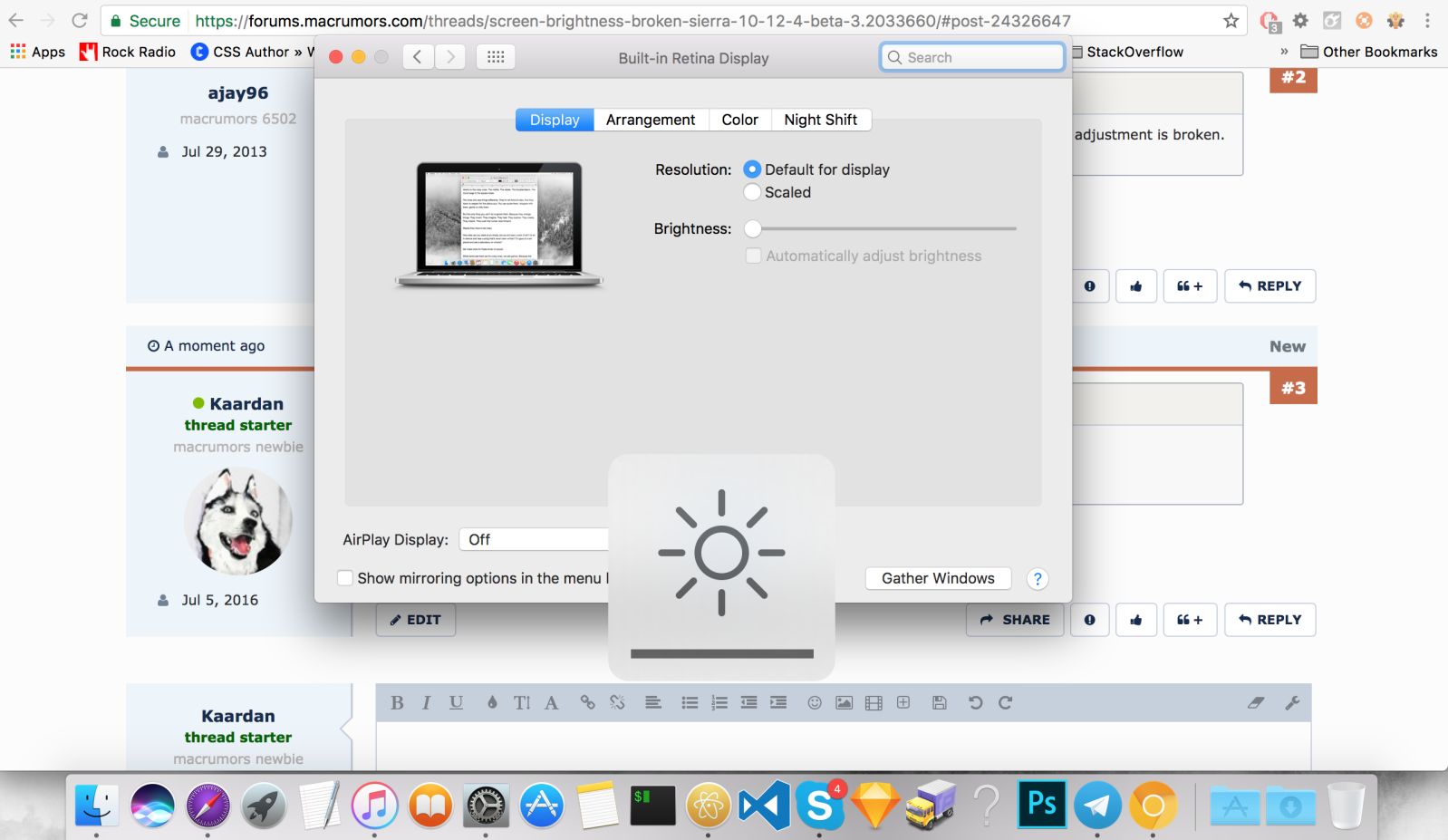

Hello. Can somebody help me. I have mbp pro late 13... Installed beta 3 and my screen brightness adjustment is broken. When I try to adjust brightness nothing happens... only visual changes in brightness controller

Nope.. same result..

Nope. Yesterday I spoke with Apple Support. They recommend me fresh install. That's all Today I created a back up and after work try to fresh install. I reply here if this helped me.

So guys one more moment... I did fresh install 10.12.3 and brightness controller work perfect, after I download update to 10.12.4 MAS. So, what did you think? Right - brightness broke. Let's try fresh install of 10.12.4 eta 40 minutes. I really mad now.
[doublepost=1490824449][/doublepost]So. Fresh install 10.12.4 - brightness not work. Now I even don't have a word.
Update: I spoke with Apple Support one more time. Capture and send them all data and screens... SO
"It appears to be a software issue, with the way we isolated it, if it's a bug it's something that could be fixed in an update but there's still a chance of a setting causing it that can be changed.
Yes, I will keep in contact, I will be the first ot know of changes or responses from engineering. Apologies for the response time, i'm writing up all the details, every little thing you tried and tested has to be detailed exactly."
For now use 10.12.3. That's all guys. Stay frosty.

I found temporary solution for 10.12.4 — Brightness Slider from app store works for me

Which model do you have? I have macbook pro 10,1
Looks like my EDID doesn't recognised anymore 🙁
ioreg -l -x -w0 | grep DisplayProductID
| | | | "DisplayProductID" = 0x717
ioreg -l -x -w0 | grep DisplayVendorID
| | | | "DisplayVendorID" = 0x756e6b6e
ioreg -l -x -w0 | grep IODisplayPrefsKey
| | | | "IODisplayPrefsKey" = "Alias:0/AppleBacklightDisplay-756e6b6e-717"
ioreg -lw0 | grep IODisplayEDID
| | | | "IODisplayEDID" = <00ffffffffffff00000000000000000000000104a5211578026fb1a7554c9e250c505400000001010101010101010101010101010101ef8340a0b0083470302036004bcf1000001a000000fc00436f6c6f72204c43440a20202000000010000000000000000000000000000000000010000000000000000000000000000000d1>​
Can You tell me... The screen changed (repaired)?
I have same Product ID and Vendor
@idoo if you click on the link and read what it is referencing it will become clear. Hint: the bug seems to center around the Ambient Light Sensor and its settings.
