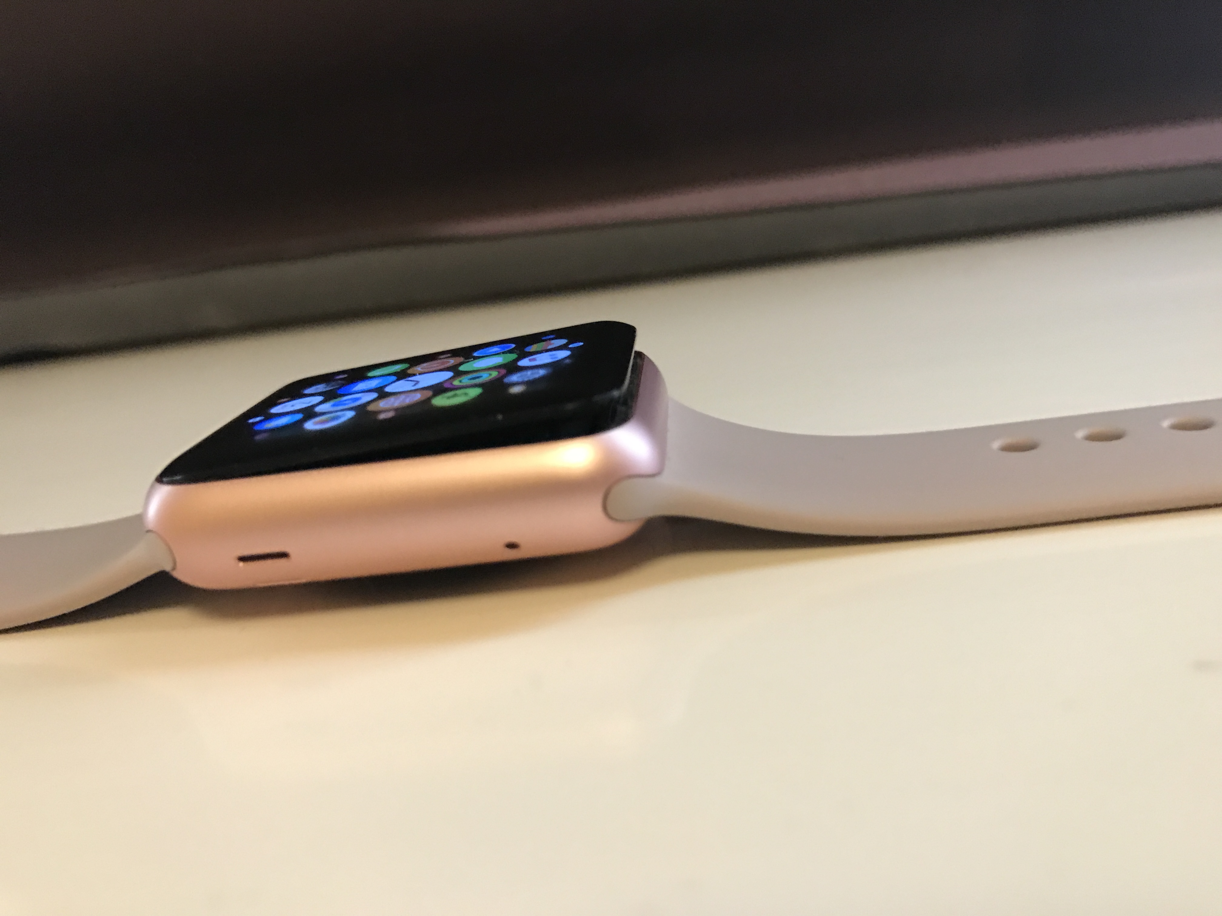

‪Absolutely gutted to take my Apple Watch series 1 off the charger this morning and find the screen has popped off! No damage, no scratches, never been dropped and I only wear it at weekends/workouts so it is immaculate. AppleSupport informed me that due to being out of warranty I needed to pay a £206 service charge... considering a new series 1 watch cost £269 it's safe to say I was not willing to proceed with that . Disgusted that the screen on my watch can just pop off.
Question is where do I go from here as the screen will not push back into position and stay there.

I'm curious if this might be a battery swelling on this one since you state it happened while charging.

That was exactly my thought that something was expanding/shrinking when it was charging.
I attempted to push it back into place but it just pops straight out again.

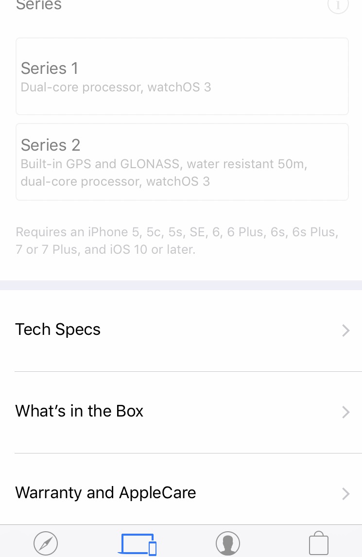

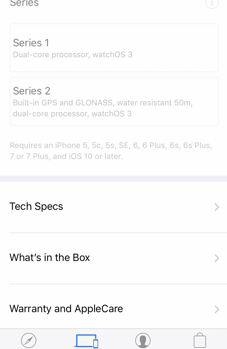

Must be different in the UK then as we started with the Series 1 and the newest version is Series 2View attachment 694583
You really should be listening to Julien. Both Series 1 and Series 2 were announced at an Apple event on Sept 7, 2016.
It's not possible for a Series 1 watch to be out of warranty.
49 minutes into the event they tell us about Series 1
http://www.apple.com/apple-events/september-2016/
You couldn't even pre-order it until Sept 9th. You have at least another 5 months before anyone with a Series 1 or 2 can be out of their one year warranty.
You have the original Apple Watch, which we've all been calling Series 0.

Ok so thanks for clearing up that my watch is one of the 1st generations, still out of warranty and still has the screen hanging off.
In case any of you were interested I had a good look at it internally and found the battery was bulging... how I did not see this before I do not know.
The expanded battery is preventing the screen from sitting back in position.
I have ordered a new battery to replace myself.
At least the hardest part of removing the screen has already been done for me!

That makes sense why the display popped off with the battery bulging. Good luck with the repair and let us know how it goes.
