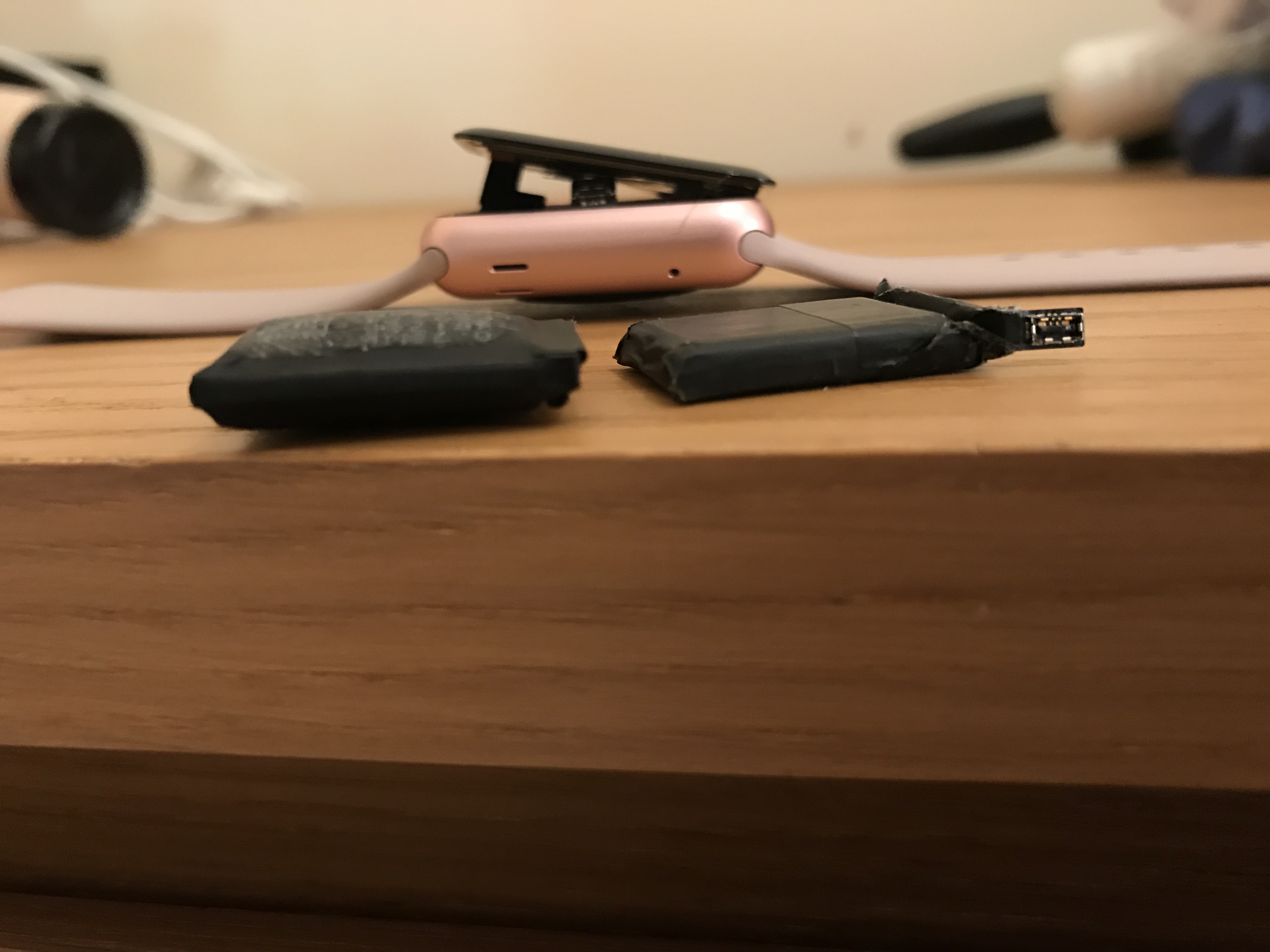

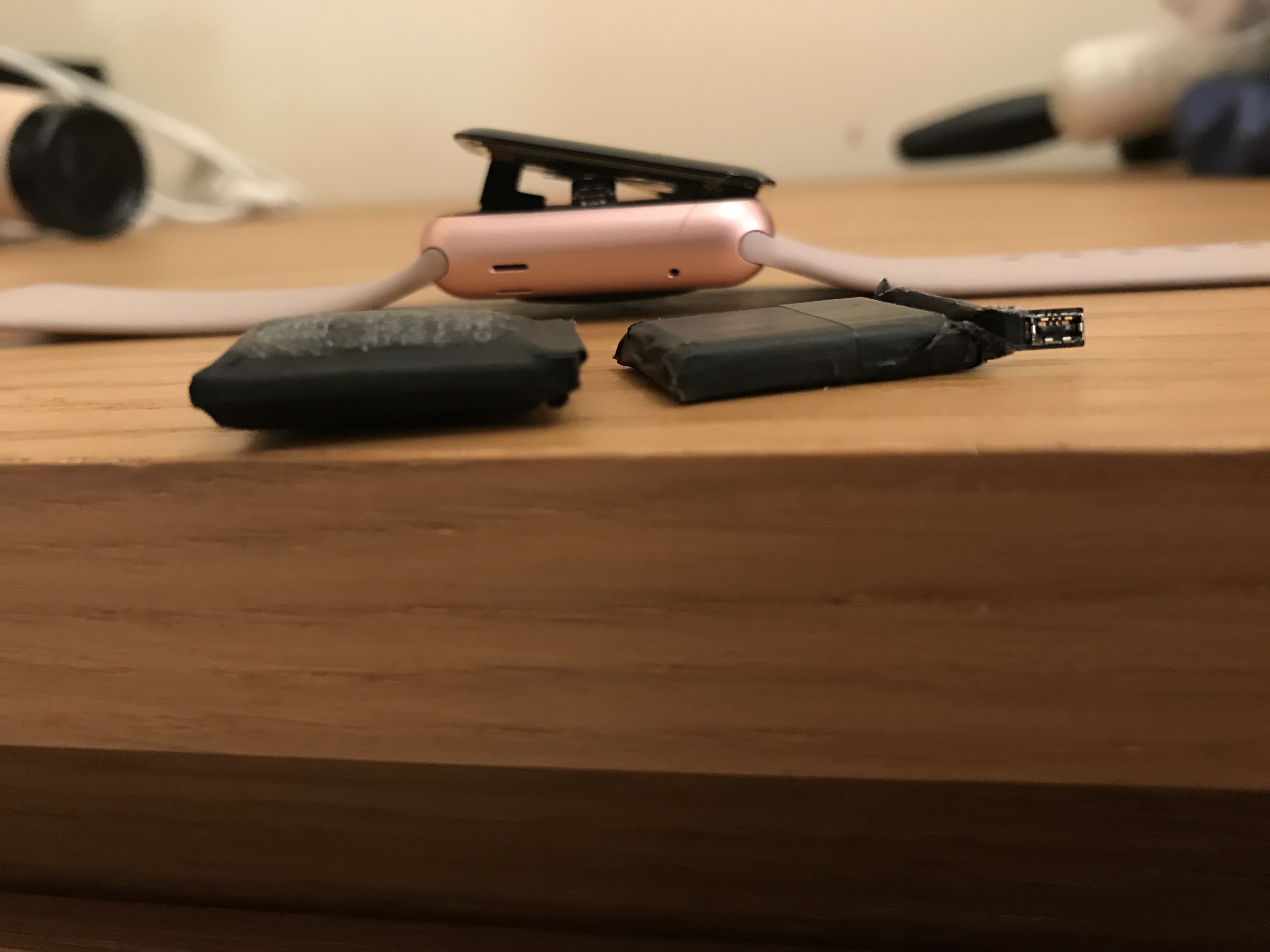

I hope you get more luck with Apple, I gave up the battle and resorted in repairing it myself.
Here's a photo of the size difference between my expanded battery and the new battery.
Very clear to see why the screen did come off.

I did send my photos of the battery defect to apple support but probably saw it as I had removed the screen and tampered with it instead of taking my word for it that I found it popped off. I just got quoted the £206 service fee everytime and from what I've learnt for a series 0 original watch is ridiculous.
I've resulted in repairing the watch myself.

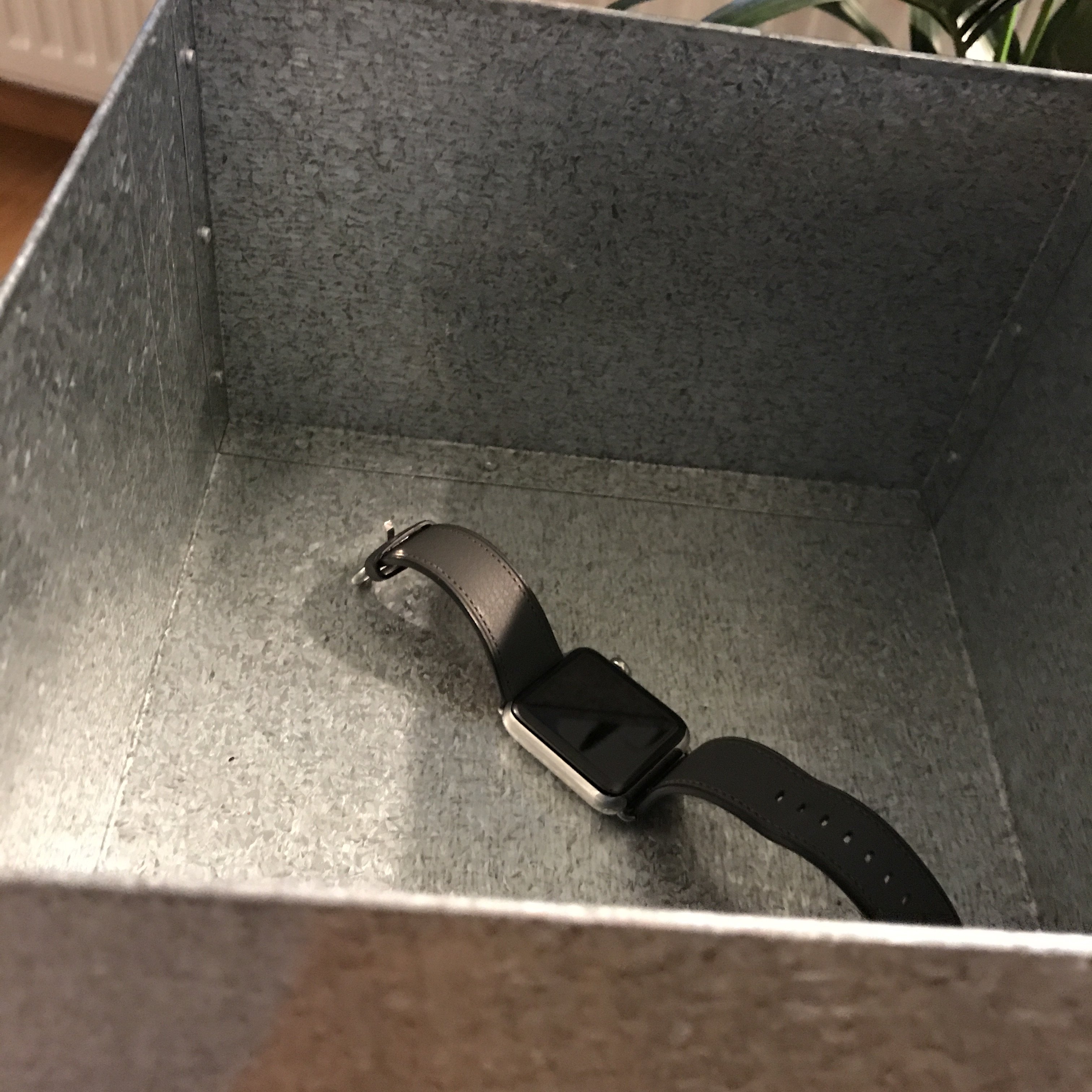

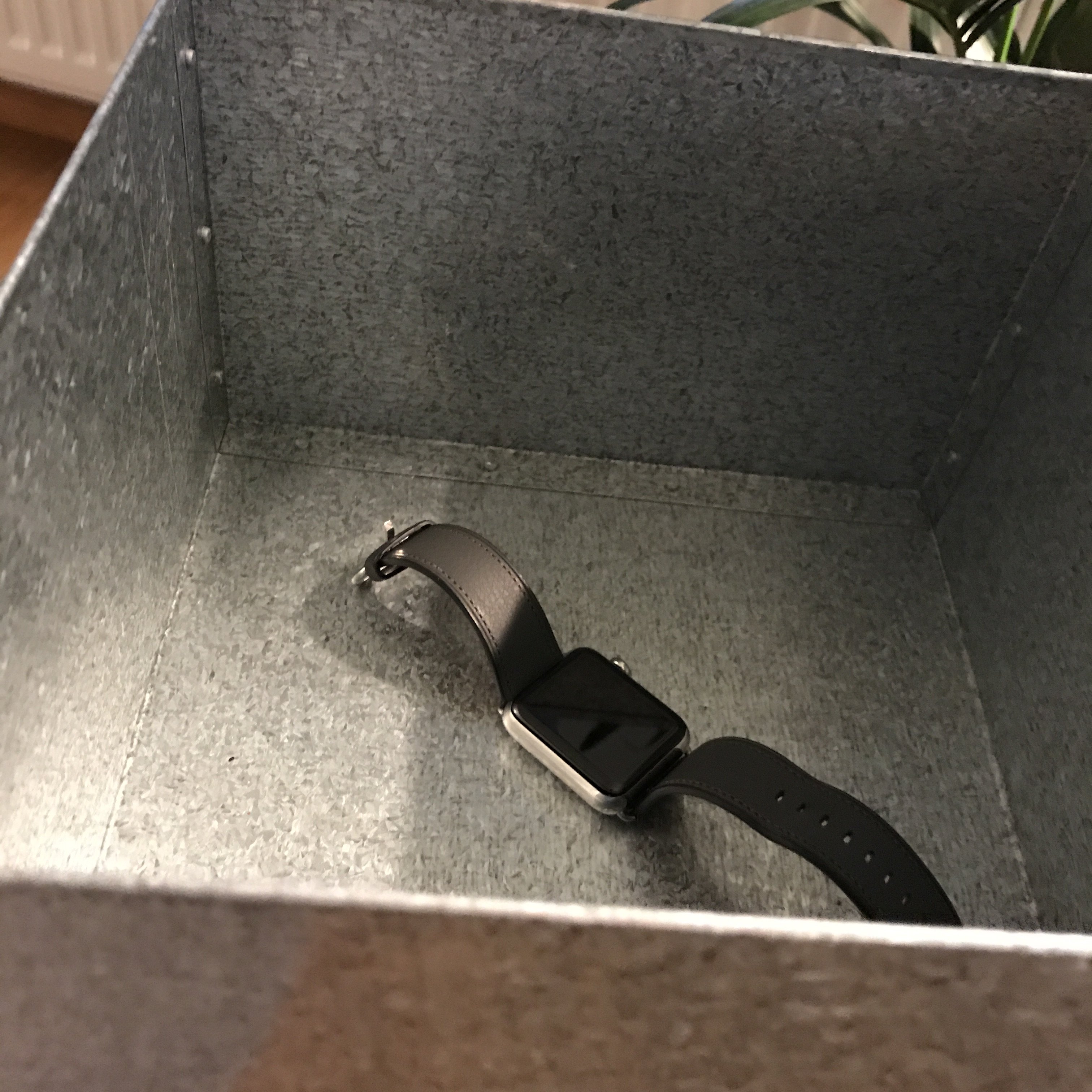

[EDIT] Safety: swelling watch in a box! Probably overkill, but better safe than sorry... Now if only I had a webcam to document the process (whatever happens) in real time... :D

I paid £9 for a new battery which has been very successful (currently wearing the watch now).
