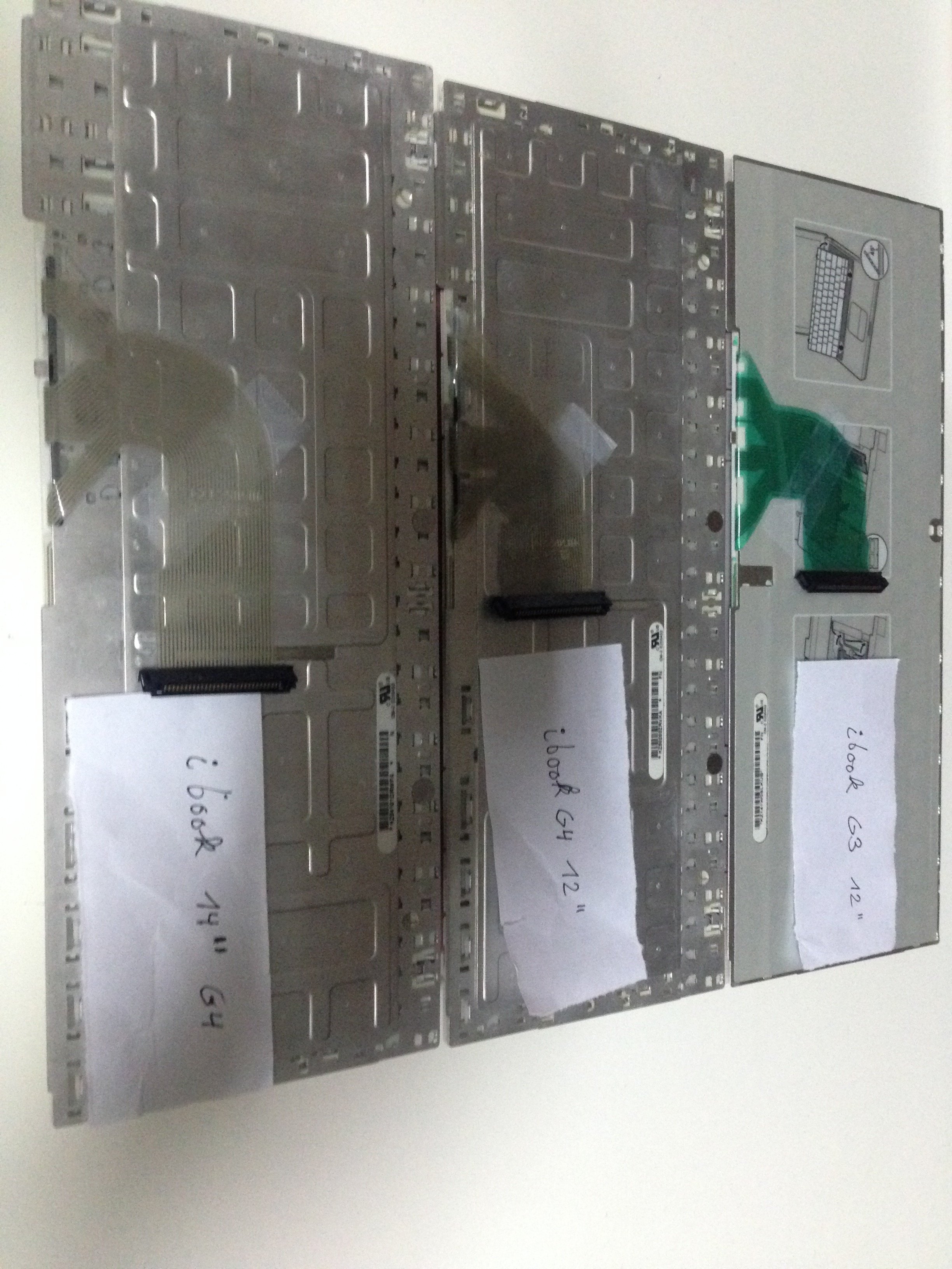

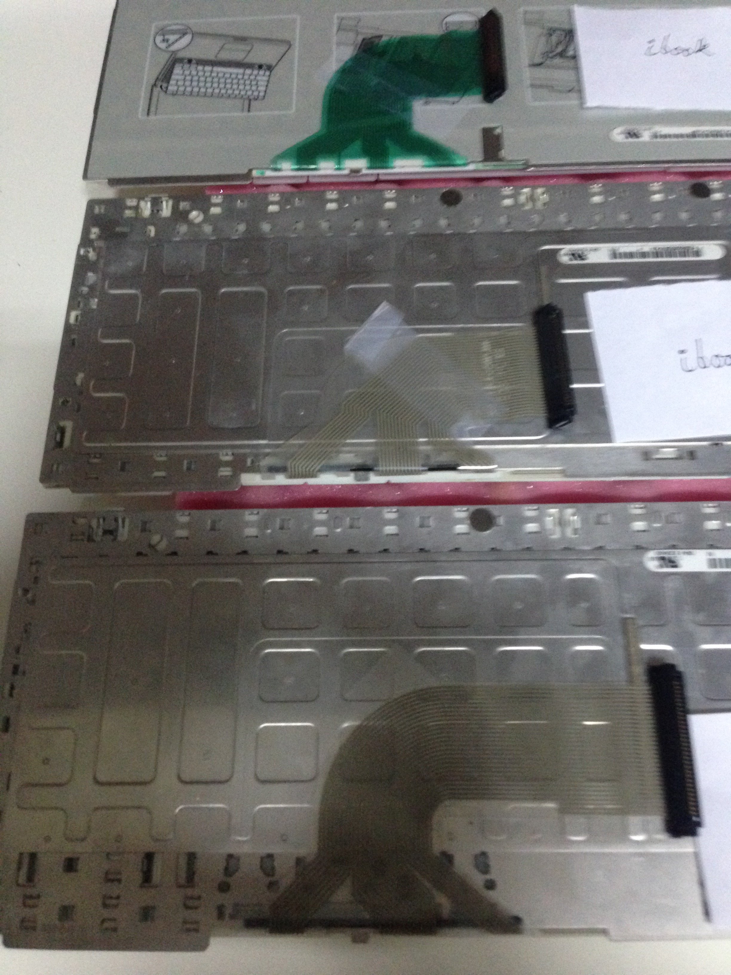

Day 9 , at last the keyboard for the 12" iBook G4 arrived and it fits, no more bulging cable underneath the spacebar.
So tomorrow the iBook G4 12" goes back with me on the train commute for a real test-ride .

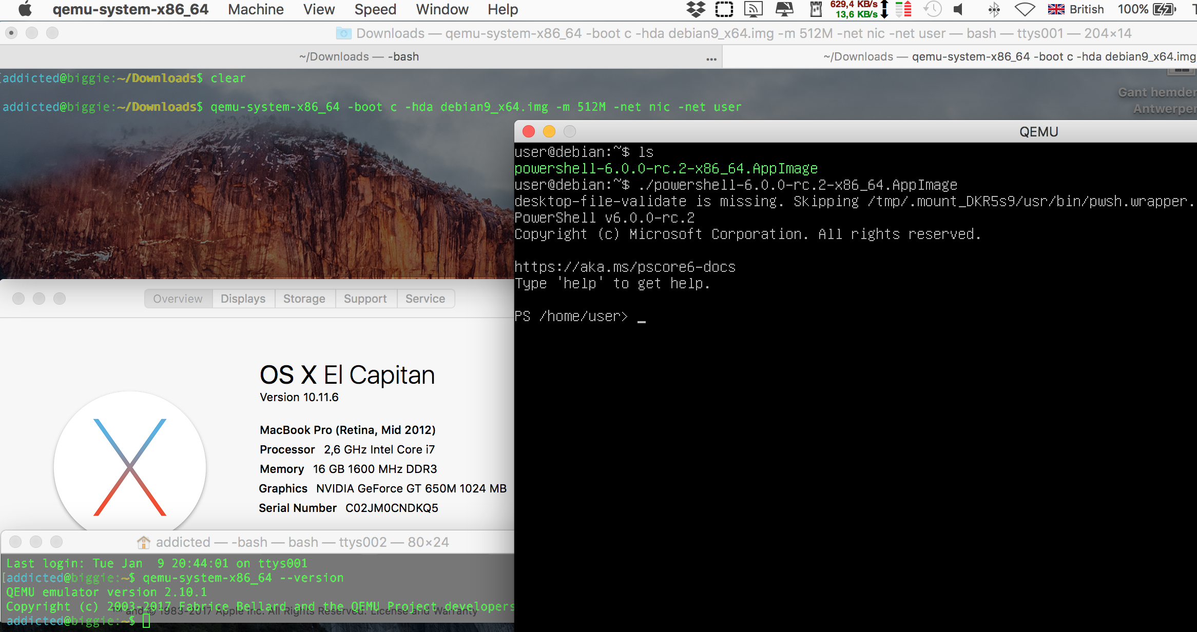

I decided to install Debian 9 netinstall minimal (textmode)+ssh via qemu-system-x86_64 on my MBpr to speed things
up, well after 2 hours 🙂 and installing fuse and sudo and wget to retrieve the All-in-one PowerShell image , it's working

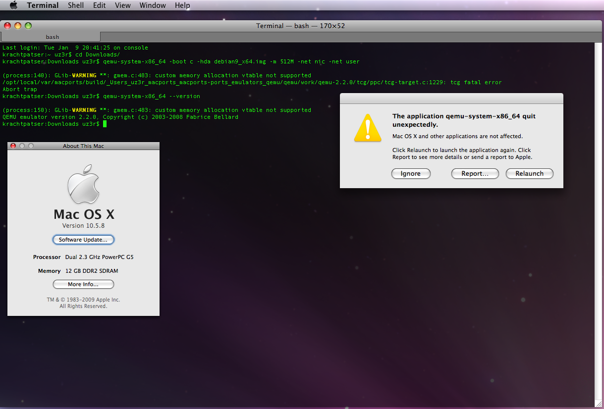

I tried on the G5 also with the same parameters -m 512M -net nic -net user but it keeps crashing once it gets to the login
start process , also on the G4's.
I have uploaded the qemu image if anyone with qemu on PPC Linux or OS X Leopard wants to give it a try, I wonder
if qemu 2.9.0 on PPC Linux would be able to start it ?
Here is Debian 9 minimal text console install ,SSH server with root (toor) and 1 account user (user) , fuse and sudo installed, PowerShell is in the home directory :
2 GB Qemu diskimage !!!
https://www.dropbox.com/s/xb11zfnvyozh28s/debian9_x86-64.tar.gz?dl=0
Thanks for preparing the Debian image. I got the same result in qemu 2.2.0 on Leopard. I didn't try Tiger though I imagine the same issue will be present.
I had qemu 2.10.1 installed in Ubuntu 16.04 on my G5 (11,2), but I hadn't built it with x86_64 support, so I downloaded the 2.11.0 source, unpacked and recompiled:

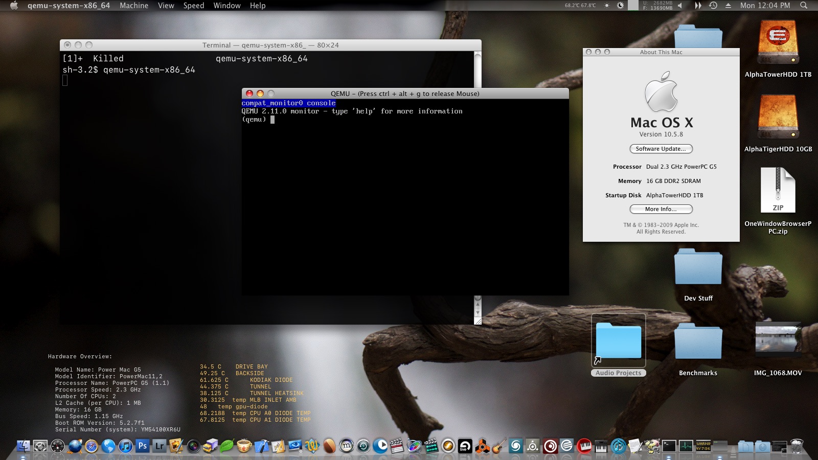

I updated the cMP 3,1 running El Cap with the latest qemu 2.11.0 (via Homebrew) and pitted it against the G5.
Booting with the same config from command line 'Enter' to the Debian GNU/Linux 9 login prompt:
- Mac Pro 2x 3.2Ghz Quad Core: 1 minute 6 sec
- Power Mac G5 2.3Ghz Dual Core: 3 minutes 58 sec
One little bonus is that qemu 2.11.0 on the G5 (Linux) now boots Mac OS 9.2.2 universal. This is something that I couldn't get to work previously. It refuses to boot OS9 with KVM enabled however and SMP is still not an option, so it's not exactly fast, but it does work. (Classic in Tiger is still the best option for OS9 on a G5).

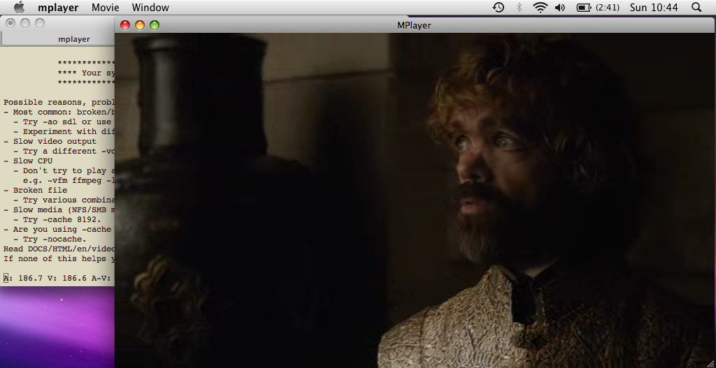

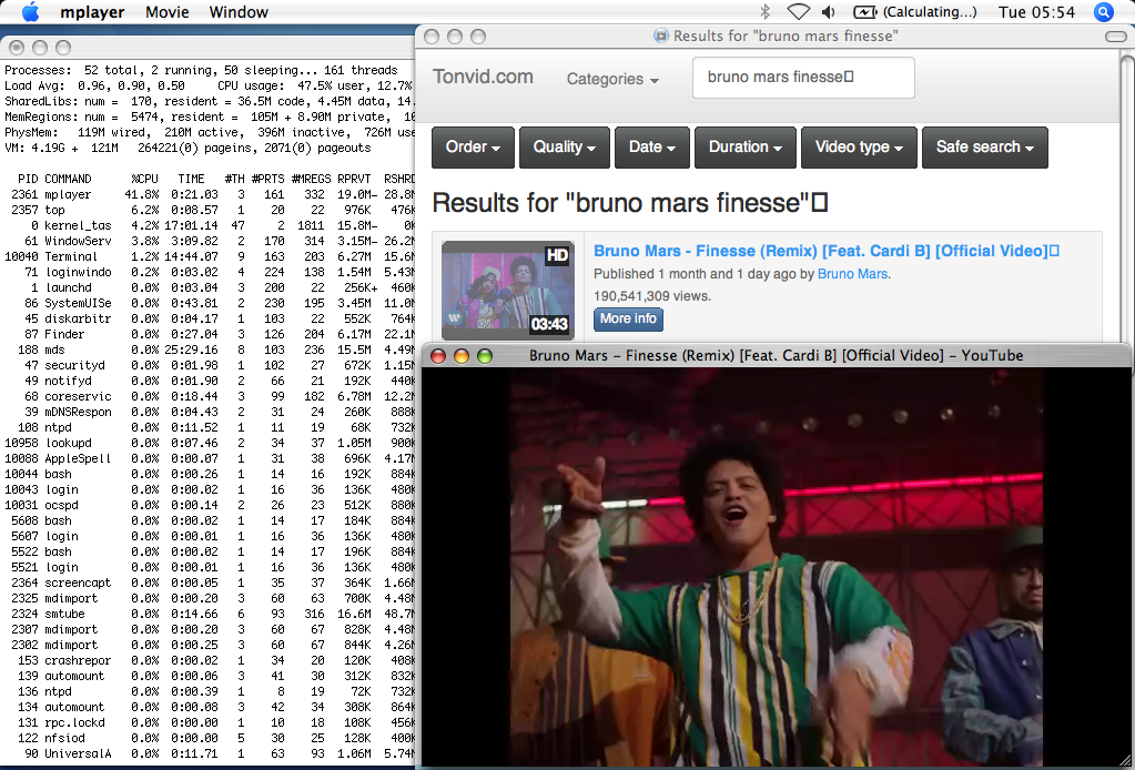

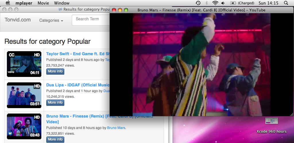

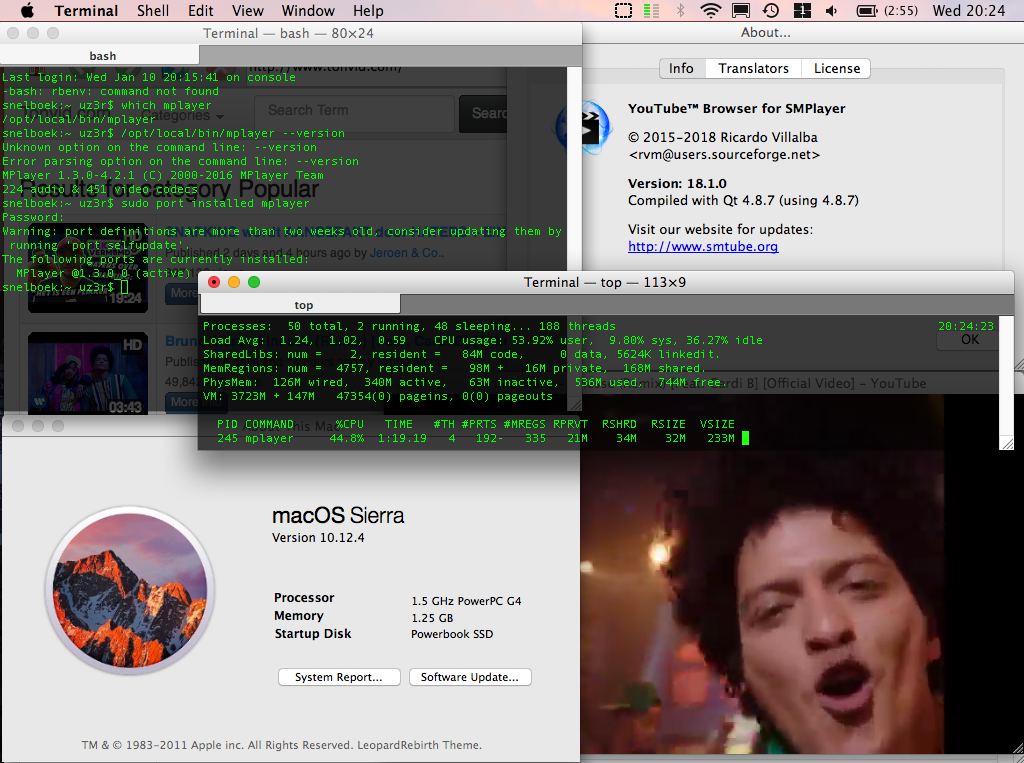

Correct, I use mplayer 1.3.0 from Macports , I could have sworn that I tried VLC this morning but you are right VLC no longer works.
mplayer 1.3.0 still does , PB G4 12" Better Performance on battery, 360p playback
I remember that I once created a mpkg for mplayer 1.3.0 on the G5 but it didn't work on your DLSD.
So I'm now creating the Macports mpkg installer for mplayer 1.3.0 again on my PB G4.

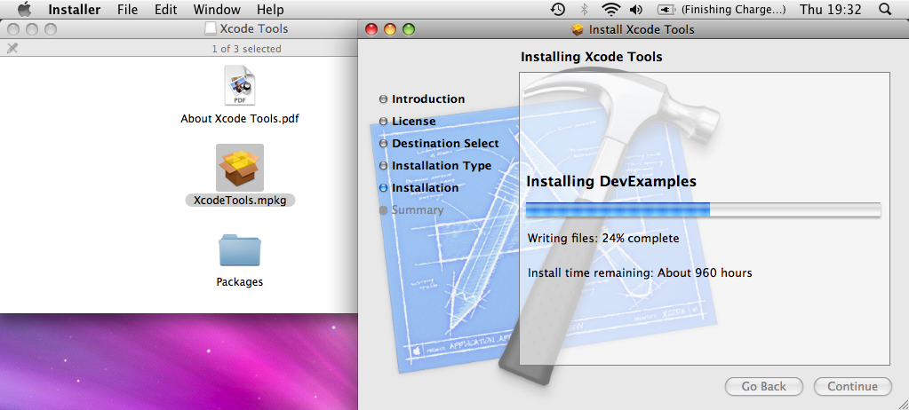

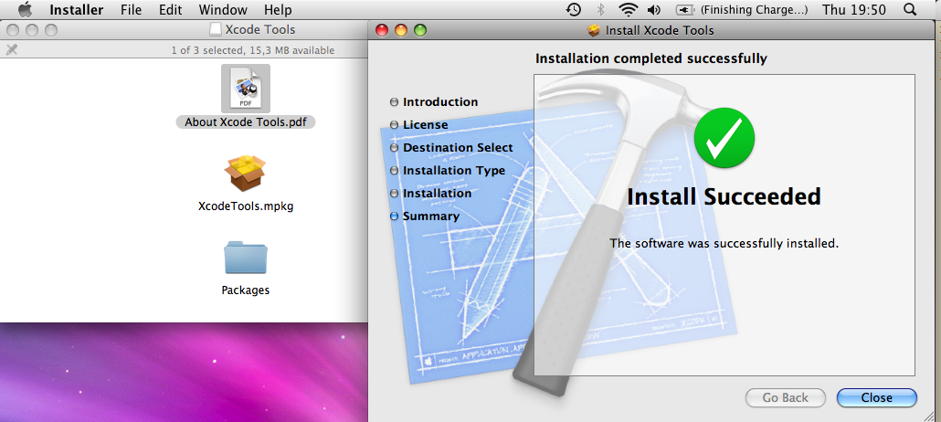

So from Thursday to Friday I installed Xcode 3.11 and Macports 2.3.4 on a PB G4 12" in order to reproduce the install of MPlayer 1.3.0.
Xcode 3.11 seems to have a different understanding of time , maybe because it came from 2008
960 hours in 2008 = 18 minutes in 2018

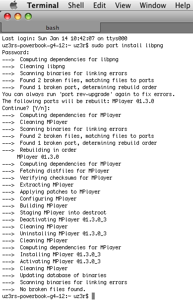

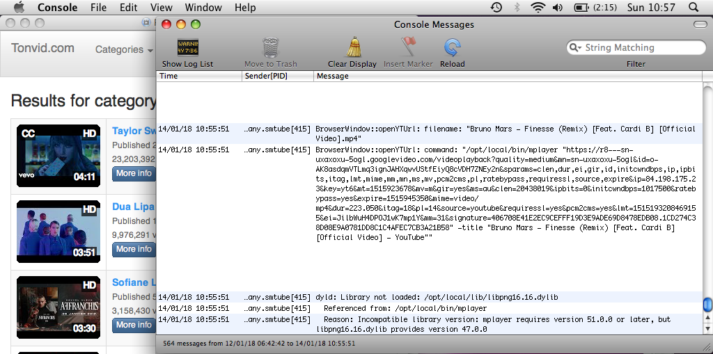

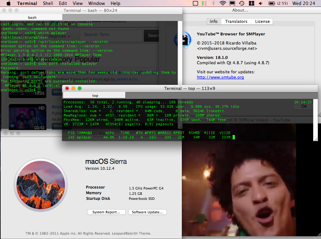

Sunday morning installed qt4-mac and SMTube 18.1 but MPlayer wouldn't work bizarre enough, so I opened Utilities/Console and found the culprit, for some reason there was a broken dependency altough MPlayer worked when playing video files.
So tried to reinstall libpng sudo port install libpng which indicated that MPlayer was broken and started the build again.
Et voila, SMTube 18.1 with MPlayer

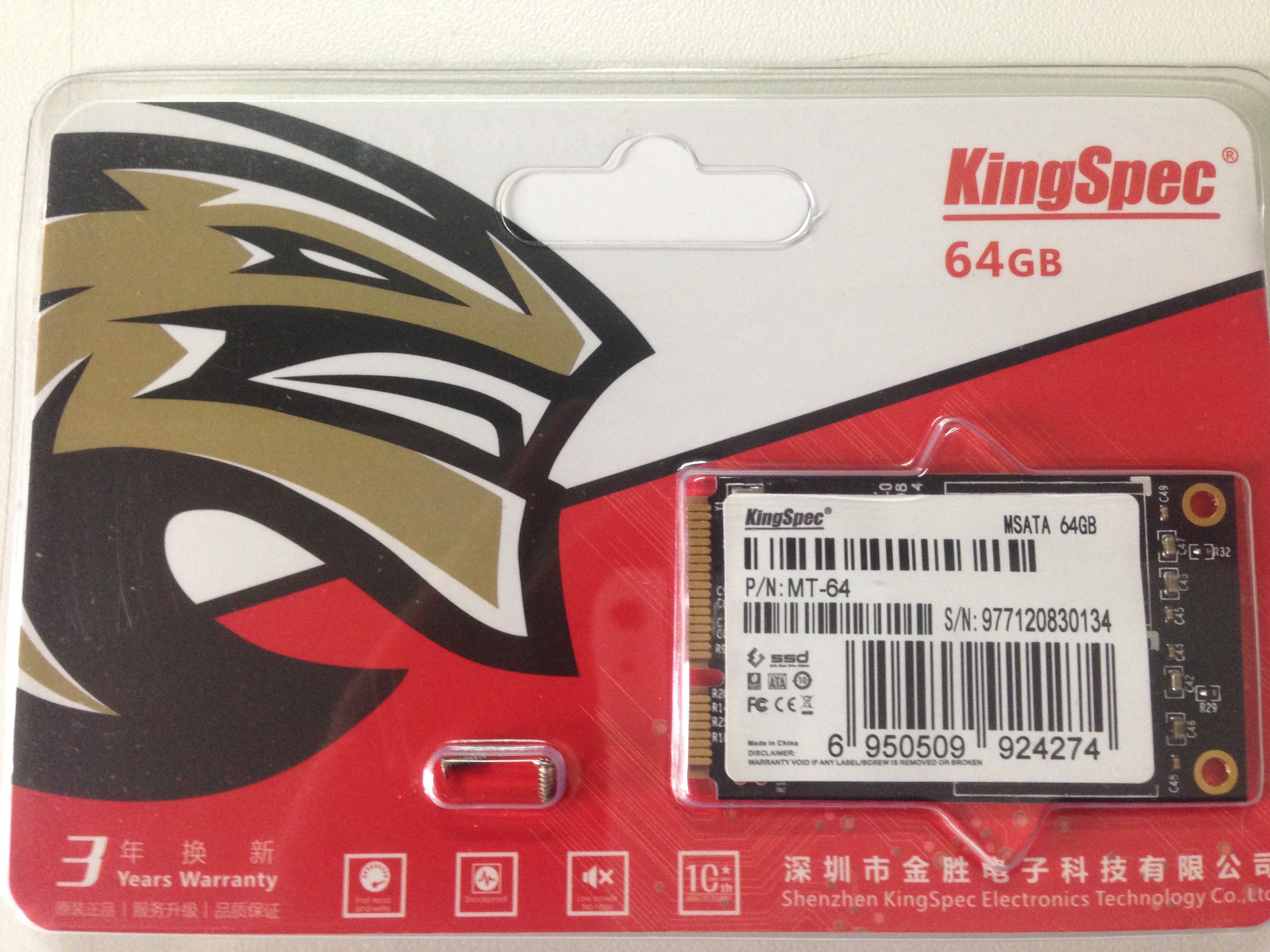

Apart from that I've ordered an KingSpec mSATA SSD for my 2nd PB G4 12" 1.5 Ghz so I can compare it to it's sibling with a PATA SSD.
Just picked it up from the post office, waiting on the mSATA IDE adapter and Thermal Pads + CPU paste to arrive to teardown and rebuild my 2nd PB G4 12" 1.5 Ghz .

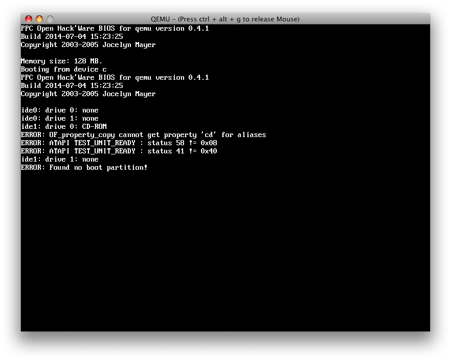

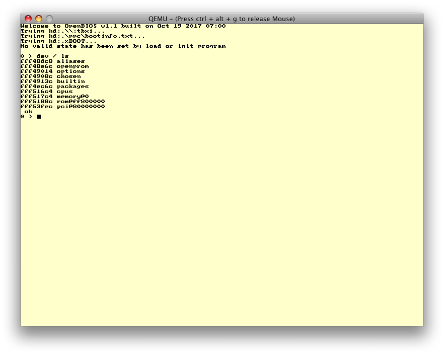

I then ran through the process of installing again (with both the path_array edits to ui/cocoa.m and the added strnlen() function in dtc/libfdt/fdt_ro.c )
I can now fire off a ppc or ppc64 vm, but it fails to load OpenBIOS and just bombs out with Bus error when loading a vm img.
EDIT: I have been able to get two different "BIOS" screens to load so far;
qemu-system-ppc64 -M g3beige
and
qemu-system-ppc64 -M prep
Both of them refuse to go any further than this and won't even get this far when run through the ppc emulator (non-64). At least seeing this, we know that the ppc64 emulator can load it's BIOS in certain cases, but the x86_64, i386 and ppc emulators aren't doing so well.

I don't think this is where the problem exists though. I just tried building a vanilla source from https://download.qemu.org/qemu-2.11.0.tar.xz
first: sudo port deactivate qemu
Then;
Code:
unxz qemu-2.11.0.tar.xz
tar xpf qemu-2.11.0.tar
cd qemu-2.11.0
vi ui/cocoa.m  <--- made path_array changes at 2 lines
vi dtc/libfdt/fdt_ro.c <--- inserted strnlen() function below #includes (+ prototype declaration)
mkdir build
cd build
../configure --prefix=/usr/local --cpu=ppc --cc=/opt/local/bin/gcc --objcc=/opt/local/bin/gcc --host-cc=/opt/local/bin/gcc --python=/opt/local/bin/python2.7 --iasl=/usr/bin/false --enable-cocoa --target-list=ppc-softmmu,ppc64-softmmu,x86_64-softmmu,i386-softmmu
make -j4
sudo make install

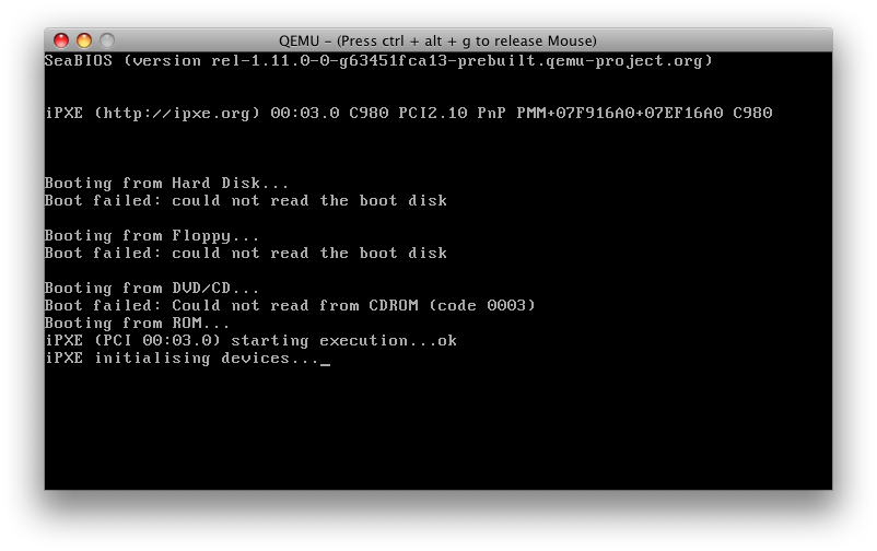

I was then able to get SeaBIOS to load on qemu-system-x86_64 but still no luck with loading an img file (Bus error).
Maybe it's the block driver causing issues? Seems that as soon as an image file is loaded it stalls and then falls over.
(Note: this build seems to have broken the ppc64 BIOS loading which was "working" before).
Good news, qt4-mac 4.8.7 using @XaPHER hint compiled and works.
I was able to compile SMTube 18.1 on Tiger.
I'm now installing MPLayer 1.3.0 on Tiger which will probably take another day looking at all the dependencies it's pulling in.
In the meanwhile my Renkforce mSATA -> IDE adapter arrived, waiting on the thermal pads to rebuild my 2nd PB G4 12" 1.5Ghz.
Back to QEMU 2.11 via Macports , thanks to all the work by @AphoticD , I tried again but I have a similar experience , it hangs.
Too tired to keep digging for today, will let Tiger purr further on MPlayer , hopefully I can create a succesfull mpkg of qt4-mac and MPlayer 1.3.0 on Tiger afterwards.
A quick update
MPlayer 1.3.0 via Tiger Macports 2.4.2 completed so I quickly checked SMTube playback before heading off to work.
480p playback seems only feasible on Charger , Better Performance (Tried 720p on both Better Performance Battery / Charger )
qt4-mac mpkg completed just before I left, so now MPlayer is building it's package whilst I'm gone.

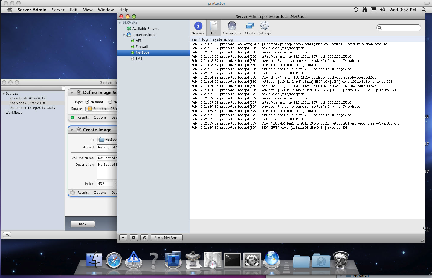

But today's endavour , Netboot.
Since I was tired of restoring CCC images during 2 hours each time on my PB's to start
with a clean install (no Xcode/Macports) and I have an Xserve G4 with no current use, time to turn OSX 10.5 Server into a NetBoot Server .
It was fairly easy to setup and boots to a clean install Leopard (10 Gb image) in 3 minutes but it only seems to succeed if I switch my firewall off on OSX 10.5 Server.

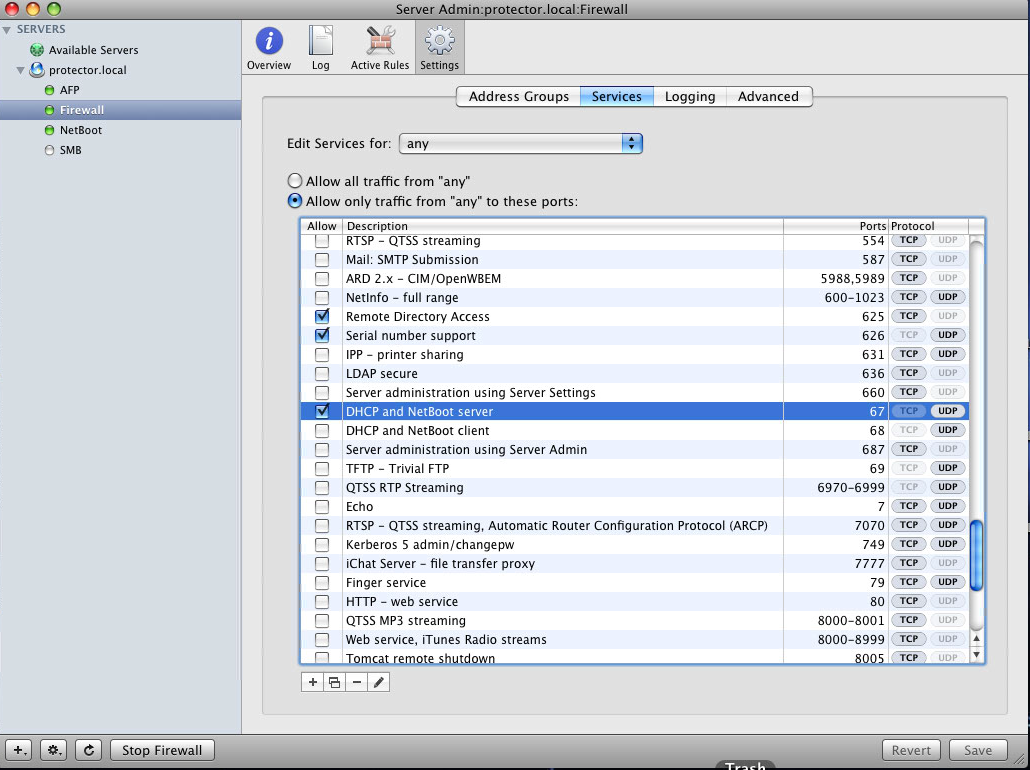

I tried adapting the Firewall Setings for allowed Services by adding :
NFS
DHCP and NetBoot Server
but no avail , it does the same Bootp steps and then time-outs and starts from the local SSD.
I could sniff the traffic on the source (Powerbook) and receiving port (G4) but maybe anybody has an idea ?
To my current understanding anything I save on a NetBooted machine , isn't saved after a reboot ?
Diskless NetBooting uses RAM for it's shadow file instead of the local disk or is there another difference between regular NetBoot and Diskless Netboot ?

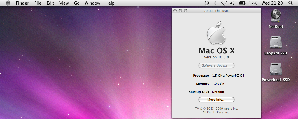

Day 41
In the meantime I figured out that setting a Netboot Image as Diskless will keep the changes done to it since the shadowfile remains on the server.
However still have to disable the OS X 10.5 Server Firewall in order for BSDP to succeed.
