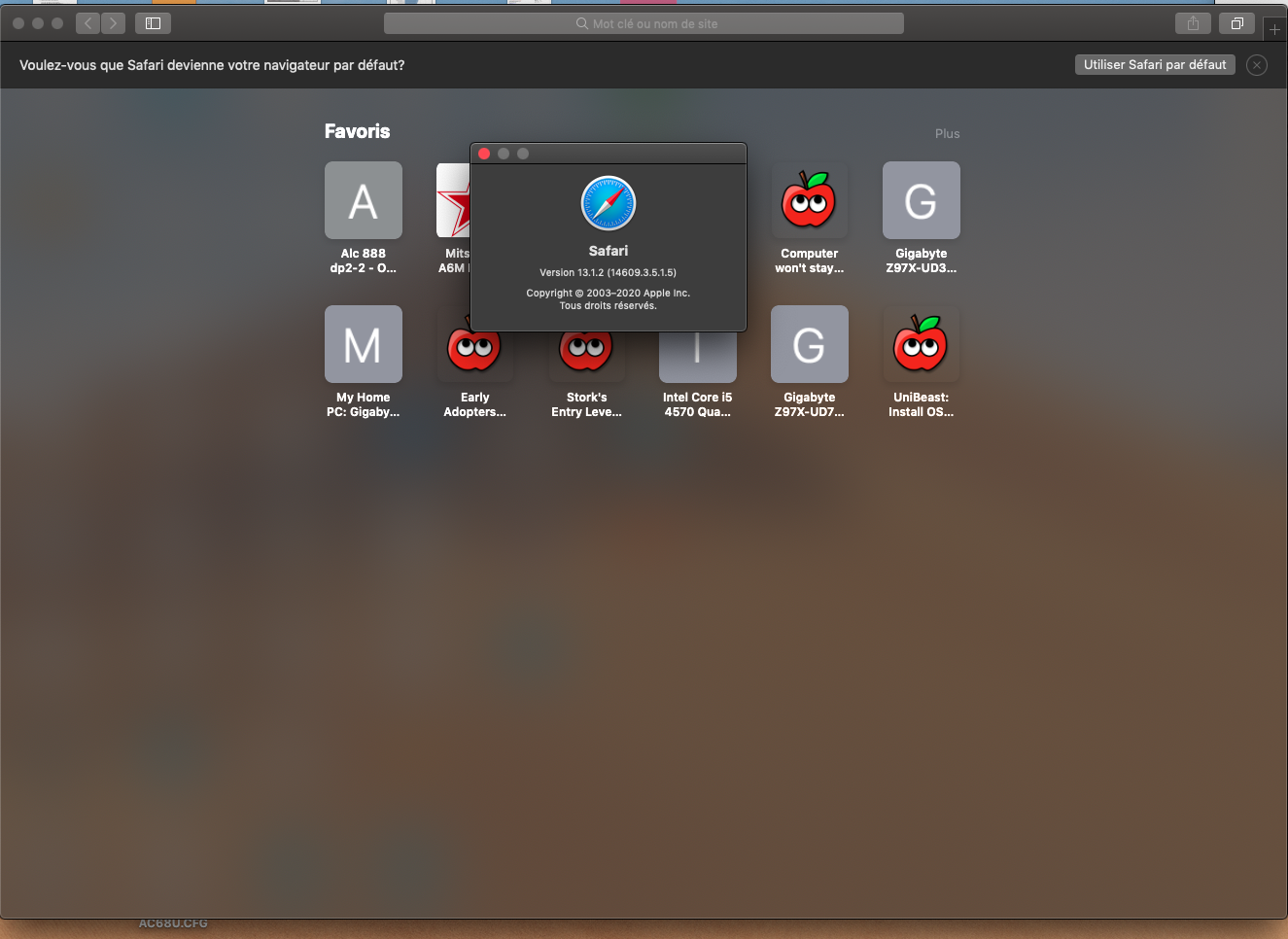

Ah ah! Uninstalled Safari 14 via AppCleaner (checked all elements). Reinstalled Safari 13.1.2 via Pacifist. This is on my "test drive" with 2020-005 installed BTW.
Ran:
Code:
sudo update_dyld_shared_cache -root / -force
Memory usage is back to (it seems to me) much normal amount, maybe a tad higher than before update. WindowServer is back to under 100mb.
And...cDock works again!

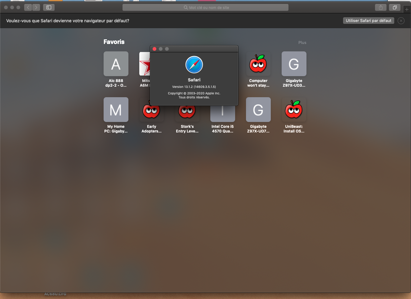

Ran:
Code:

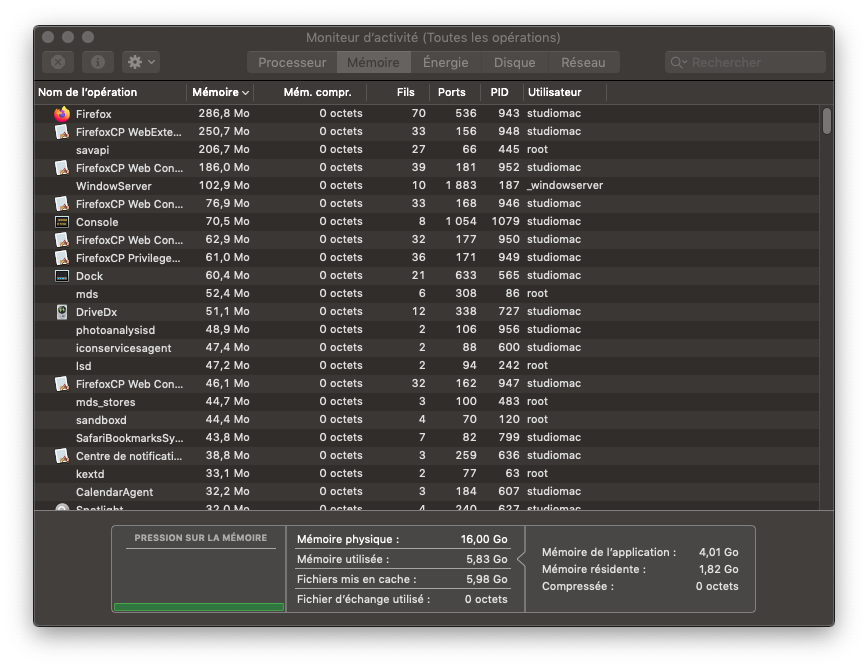

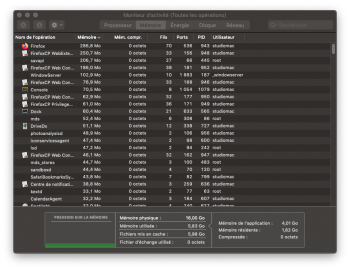

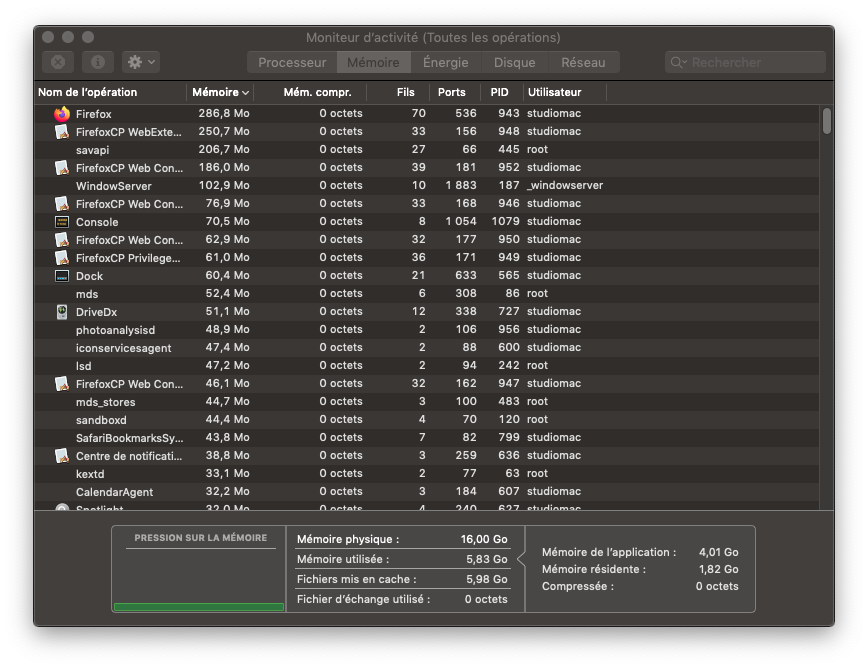

Now, after a pass of Onyx cleanup, memory usage is down to what it was prior to 2020-005!
