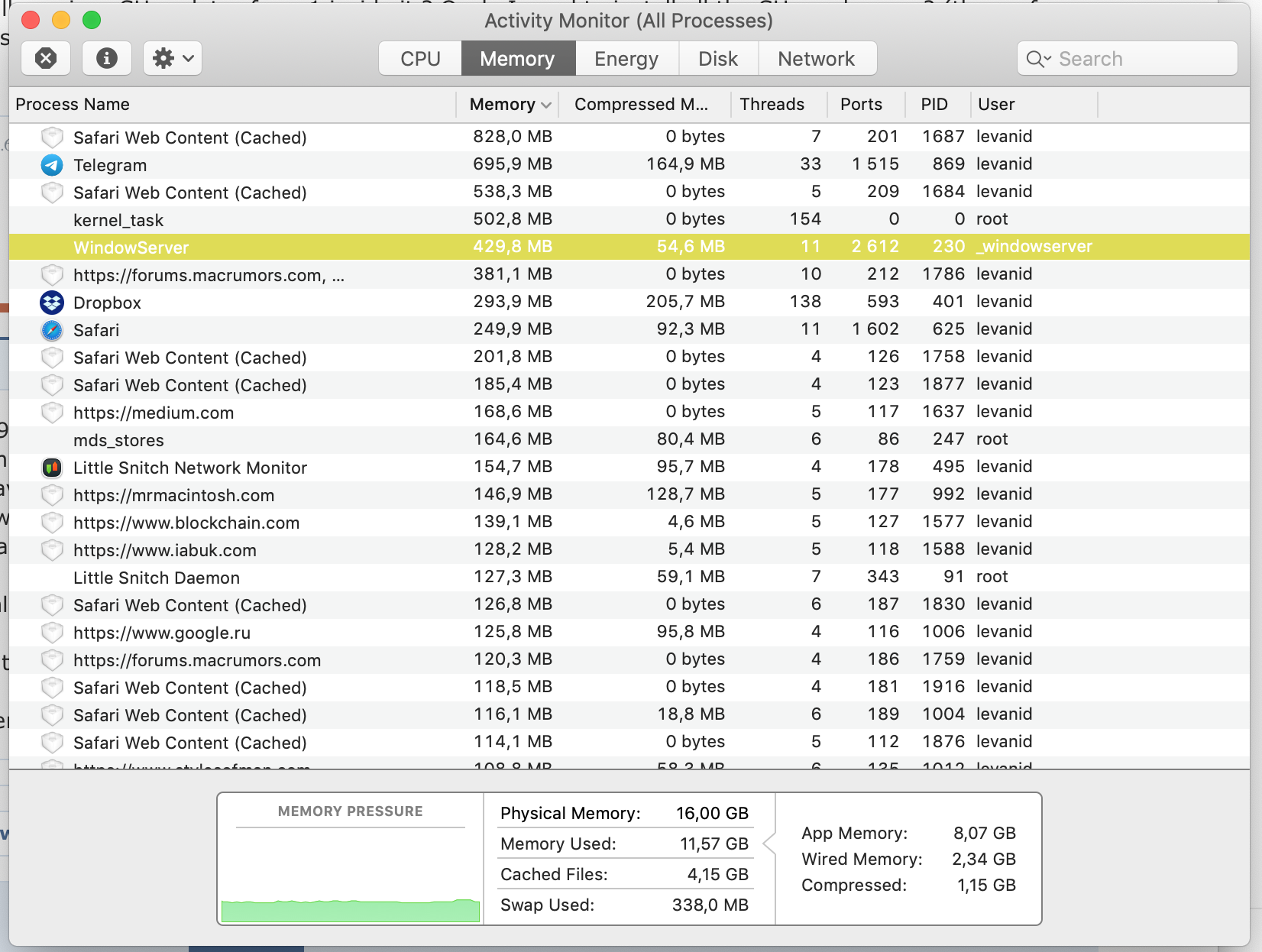

Do you just have Safari open?
Try it with just one tab to see how much memory is used.
Your compressed is very high.
