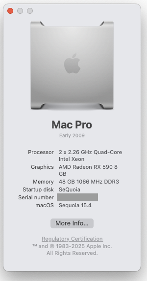

Sequoia 15.4 and OCLP 2.3.2
Reactions: AlexMaximus
Did an experimental install of 15.4.1 on my cMP 5,1 today, using OCLP 2.32.
Have not had a chance to try much out, but at least I got it installed and booting.
I've tried twice to use Migration Assistant to move my Monterey configuration over, but it's stuck in a "boot loop".
So, will start from scratch and see how it goes.
UPDATE: The clean update from scratch seems to be the way to go. And so far, seems pretty stable. Compared to what I read about earlier versions of Sequoia running on 5,1 hardware, this seems pretty good. OCLP even has my original Mac Pro Wifi card working....I haven't upgraded that yet in this machine.
