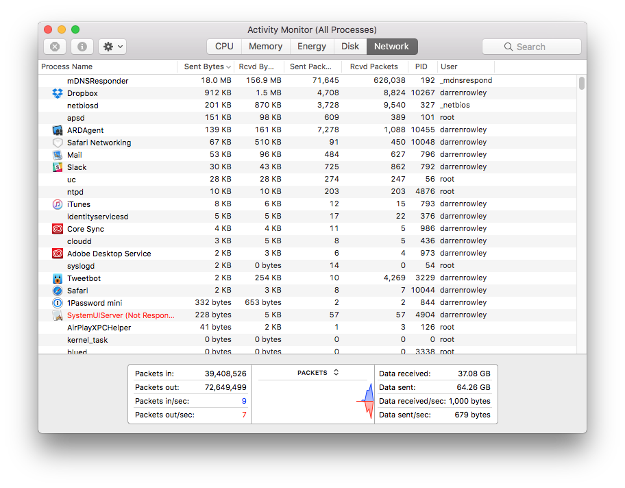

    I also have this happen. I did find a process in activity monitor which was not responding, and killing it will cause the clock to reset. I don't remember the process name though. If it happens again, I'll reply back with the name.

    It happened as soon as I got on my iMac. The process that hangs is SystemUIServer. As soon as I kill it, the clock restarts.

    You got it, that is the process! Fixed everything right away! The same process also caused by battery indicator to say that it was plugged in (electricity symbol) and at 100% battery. Killing this process fixed date, time, and battery indicator. Nice catch!
