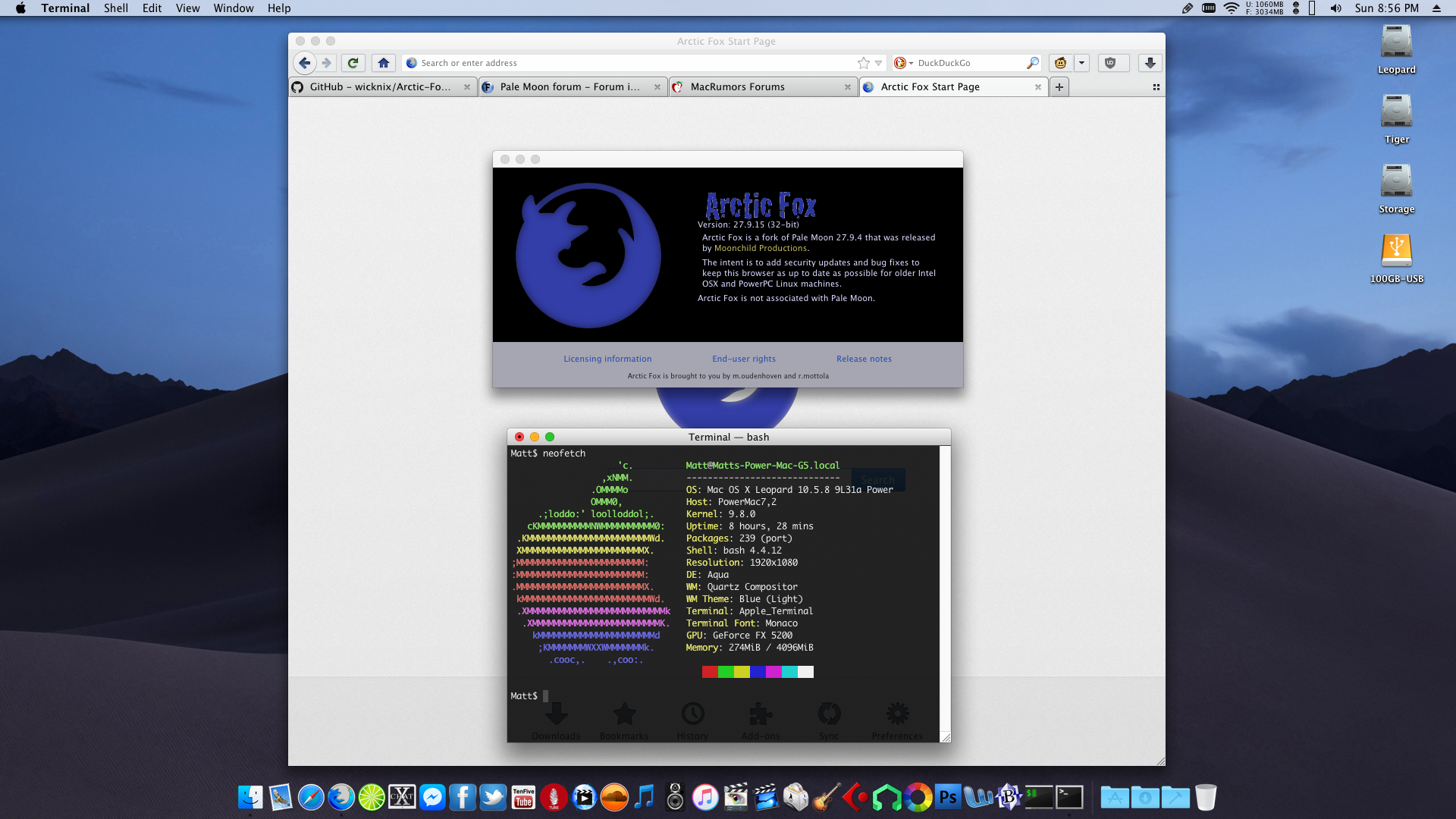

I've been picking away at this for awhile now. It works, mostly, and it's far from 100% complete, but it does browse the web. Mainly i have a few UI / Menu bar issues to look in to, and initial profile creation seems to barf, so i just created a new profile in 10.6 and copied it over.
For the eager beavers out there i packaged up a "work in progress" build if you really want to play around with it. Please read the README file in the archive. It explains what works, what doesn't etc. Please don't report bugs on the arcticfox thread or on github. It's not supported, and it may never be supported on ppc mac. Only time will tell.
I want to thank the Aurorafox/Tenfourfox devs for their patch sets. Without those i would have given up long ago. Anyway, just remember, it a WIP, it's partially broken, and it's not supported, and it may never be.
The binaries/libs aren't stripped, so the uncompressed archive is about 200mb.
If you have macports and macports gcc installed grab this package.
If you don't have macports installed, grab this package (thanks Traace!)
