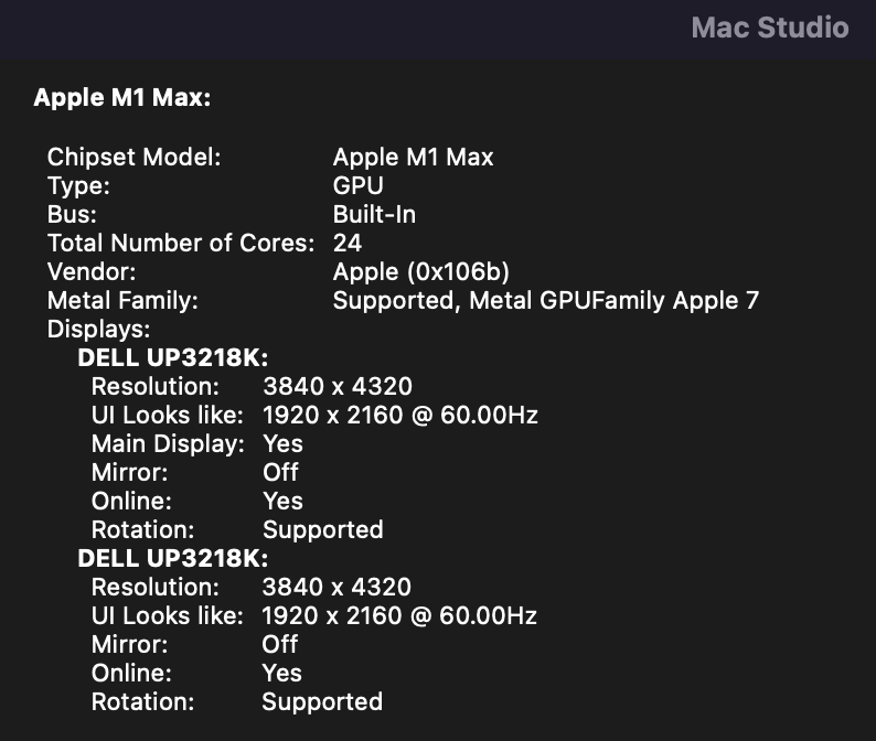

I have it working but it’s recognized as two separate monitors (3840x4320 side-by-side) on the latest macOS 12.4.@Pressure gave it a go on his Mac Studio but no luck last I heard.
That gives me 1920x2160 HiDPI on both connections.

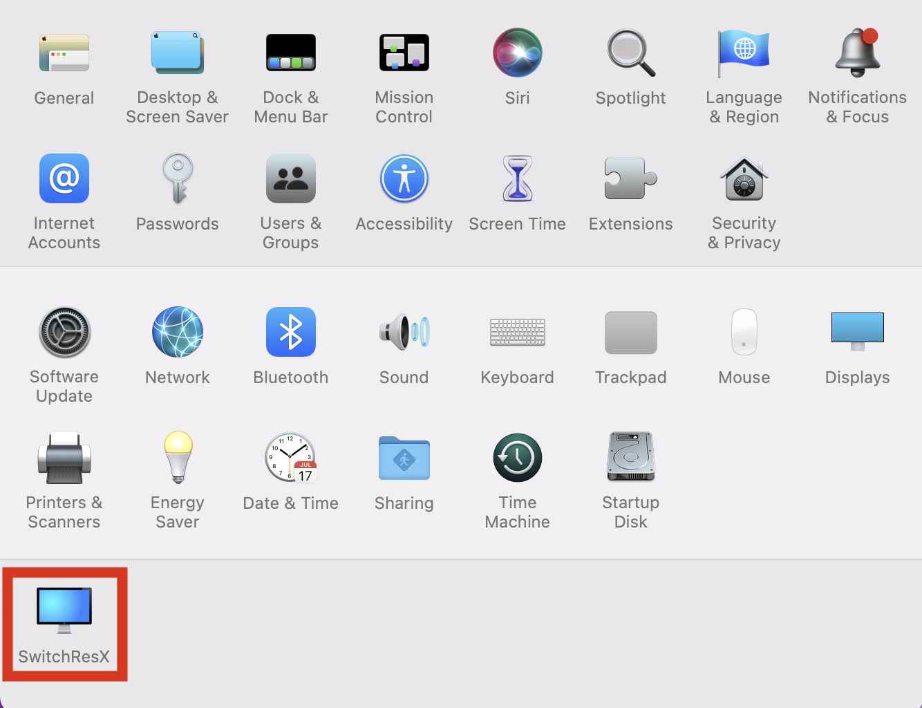

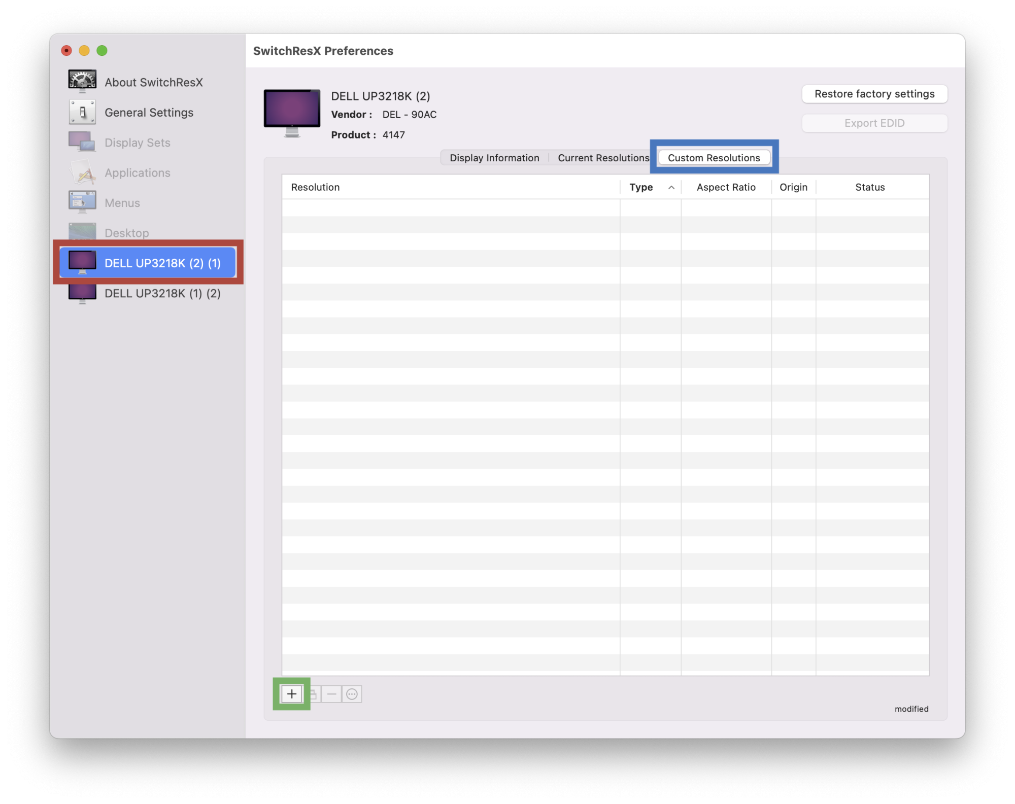

Do you have SwitchResX and/or are you familiar with Terminal commands?I have a 2019 Mac Pro with the Radeon Pro 580X. I have a Dell UP3218K as well as 2 Cable Matters USB-C to DP the latest version 8k. Running Monterey latest update. The computer sees the monitor as 2 separate monitors 4K. Is it possible to get this monitor working 8K60 with this configuration? I saw a post about Overrides ? Can somebody explain to me exactly what I need to do to make this work. I sincerely appreciate it.
Bass
If not you can always install the public beta of Ventura. That should enable 8K60 for you.
Sure thing, have in mind though that full support for the Dell UP3218K seems to be coming in macOS Ventura.I do not have SwitchResX and I never used the Terminal on Mac, I am a Windows guy by trade .net developer but I also use Mac Pro for ProTools rig for our studio, its very sensitive to os versions and would like to stick to Monterey because of drivers ect with Avid Hardware. I am really great with instructions, would you be willing to list for me the steps I need to take to get it to work with Monterey? I would greatly appreciate it.
Bass
Could you give an example of that?And FYI for folks lining up your two halves of the screen with SwitchResX, be aware you can use AppleScript with SRX to get, and set the position coordinates of the displays to the precise pixel, which the monitors prefpane doesn’t allow.
